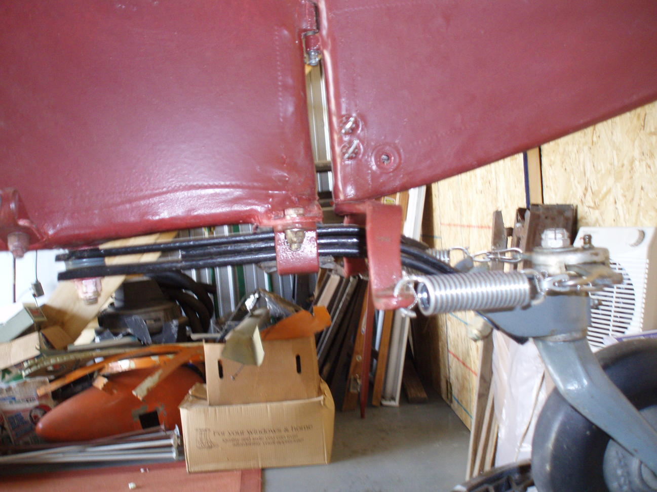

                      Not to hijack this thread but if i have a bouncy landing, my left tailwheel spring pops off from where it attaches to the rudder which means no tailwheel steering. i have closed the loop so it can't pop off but the loop opens enough after a bounce that it can then pop off again.
                      does anyone know the specs for the tailwheel rudder horn springs?
                          My two springs don't look like these in Jim K's photo. these are not as substantial and do not have the center straight parts, just the coiled exterior. I have a 1940 BC-65. Will take pics and post.
                          Does anyone else have a problem with springs popping off after a bounced landing?
                          Thanks.
                            I would recommend installing the better springs and mouse safety wire them.
                            Rob, maybe you can post the link to your "Top Ten", I couldn't see the link to your presentation on your web-page. I can post a copy with your permission.
                              You need to Mouse the springs. The safety wires keep teh spring from popping off. Also reduce heart attacks from ground loops! Click image for larger version
