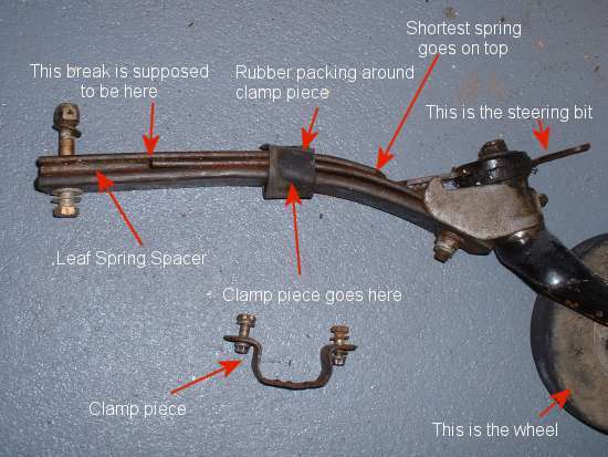

          Tim, I have a close up picture of the spring I would like for you to look at but not sure how to send a picture. Maybe you can tell me. It has the spacer but two leaves bolt to the tailwheel. Thanks for your help. Jim

              Maybe a picture will help. Most of the set ups I have seen have a larger gap behind the spacer in the middle leaf at the forward bolt. Photo credit goes to Rob Lees.

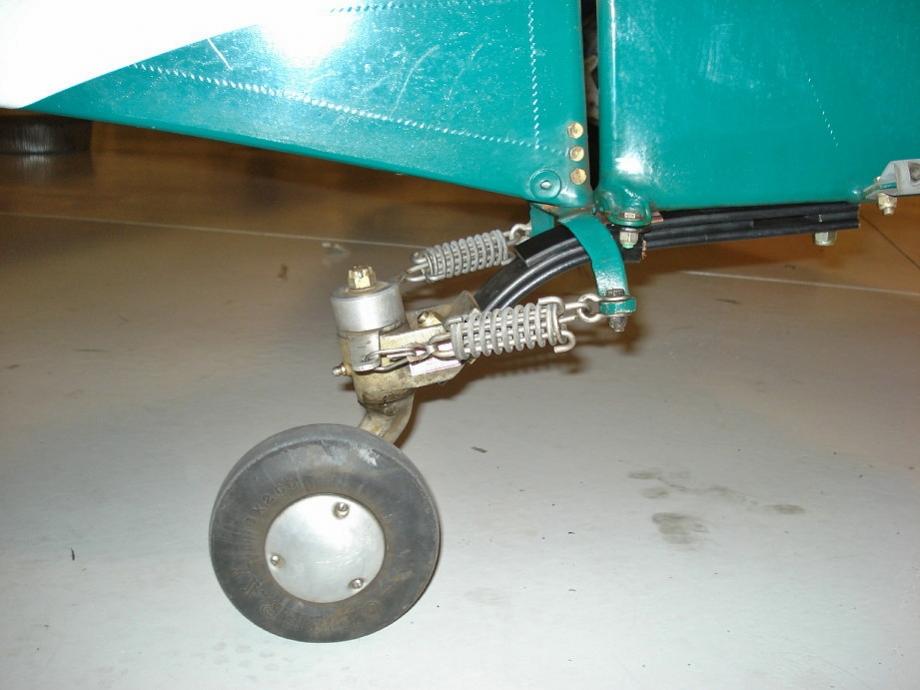

                Here is picture of my tailwheel. Springs looks same as in your picture but gap behind my spacer is about two inches and caster angle is toward rear.

                  I like the shackles on the steering arms. If you hook the ends of the tension springs like they did originally the springs wear groves in the steering arms.

                    Hank, what do you think of the angle of the shaft being shifted towards the rear from vertical?
                    Plane seems to handle ok with no shimmy.

                      Hard to see which way your tail wheel is angled from your description. What you do NOT want is negative castor. Positive castor is when the pivot shaft that the tail wheel steers around is angled FORWARD at the bottom and aft at the top. The line of the wheel steering axis should lean AFT at the top.
                      Even with negative castor you may not get shimmy if the pivot is stiff and the springs are tight with no play in the parts of the tail wheel, but it should be set up with positive castor so it doesn't start to shimmy when wear starts.

                        Jim, your set up looks good. In my opinion there is not a better non-pneumatic tail wheel than what you have right there. Tom
