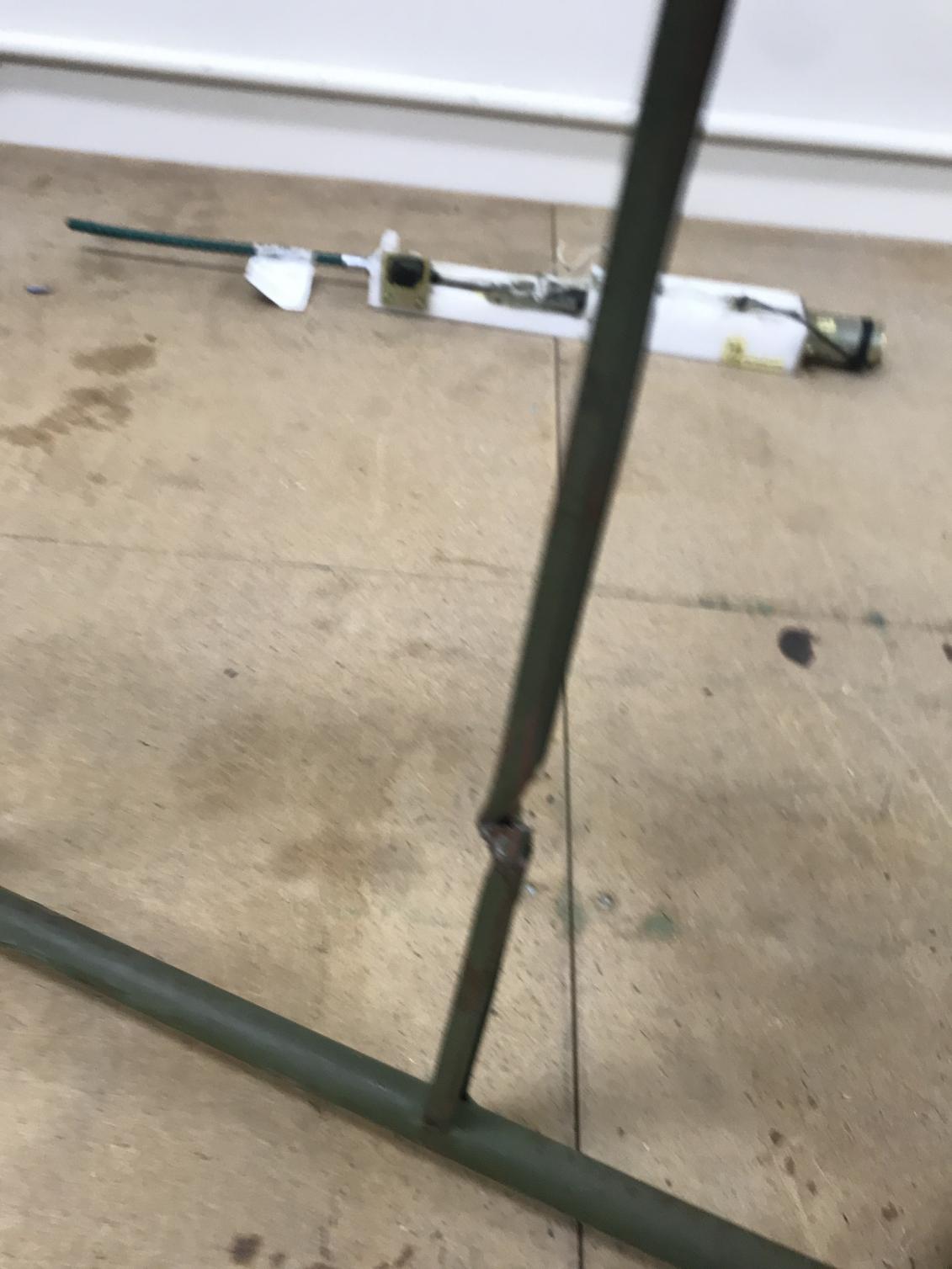

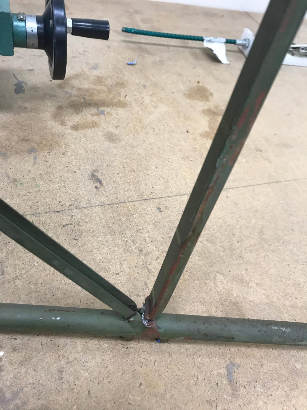

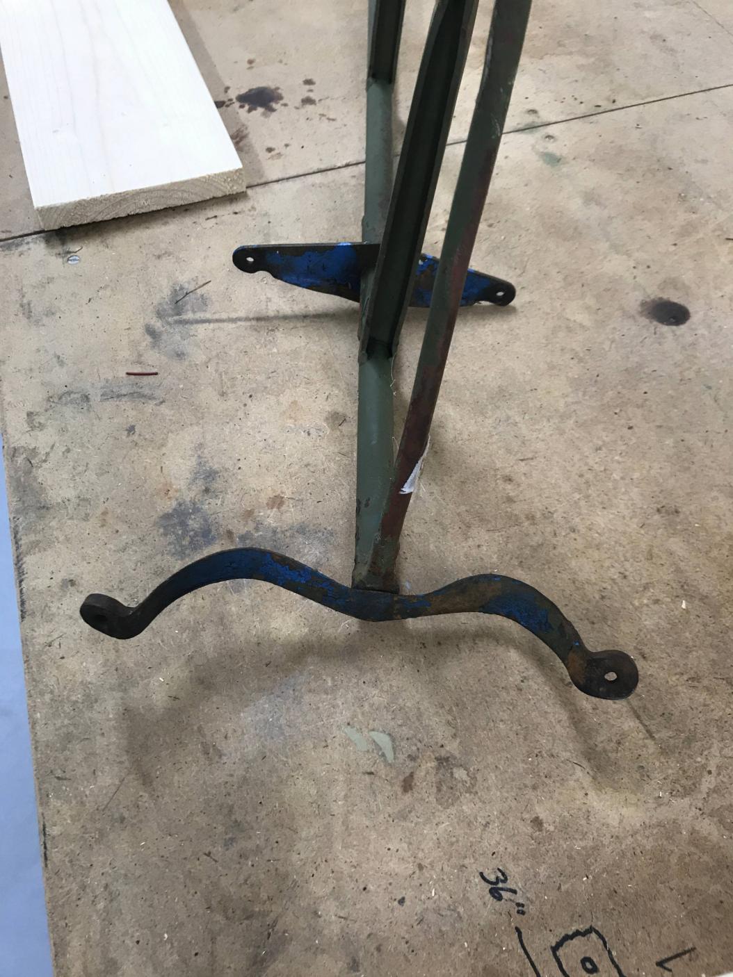

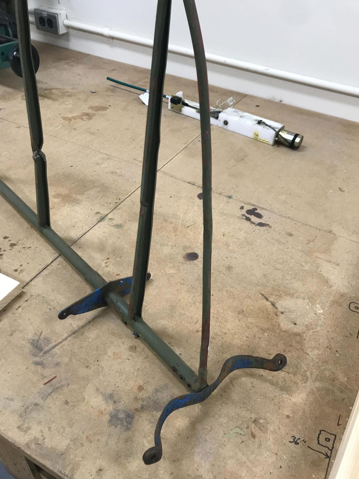

                    I removed the rudder. As you can see it is pretty mangled up so I will need to:
                    1) rebuild it and put fabric on it or
                    2) rebuild it and put a thin metal cover on it if I can get and tx (I know of a Cessna 140 owner who has metallic wings so maybe?)
                    3) buy a new rudder somewhere
                    any ideas and is there anyone with the know how for #1 or #2?

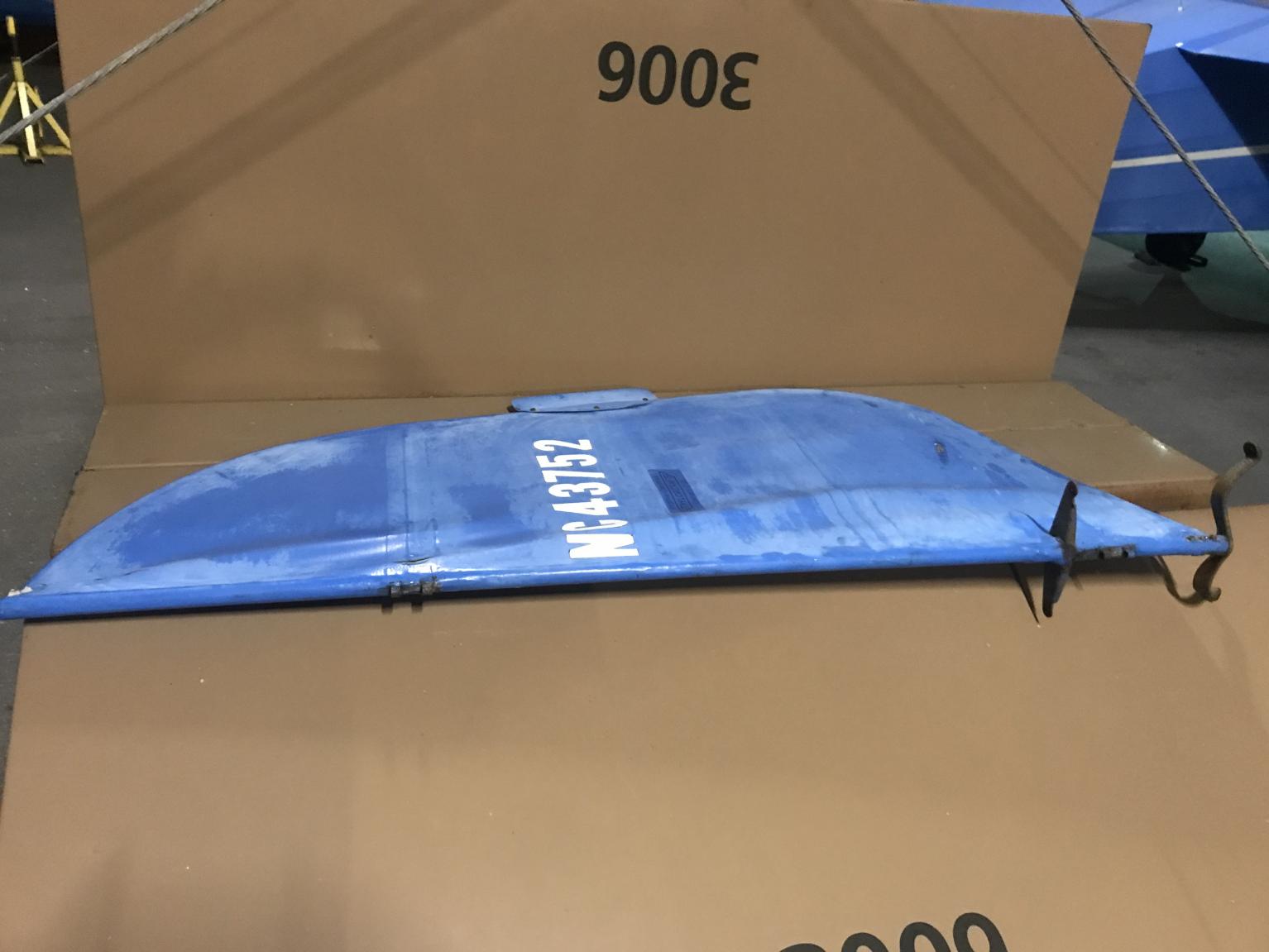

                      Finding a used rudder to cover, or even one already covered shouldn't be a problem. Tail surfaces seem to be one of those items that tend to survive when the rest of the airplane is damaged. I would not even consider covering with metal.
                        Have to agree here. When you modify a control surface a WHOLE LOT of problems crop up with the FAA. You WILL need to know which rudder you need and which one you are looking at as a replacement. The easiest way to tell is to make sure the hinge line tube is the same as your damaged rudder. Pre war rudders were shorter with a larger chord while the post war rudders were taller. They are NOT interchangeable!
                          Also, metal will weigh much more. The Taylorcraft as a breed suffers from the risk of aft CG issues at the best of times...adding a pound or two at the aft-most point will not help. Unless you lose the tailwheel & go for a skid!
                          To my knowledge, it's never been done before, so as others have said you'd be into STC and other legal issues. Go with option 1 or 3. 1 would be best (at least you'll know it will fit after repair!)
                            Have you removed the fabric from the rudder yet?
                            Not overly complicated to repair the rudder. Can be done on a flat bench. The trailing edge lower section is suseptible to corrosion as are the other "catch water" points.

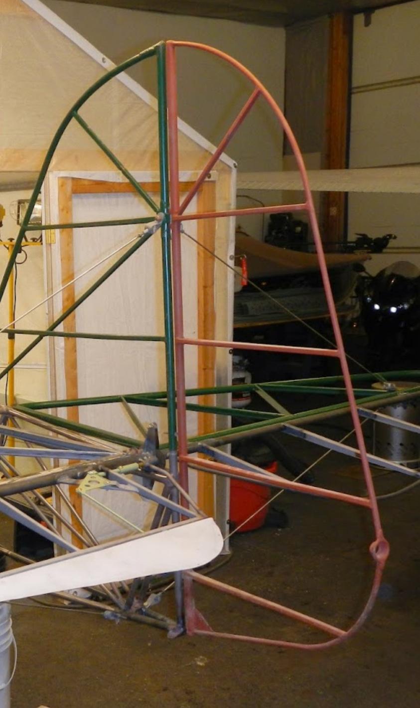

                              I am finally getting to repairing the rudder. Can anyone give me pointers on what tubes could be used. The picture above seems a decent replica and I have access to an EAA hangar with tools and welding equipment.
                                The channels are .020 steel.
                                The trailing edge tube is 3/8 X .028.
                                4130 works
