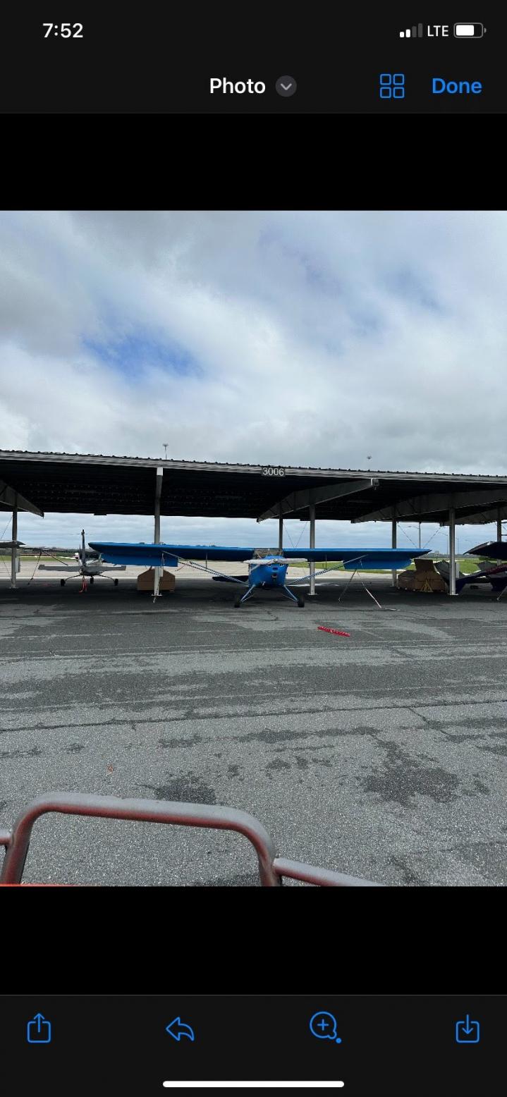

    I am going back to Tampa today to check on my planes... sadly my taylorcraft seems to have aileron damage. I have insurance but also an A&P mechanic. Lost my car on Davis Island and now this... seems all those black swan events are happening way too much. I travel a lot and in both cases couldn't come back in time nor had people willing to help me (ex-friends now) when I asked them to check on my vehicle and plane.
    Anyhow... any opinion as to what the damage may be from this?

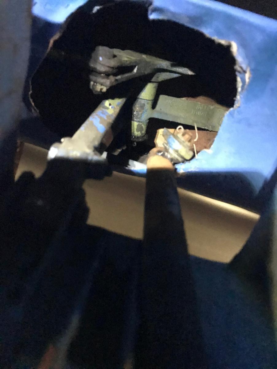

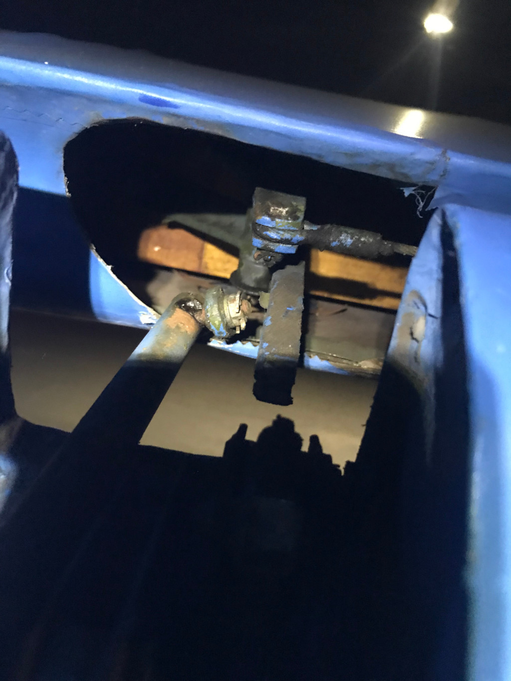

    If you are really lucky the cable between ailerons was already weak and snapped. Don't hold your breath. More likely the wind was banging the ailerons up and down and the hinge fitting failed (especially since you have a later post war plane with the cast ones). They are bad for getting corrosion under the steel end caps that can't be seen till the casting is badly corroded. If that happened you dodged a bullet. If the hinges fail in flight it is a bad day. Need to see more photos when you get the ailerons off. To get an aileron sag like that the center hinge would have failed but I would do a CAREFUL inspection of all three hinges on both sides with the steel caps OFF. You also want to check out all the pulleys for chipped edges and look for stretched cables. If you are going too pull cables be sure to pull a cord into the fuselage and wings with the removed cable so you can pull the cables back in again. TRUST ME! You DO NOT want to try and get any of the cables back in a covered plane with nothing to pull them in with!

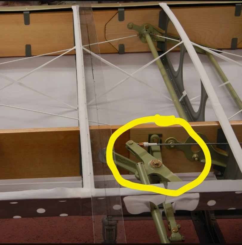

        Most likely single point of failure is the magnezium as Hank says. The belcrank is visable through the false spar/aileron cove.
          Hello everyone I was busy with the recovery. Well turns out the hinges as pictured above broke so technically very repairable... also will need a new rudder. Any ideas on these?
          Is is possible to replace them without removing some of the fabric?
          And yes maybe a blessing in disguise... definitely a BAD DAY if they break in flight. They both snapped for the ailerons so chances are if one would snap the other would do in flight.

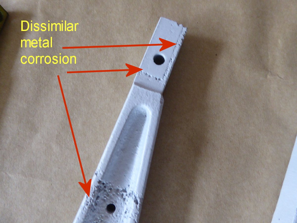

                    Originally posted by braol View Post
                    (Has anyone put in inspection rings and removed/inspected these parts for that corrosion?)
                    Yes, see attached photo. I replaced mine with new ones sourced from the then Factory owner, Harry, bless his cotton socks.
                      Is the corrosion from having a steel pin inside of a magnesium hinge? Or are those some kind of dissimilar metal insert on the end?
                        It's Magnesium. It corrodes if unprotected if you look at it. And sometimes even if you don't look at it. It was the miracle metal of its' time, but the miracle came with a curse.
                          I am always entertained by stories of how the 'latest-and-greatest' thing often ends-up being a problem. I own a classic Porsche 911 and back in the early-80's Porsche decided to use titanium cylinder studs to hold their aluminum cylinders onto their engine cases. It turned-out that the coefficient of expansion of titanium vs. aluminum is VERY different and the bases of the cylinder of the Porsche 911 SC series of cars started cracking and had to be replaced by the manufacturer in a recall campaign. Such is progress I guess.
                            Magnesium alloys have come a long way, but the early versions are suseptible to pretty much all types of corrosion.
                            To me the greatest risk is that corrosion happily occurs under protective coatings without showing at the surface.
                            one key factor is preparation. Chromate primers actually promote corrosion of magnesium alloys so non-etching primers are the only option. But similar to aluminium alloys, primer/paint does not adhere well without some sort of conversion process applied to the surface.
                            The proper conversion coating for Magnesium contains hexavalent chromium and is no longer available. In 2014 when I was restoring CF-CLR I found a plating company in NY that sold wipes soaked in mag conversion chemical but they too are no longer available.
                            There are prepcoats available that claim to provide a paintable surface but it's not a true mag conversion coating.
                            Frankly, if you can't find or make steel brackets, I'd be inclined to clean an airworthy mag version using the prepcoat, but instead of paint maybe coat them with a non-curing corrosion grease like True Turn. Very sticky, transparent, yet still has capillary action capabilities, and is proven even in saltwater environments.
                            This would at the very least, enable on-going visual monitoring for corrosion.
