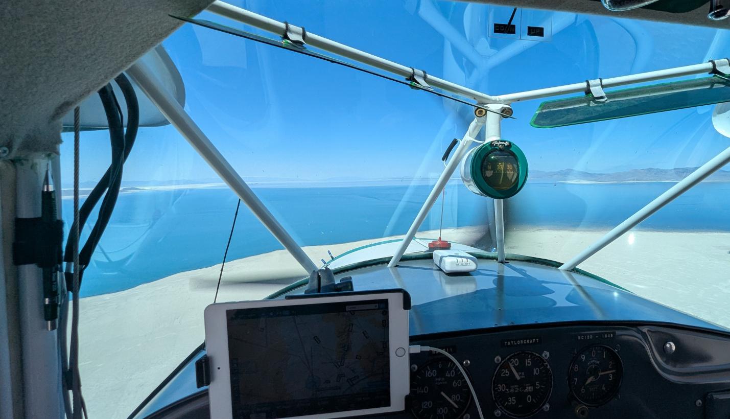

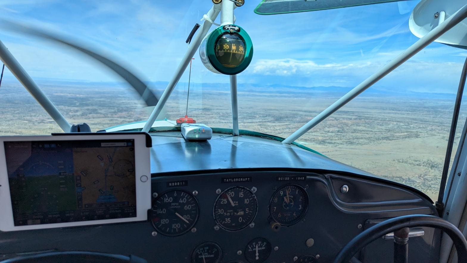

        For avionics, use your Ipad mini and Foreflight, get a Stratus2 or 3 or a Stratus Sentry. Mount with velcro on the dash. Get a double ball Ram Mount and suction cup and mount the Ipad mini on the dash in front of the control wheel to the left of the ASI. That gives you ADSB in plus AHARS. If you don't want to pay for Foreflight use Stratus InSight, 1/2 the price https://stratusinsight.app/
        Unless you are flying into Class B or C you do not need to waste the huge amount of money on certificed avionics and the certification on the aircraft output as well. Plus you will be so low most of the time there will be NO radar contact.

        Good luck and let us know how it goes. Some interesting panel pics to show the mini and stratus.

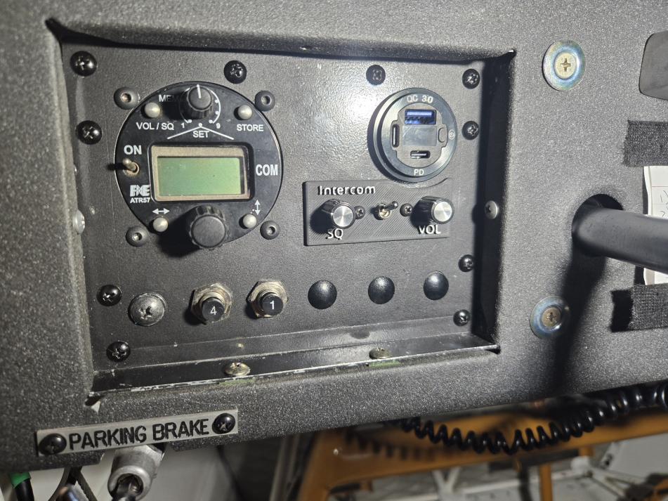

          I run a battery and recharge it between flights. It powers a stratus, sigtronics intercom, a Filser ATR-57 radio mounted in the pilot glove box, and a tablet. I also have a usb port to charge a phone if needed. I carry a Garmin in reach.
          I have LED lights installed.but not yet wired. I don't intend on flying at night but sometimes time gets away from you. I do want the landing light for visibility in the pattern.
