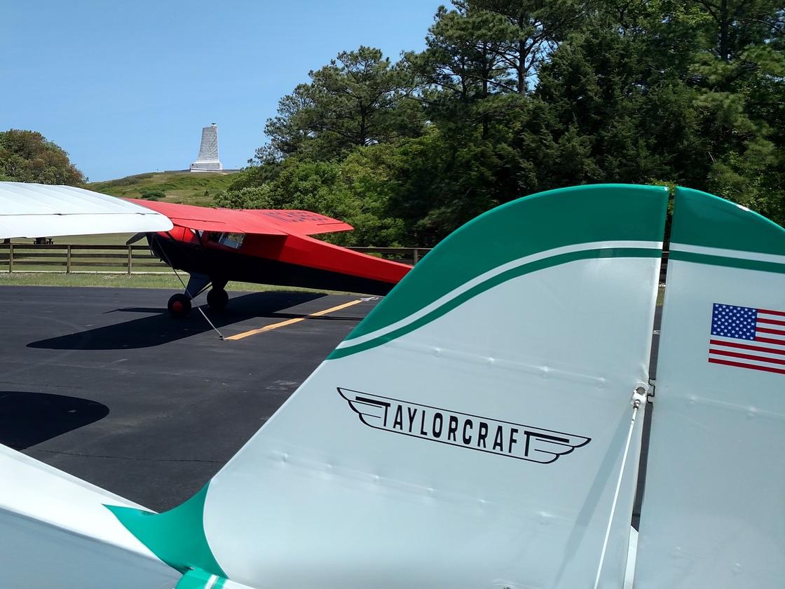

ID:	188302 This is what a two rib vertical will look like with the lower rib stitched. It was done in 1999 whether factory correct or not on Ceconite. It is a July built 1945 with the two vertical ribs in alignment with the two hinge rudder ribs. As Rob indicates and seeing Scott's at Oshkosh stitching the top only looks better.
                          There may be an in-between solution as well.

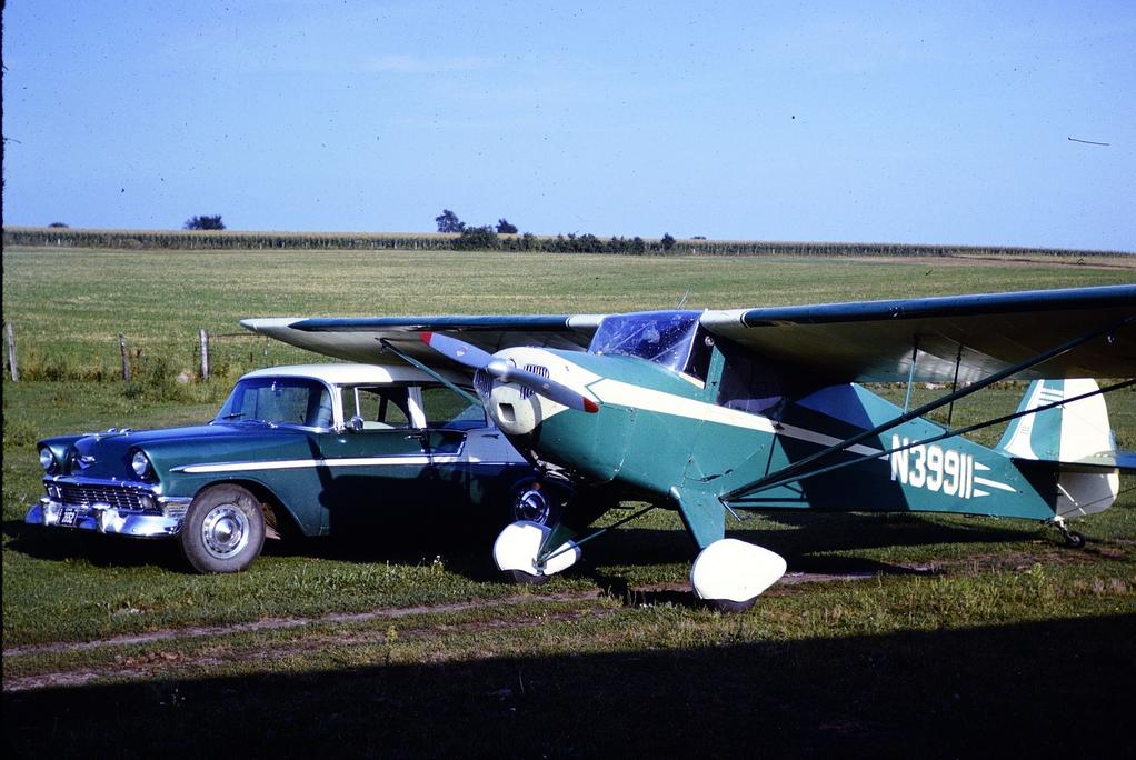

                          These photos are from 1963 in Irish Linen
                          It appears from the slides that the aft half of the lower vertical rib may have been stitched. There is stitch tape evident. However from the smooth curve of the paint stripe going up the vertical it appears to be way to smooth to have the front 1/2 half of the rib stitched as there are no puckers. Zoom in and you can see it.
                          Of course the answer with respect to the actual "need to" stitch could be quite different between the use of linen vs. polyester.
                          I would suggest that given Taylorcrafts efforts at removing rib stitching in the wings of the '46's that they looked at all areas to remove stitching like they removed the rib in the vertical. Less stitching = less cost in pre vs. post war. And better appearance.
