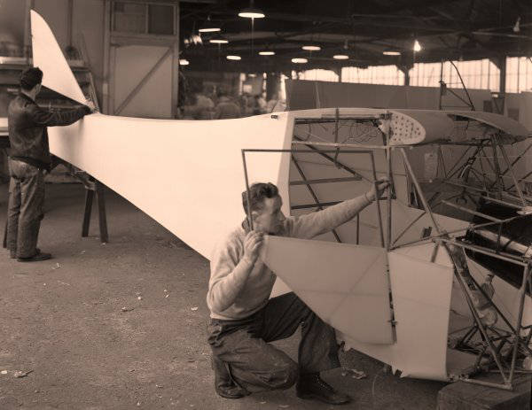

          I found this picture of the A model assembly interesting. Notice the fully covered vertical fin being installed. Click image for larger version
