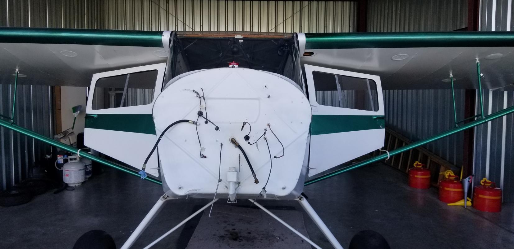

    I'm diving full in on the C-85 upgrade. I pulled the a65 motor today along with exhaust and engine mount. New motor should be here by the end of the month. I'd love input from others that have been through the process in general or as to what else should I consider doing while I have the plane down and access. I am planning to repaint the firewall and will clean up and paint the motor mount. Mags, carb, harness, and prop are all either new or overhauled so not much to do there. Thanks for the input in advance. The picture is of the plane as it sits today since pulling the engine. I can include more pictures/info as I go if people are interested in the progress.

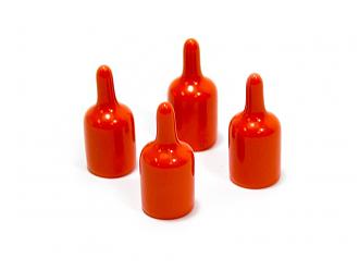

                            This is sorta' going beyond normal needs but I've installed these caps on large fuel tank vents exposed to the elements on a few planes. Cut the end of the tip off the cap so the tank can breathe while parked through a small hole and later remove before flight for full air vent flow. It'll keep out snow, rain, and most insects.
