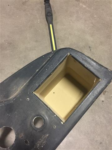

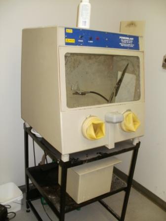

    The next step is to clean all the filler material off of the part. Most of is is just scraped off with a putty knife.
    Then we put it in the waterjet cabinet to do a really good job of cleaning off the filler material.

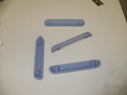

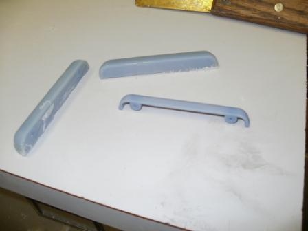

                          That would be great. I can make a drawing for anyone else who may come across an Airboy and want to put it in. I also have a buck for the pre and post war glove box doors if needed. I made my new ones from aluminum instead of steel (MUCH easier to form and if you need the strength of a steel door maybe you should restore railroad locomotives not airplanes!) Anybody remember who I gave the bar type box door handle mold to? I need to cast a couple more. I used the wrong resin and they got brittle.
                          It's my understanding that the glove box handle is the same one that was used on the dash cigarette tray on a '40 chevrolet. Can be ordered from WWW.chevsofthe40s.com part # 604622
