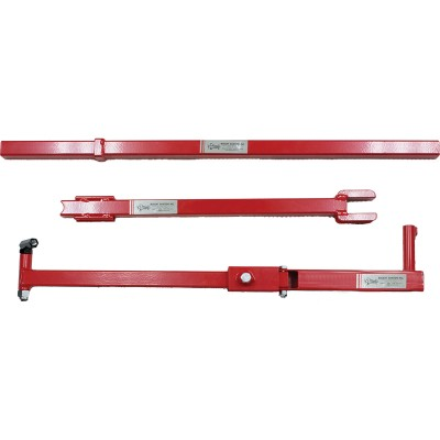

          These are the two bungee cord tools that Aircraft Spruce sells. The first one ("bungee cord removal tool") sells or $217
          The second one ("replacement bungee cord tool 'forked bar'", not shown) is $88.
          Anyone use these? Which one is best? (Let me guess...)
          (A forked bar is included in the first so second = a replacement..) image.png ​​
          Bill Fife
            Correct me if I’m wrong, those tools have no resemblance to the Taylorcraft tool. You should be able to see the correct tool by searching bunge cord tool.
