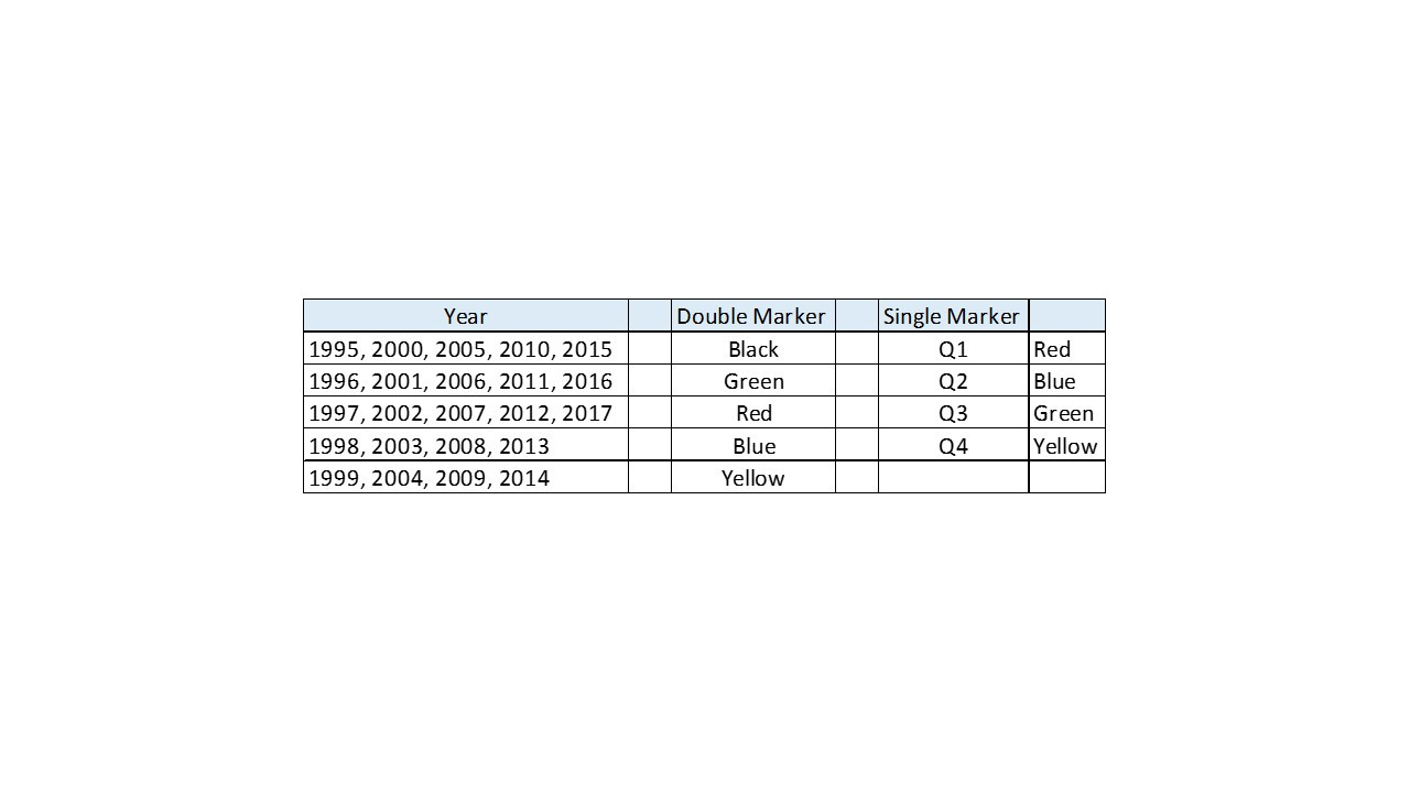

        My coding chart for the date code

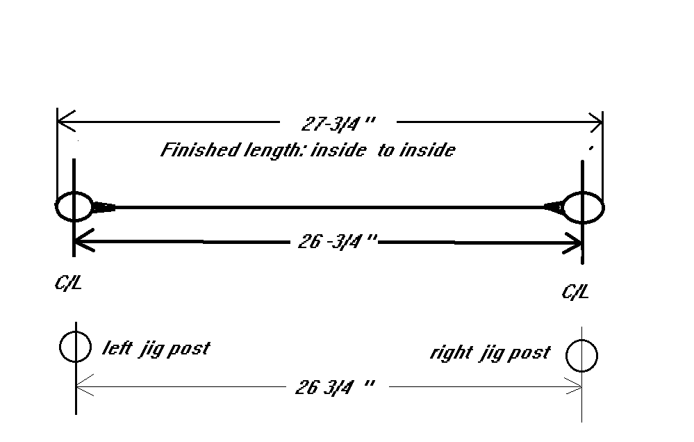

        And a safety cable dimension. I don't have the history on this drawing.

        • #34
          The safety cable drawing is probably for post war, pre war will be a little shorter.
