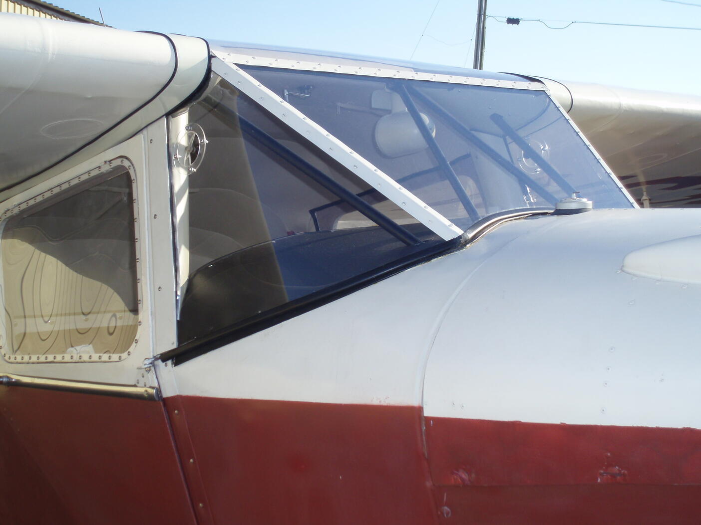

ID:	194180 When I put the 4 piece flat windshield and windscreens in the 41 I put small pieces of Silicone tube in each screw hole. That was LOT of 1/8" long pieces of tube!!!
