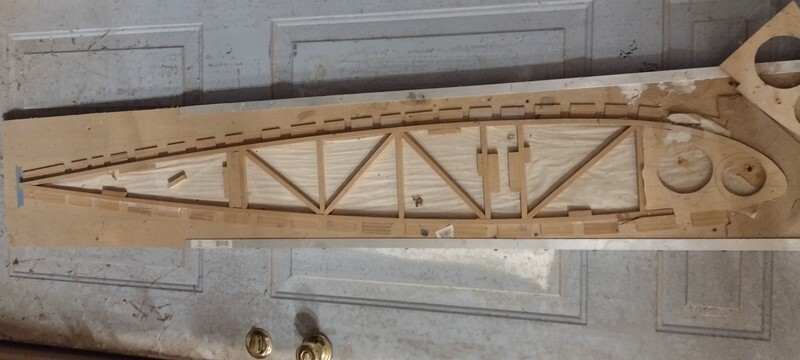

                      The airfoil is the same. You can build a jig and crank out a bunch of ribs pretty quickly. The jig can be quite simple. Here's one I built using the Taylorcraft airfoil, for a home built project. Click image for larger version
Name:	IMG_20220820_221253051 (Copy).jpg
                      Thanx,
                      Shorty
