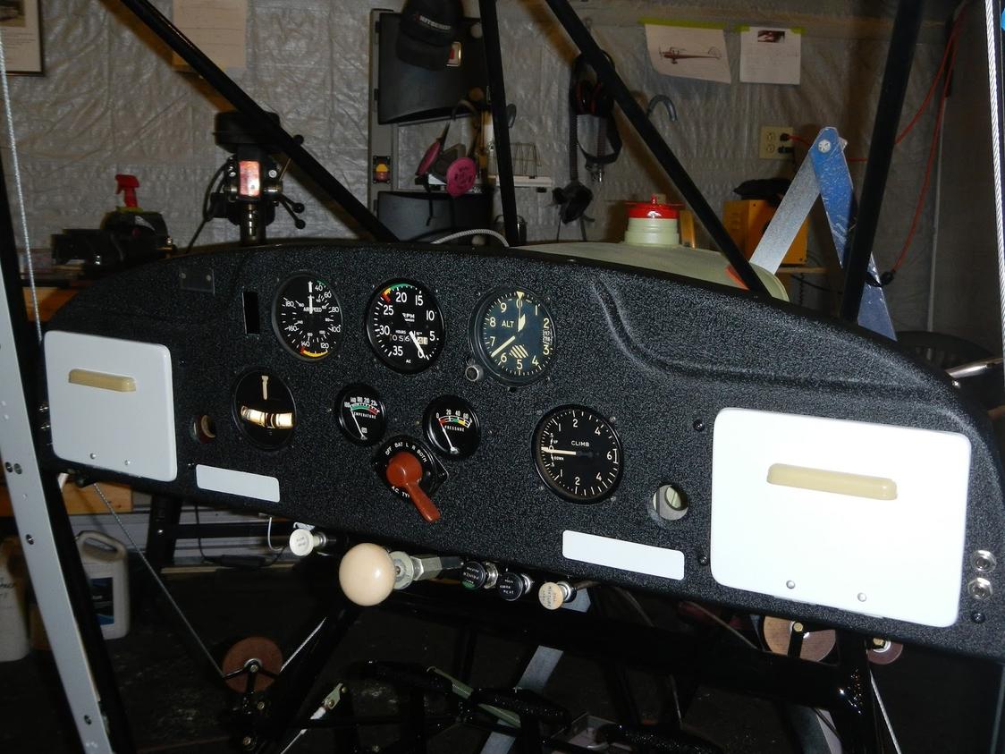

            Today’s question, can an instrument panel be powder coated with a black “crinkle coat” finish without warping the panel?
            Jon
            "Captain Jon" Timlin
              Originally posted by CaptainJon View Post
              Thanks Tim and Hank! I’ll have to feel it out as I progress..... Don’t know if I have the time to devote FB to do something like Rob’s beautiful page, or like my old “Captain Jon’ s Taylorcraft Hangar” page, as you might remember Hank. It’s all good, and any enthusiasm or knowledge I can pass on, the better.......
              Thanks for the fuel valve offer Tim. I may take you up on that when I get to the fuel system.....
              Jon
              Yes it can, 250 is what they typically bake at.
                Thanks Tim,
                I assume they can do a crinkle finish perhaps? I will go there later in the week with some parts .............
                Jon

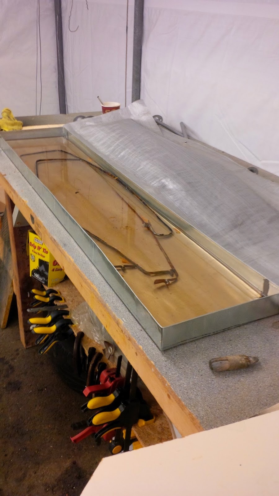

                          re cleaning parts.... I bought a long 8" HVAC pipe( cheep raw material), flattened it and bent sides and ends to form a long tray to soak ribs etc. Soak in varsol or laquer thinner overnight to loosen up chafe tape, dope, varnish etc. Line the same tray with poly and you can use it to etch and conversion coat

                          re crinkle finish... I'm never clear on the fascination with powder coat. It's not a good choice for aircraft parts primarily because it has little or no flexibility, so it cracks and then is impossible to repair. For the instrument panel I etched and alodined and applied epoxy primer. Then four coats of crinkle paint from a spray can from the local auto parts store. Easy effective and durable.

                              I'm absolutely against using electro-static powder-coating on any aircraft parts. It's thick, heavy and more importantly soft (so that if the substrate underneath cracks, the coating might not, so you can't see a cracked part). It also doesn't get into the very acute angles of a steel-tube fuselage, leaving these areas very susceptible to corrosion.
                              For my crinkle-finished instrument panel, I used an automotive rattle-can. You prime the panel, then have to pre-heat the part (to about 200F as I recall). Spray the stuff on, and the residual heat of the part causes the crinkles.

                                Thanks for the tips Scott and Rob. Very nice panels, both of you!
                                I have the rattle can of crinkle. Think I'll try it on something non-critical, like Tami's old panel, before I give her new panel a try........
                                I am only contemplating powder coating a few things that get a lot of wear like steps, control wheel, door handles, and rudder pedals. I understand your concern Rob, about not being able to see developing issues underneath the coating.
