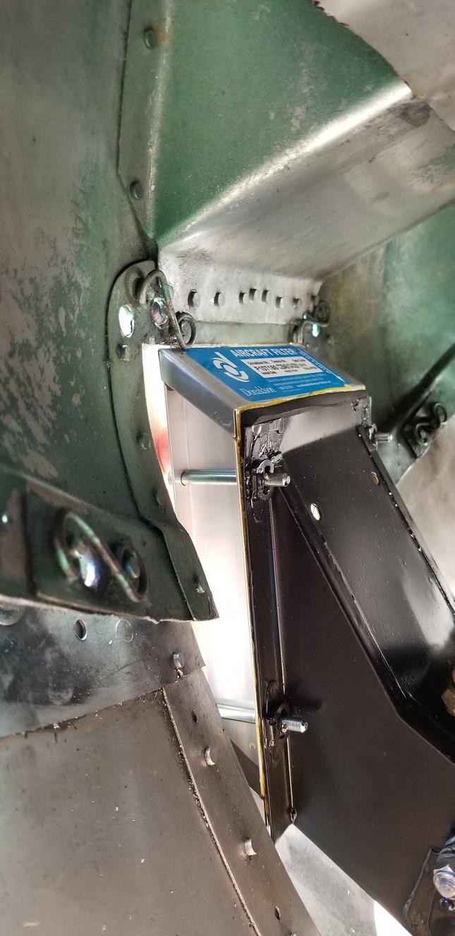

        Hi Stu. You may have mentioned earlier but what carburetor do you have? I suppose it's possible some are more prone to icing than others but I'm not an A&P or expert on carb ice versus carb models. Is your carb heat box flapper valve tight as possible for a good seal when cold or hot air is needed? Port Townsend WA - 0S9 is close to the ocean. I suspect your humidity on a normal day is higher than you may realize (https://aviationweather.gov/adds/taf...AFs+and+METARs)

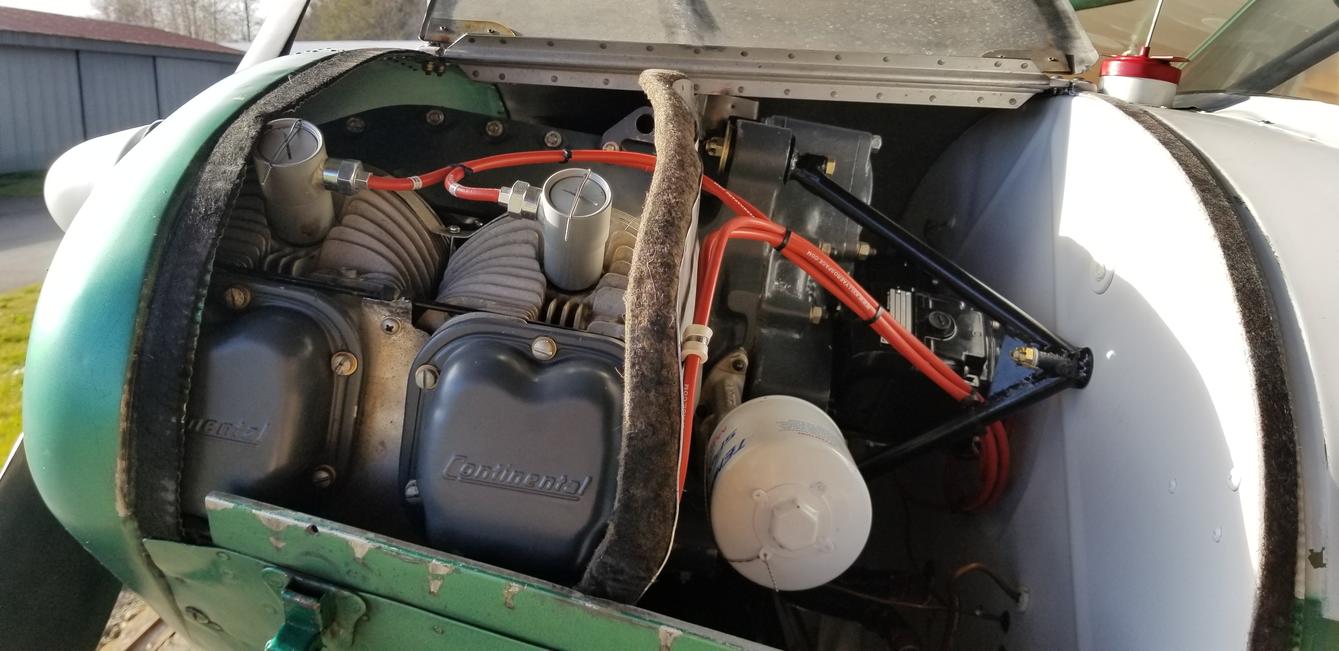

          Perhaps post some photos of your engine, cowling, baffling, air box etc.

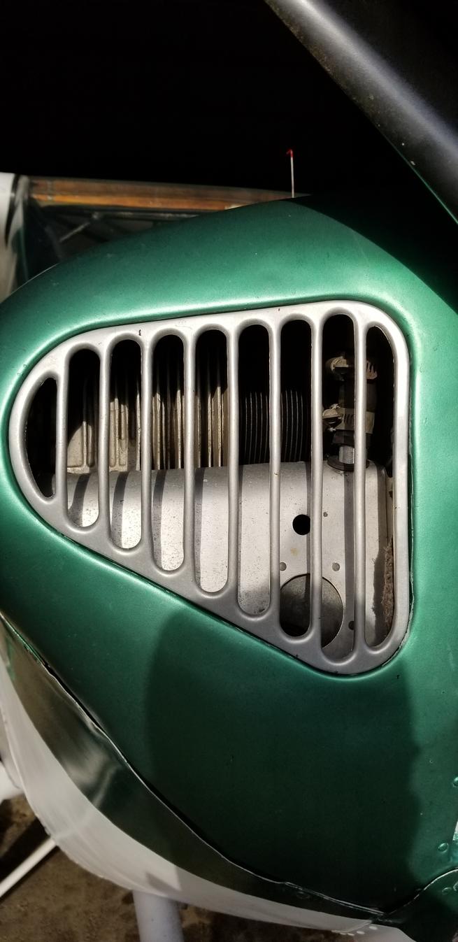

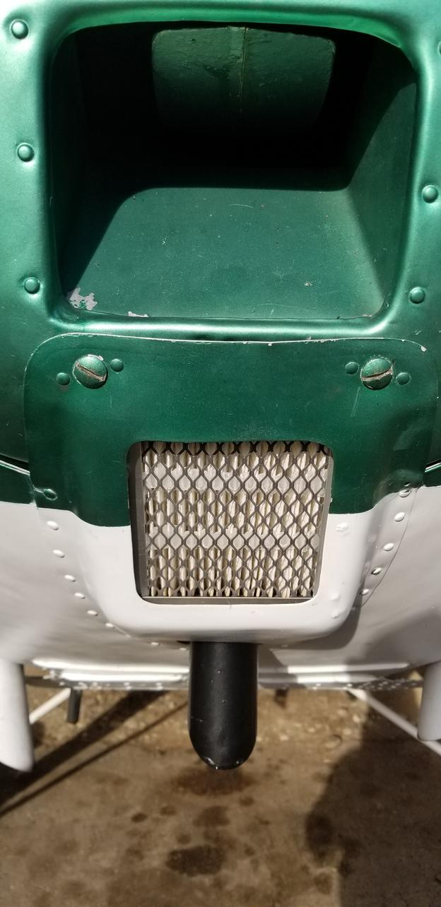

          Do you have the "chin scoop" open on the nose bowl? If so, how's your crankcase baffle configured?

                    Scott - I do think I have the chin scoop if that's where the air filter is. I'll take some photos.

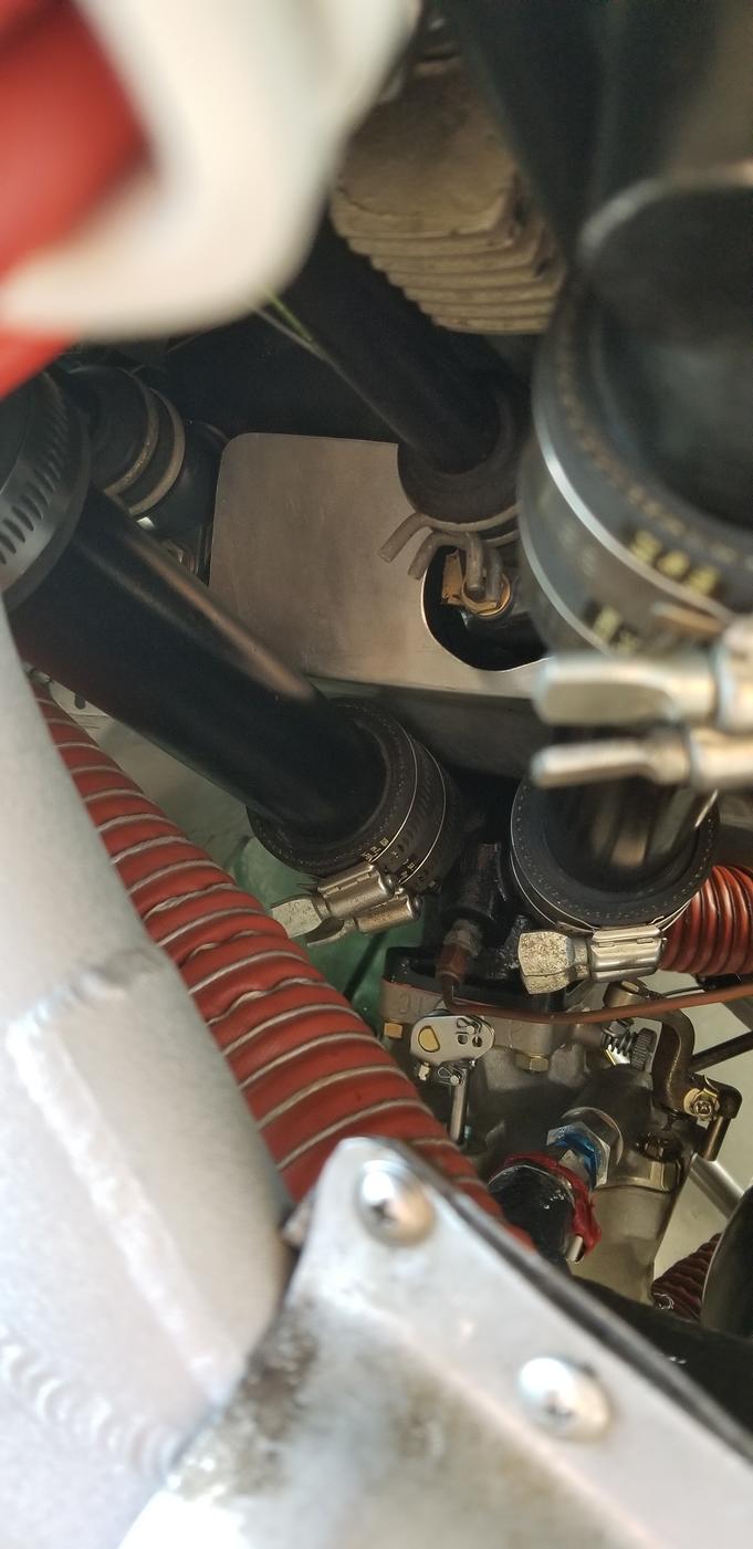

                        Kerbs, may I suggest you check your intake rubbers for leaks (I'm sure this has been mentioned before)

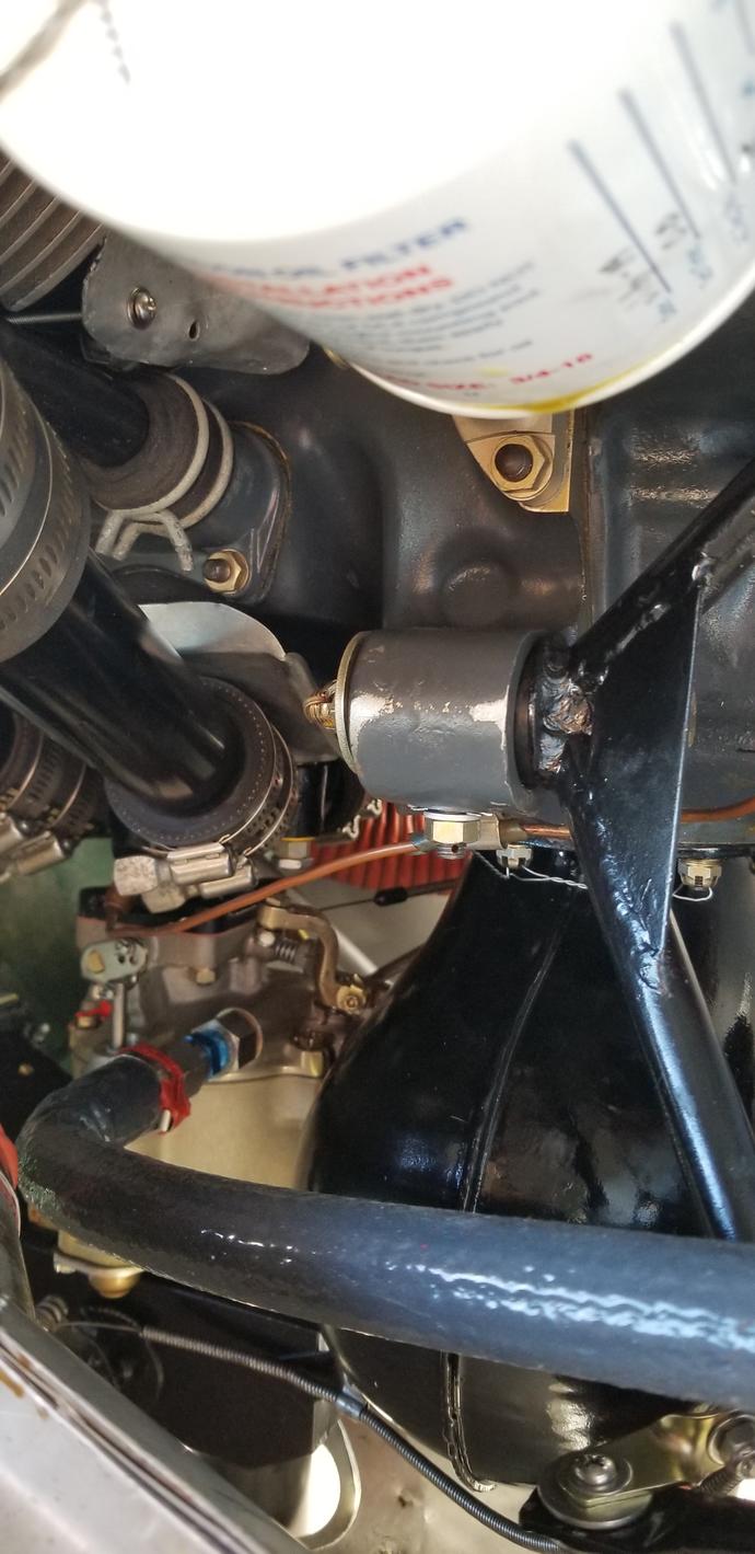

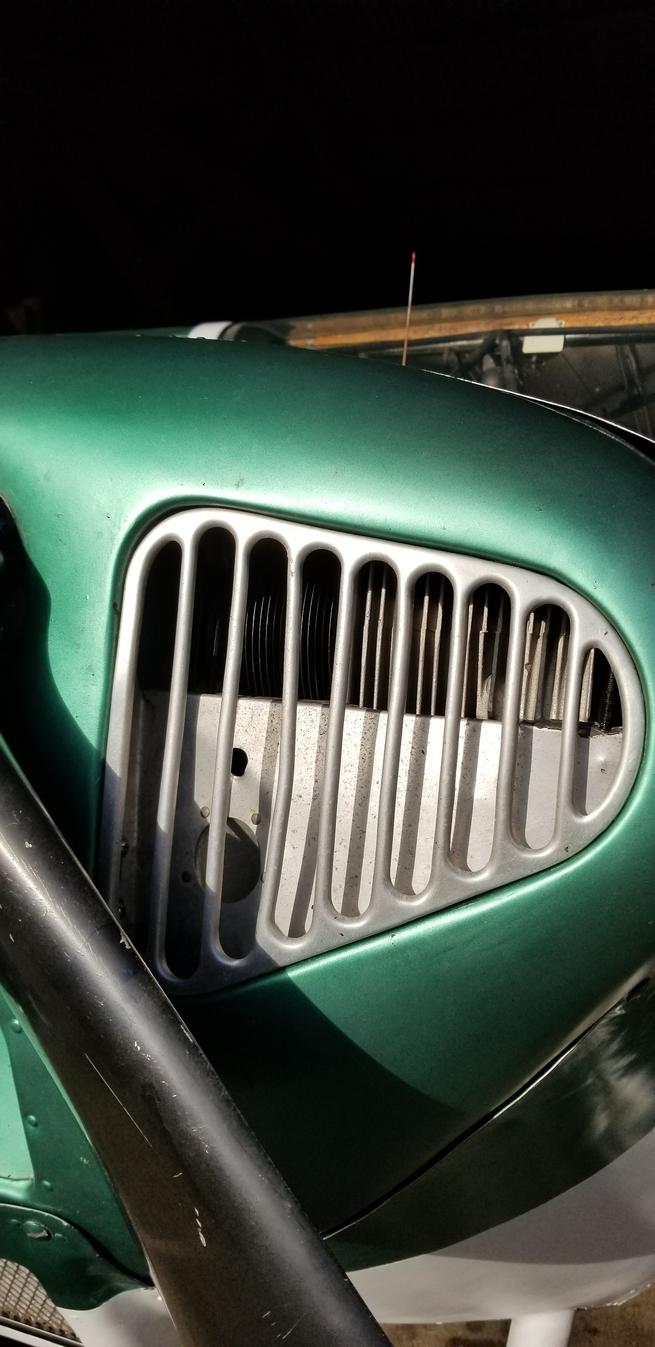

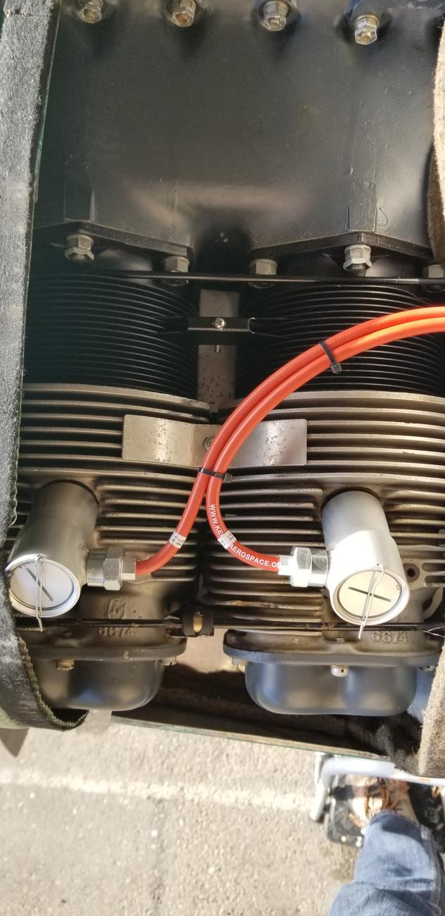

                          Attached are some pictures of my baffling, etc. I can get some more tomorrow when I am out there if there are specific things to look at. I did notice that there is no baffling from the cowl around the intake filter. I can see light from the inside and in one picture you can see my finger looking from the inside. I'm not sure if enough air would make it around to make a difference.

                          I attached some pictures i took of the baffling, etc. I am running 100LL from the FBO's commercial tank. I haven't talked to anyone else who is having issues with water in it and nothing is showing when I sump.
                          Robert - Not sure what you mean by intake rubbers? Do you mean around the filter because I got nada in that case.

                            Hi Stu. I wonder why you don't have baffling from the top of the cylinders/valve cover area that goes up to meet the top of the cowling. Wouldn't cooling air spill sideways and down around the valve covers instead mainly flowing down through the head and cylinder fins? Nothing to do with carb ice just an observation. Every plane I've owned or flown has had that cylinder head area sealed with baffling.
                            When you fly what happens when you lean the engine when it starts to run rough (you assume the roughness is from carb icing correct)? Does it get worse or better when leaned with the carb heat off? Robert's question pertains to the sealing rubbers for the induction tubes I assume. If there's carb ice causing the roughness onset it may improve with a leaner mixture as intake air flow is reduced by ice and there may be too much fuel for the air through the carb.
                            If there's a leak in the induction system (maybe around the rubber tubes or elsewhere) or not enough fuel for the air flow it will run lean and stumble...further leaning by the mixture control can make that even worse. If so (there's induction air leaks) then applying carb heat reduces the incoming air density which richens the air/fuel mixture and can make it run better. Is it possible you are running lean when it's rough and carb ice is secondary?
                            The front air leaks are minimal but some do seal around the air filter with rubber baffling.

                              Gary - First I don't know how I missed the area around the cylinders. I reused the baffling from my a65; it was never there to begin with and it had not occurred to me. I see exactly what you are pointing out and am guessing the air would go right over as well. I am going to enclose it as it should be. Thank you for pointing it out.
                              What you are explaining with the mixture makes sense. I understand what Robert is saying as well now, I had not considered a leak in the induction tubes. I will check everything when I am back out there tomorrow or sunday. I did have to drop the intake manifold to put the baffling so there is a possibility that I did not get one of the tubes sealed back up correctly.
