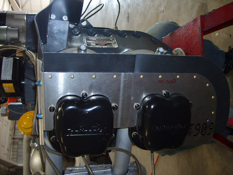

    Hey Stu I'm not trying to be critical about the baffling. Here's an example from a quick search of the Forum. There's more from others as well: https://vb.taylorcraft.org/forum/tay...gine-Baffling=
    You may be able to just go sideways with baffling and seal against the lower side cowl like Scott CF-CLR did: http://c-fclr.blogspot.com/p/taylorc...d-cowling.html Also see how Scott sealed around his air filter element and why.

      Regarding the possible lack of baffling to prevent cooling air from going down and out around the valve covers: I don't know what an original baffle set looks like on a side-by-side Taylorcraft, but on the L-2 the baffles out at the heads don't go up to meet the top cowling; they bend outward along the bottom edge of the valve covers and seal to the lower cowling. This accomplishes the same purpose. I can't tell from the photos whether this is the case on your airplane, Gary, but you may be OK with your baffles yet.

        Good note on the baffling options Dick...up or sideways. Mine go up but that's not necessarily the only option as my built up cowl fits a -12 with 4" longer motor mount. Most go up in my experience. Scott's cowl testing link above is a valuable read.

            Gary, if you look at the picture looking down through the 2 cylinders you can see the baffle extend out to the lower cowling. That is the way the stock baffle is for a B series with a closed cowl.
              The baffling was bugging me how I missed it, because looking at the picture you can't see it... unless you look really close. 3Dreaming is correct, it wraps down and then under. I went through my pictures and here is one showing how the baffling is set up. Gary, thanks for pointing it out though, it's always worth double checking this stuff and a lot of it is still new to me.

                Hey guys thanks for the correction...on Stu's what I thought was concrete visible below the engine valve covers is actually the aluminum side baffle with felt edging. Airforms https://vb.taylorcraft.org/filedata/fetch?id=156211 is another option like mine. My first Taylorcraft also had vertical baffles and a -4 mount setup.
