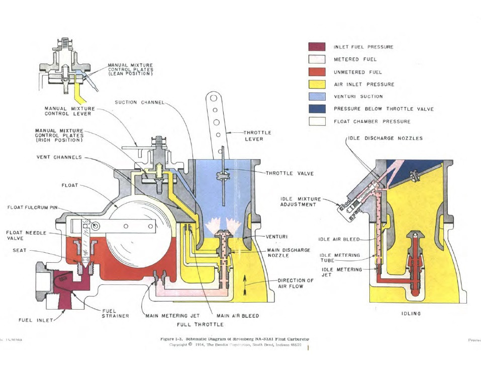

                I understand the assumption that the absence of an accelerator pump equals no enrichment as the throttle is advanced, but this is an assumption not a fact.
                Fuel injection systems have no throttle pumps but the mixture is enriched when you advance the throttle. This is achieved by sensing air pressure/mass at different points in the induction system.
                Believe it or not the Stromberg does the same thing. It uses ventury pressure verses ambient pressure to increase/decrease fuel from the main jet. At the point of throttle advancement the mixture is richer and as ventury pressure changes mixture gets leaner. Ventury pressure is also used to reduce the head pressure in the float chamber which causes a leaner mixture. The mixture control varies the amount of ventury pressure applied to the float chamber.
                All this to say that if the stromberg is the correct part number for the application, and it is properly set up and maintained, there are no issues.
                I flew my aircraft on skis at temps down to -25C (with a metal prop) and never had a dull moment! At that time the mixture control was wired full rich. Since I rebuilt it I use the mixture control just about every flight and other than the fact that a little extra patience is needed, it works just like any other mixture control (except no idle cut off).
                As I've learned more about the Stromberg, I've become more impressed with it's uncomplicated yet sophisticated design. Somebody did their homework 75 years ago!

                  Thanks Scott for absolute facts and challenging a 45 year personal and extended to others experience with the above theory. Without sarcasm intended respectfully I can now inform that Marvel carbs are not better in cold temps or otherwise. In Alaska Strombergs are replaced when able and where -25C is still warm. But seriously if you like them run them but I assume you're well insured. Few still do in colder climates and that includes millions of road vehicle owners without patience when needing response. This is one reason why Taylorcrafts as equipped are selling for less than value compared with others.
                  Come on up someday and we'll go ski flying in the cold. I'm open to actual new experience.
