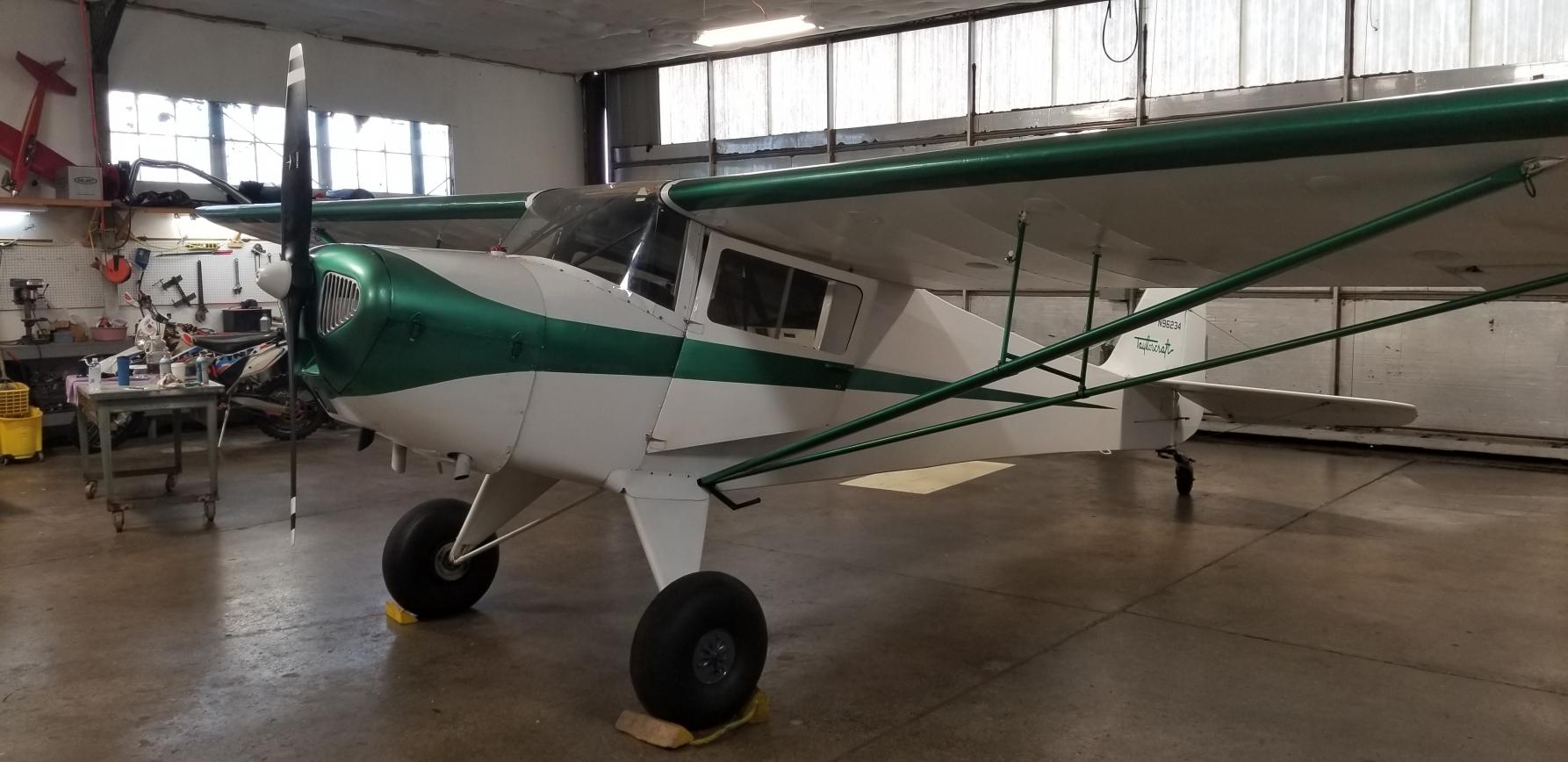

    Well it took three and a half months but N96234 is now re-powered with a zero time C85. Through the process everything firewall forward was replaced/rebuilt/overhauled. Ultimately I ended up with a C85-12 on a short mount, McCauley 1B90 7148, Luscombe 8E Exhaust, Marvel carb, Bendix mags, shielded ignition using cups, and a zero time tach. I did not add a starter or alternator as part of the upgrade as I wanted to stay non-electrical. While I was doing the work I also replaced my old Narco elt with a 406MHz unit. We fired it for the first time yesterday and it ran smooth as butter. I will hopefully get to ground running and test flights this week weather providing.

    good work, please post pics of the installation! Now how does it fly?
      I just completed the first test flight late this afternoon. It had been run in previously for 1.2 hours on the stand. I flew for another 0.6 and made a total of 4 landings. First off, it definitely gets off the ground a lot faster. The shielded ignition was a wonderful improvement, I cant believe I waited to do it. I was a little surprised with the 71-48 to only turn just above 2,100 static when we had it tied up. I originally wanted a 71-46 as i am looking for climb performance but found too good of a deal on this prop to pass it up. If I understand correctly I would only get another 60 rpm or by going down two inches. Level flight I could make just above 2,400 rpm. I am thinking I may benefit from a steeper pitch prop.
