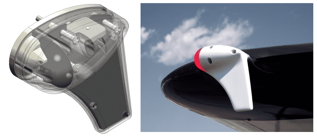

                        This is pretty innovative and as innovation goes maybe beats iLevil's BOM in terms of gadget coolness.
                        Mike if you are putting position lights on, check this out as it replaces the light.
                        AvWeb did a video of it. Wish they had more published tech details out on what is actually in the box, it is supposed to be available in 2018. Anyone talk to them at OSH (I didn't get to go and wanted to).
                        Nice thing about the small Trigs is that both will fit in the glove box volume and you still have some room left over.

                          Hi Mark-
                          Thanks for the heads up on the uAvionix ADSB out solution. You are right, it may even beat Levil's BOM for innovation.
                          I will definitely be watching this one. I am pretty sure we have wires in the wing, and can extend them to get position lights working too. That would be a plus. I can work on the Mode C transponder, and then add this uAvionix unit when it is released.

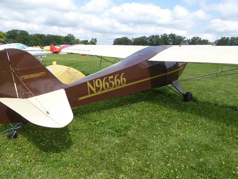

                              I did not get many photos but I saw about a half dozen Taylorcrafts , I arrived on Friday so Im sure there were more. I did see one brown BC12D1 85 built in 1948 it was quite nice and flew all the way from Oregon, I saw it Friday night went back to get a picture Saturday morning and it had already left. It was impressive.

                                I saw a brown Taylorcraft on the flightline too...but it was from Michigan, not Oregon
