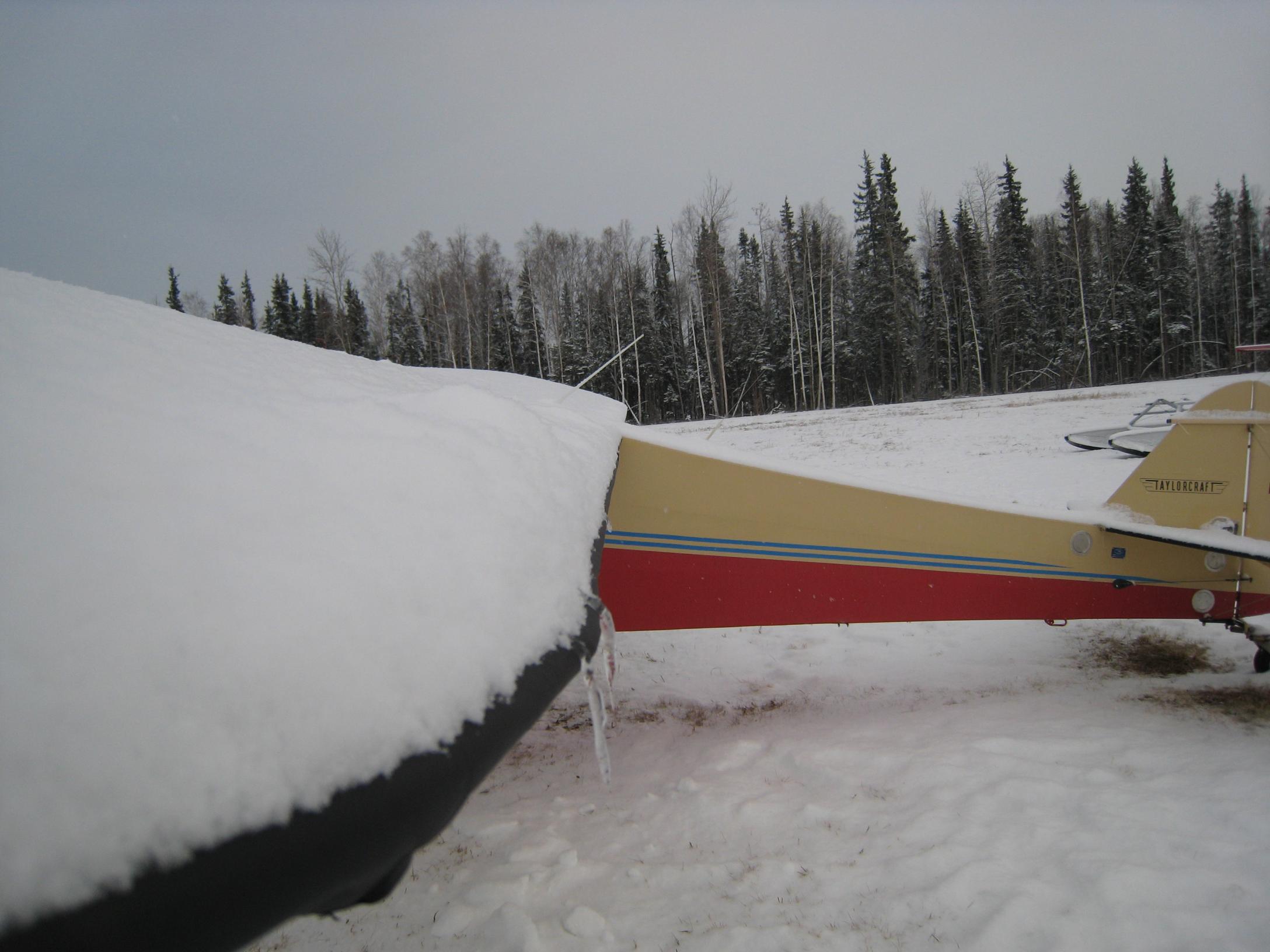

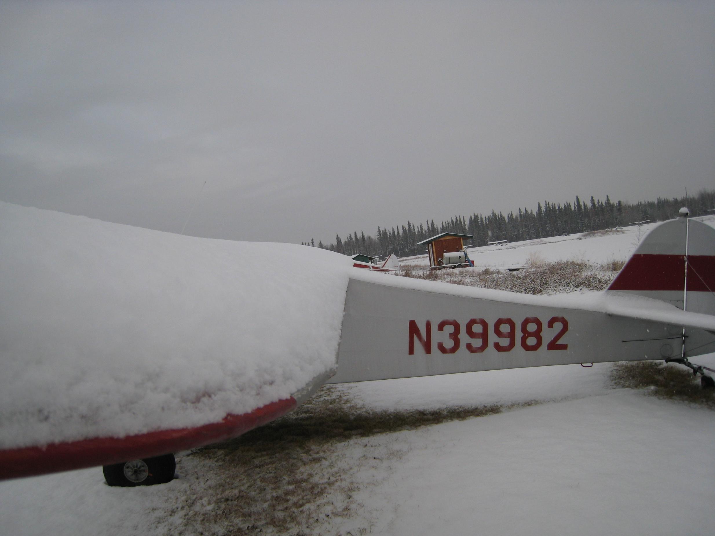

    Re: Strut angle conundrum
    Some more of today's pics. The trailing edge of two T's. Note the straight line across the fuselage tip to tip. The dog pic is for her fun in the snow.

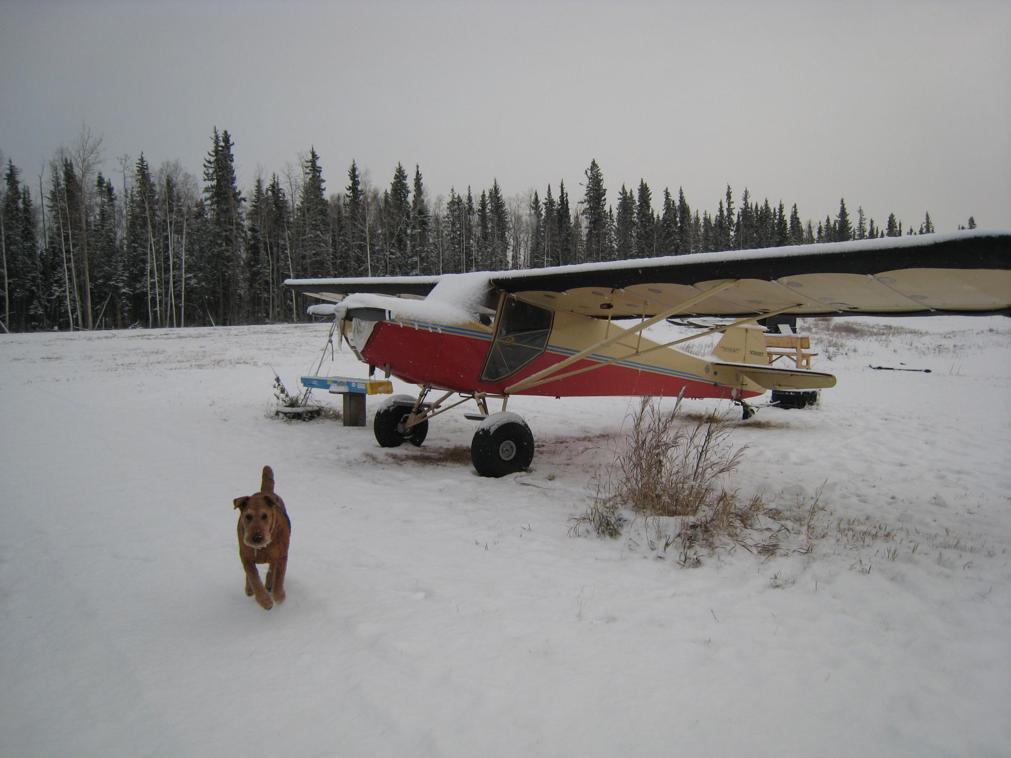

        I laughed out loud, and perhaps a small amount of coffee was spilled on the keyboard!
        • #49
          But how can you bear to leave a fabric aircraft parked outside? It is pretty much unheard of here in the UK (or even in Europe). We have hangars to keep rain, snow, hail and UV off fabric-covered aeroplanes. But you in the USA (particularly AK) have more acres of land than we do, so it must be cheap to have land for construction of hangars.

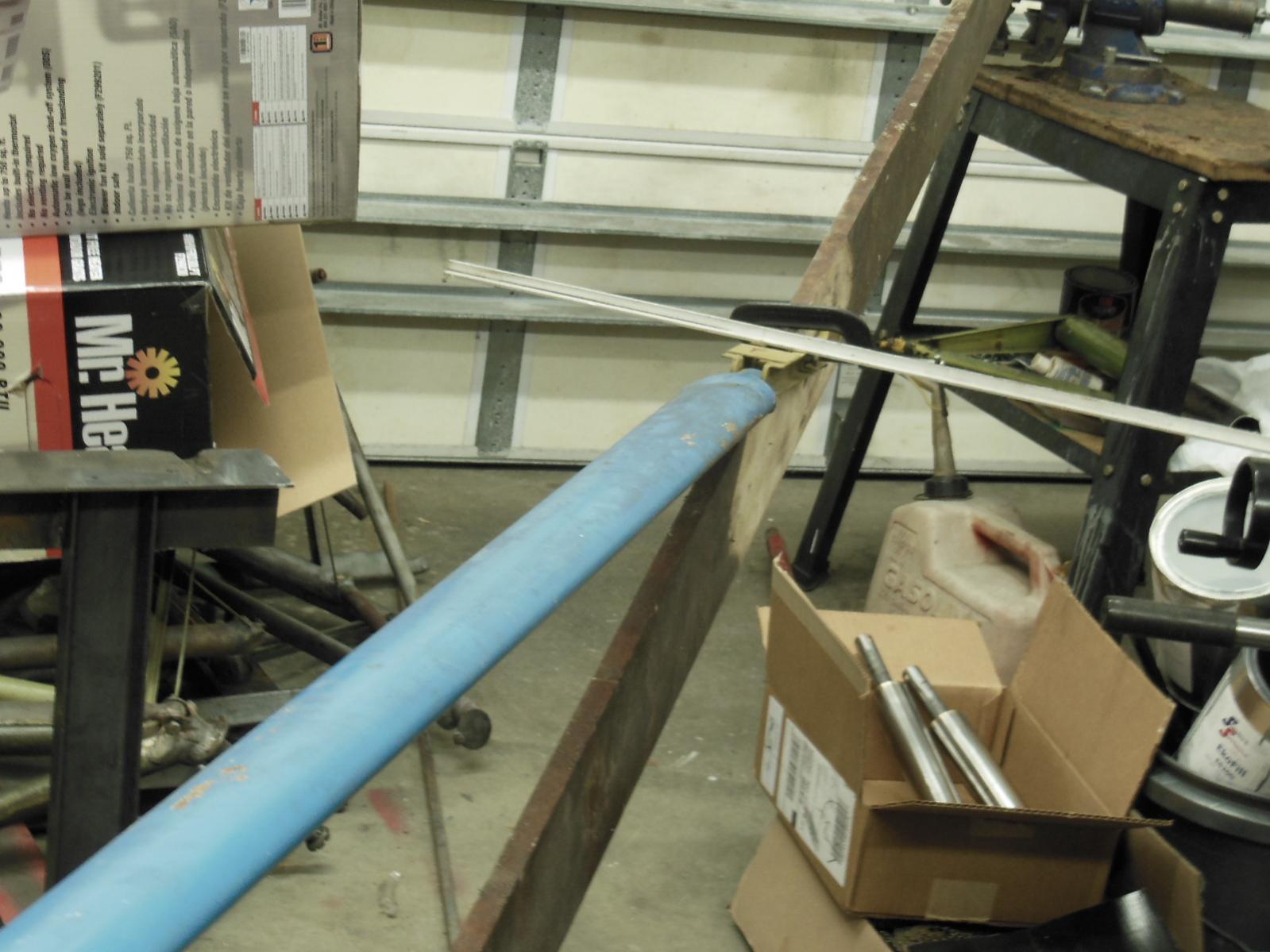

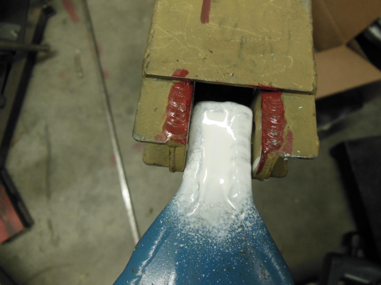

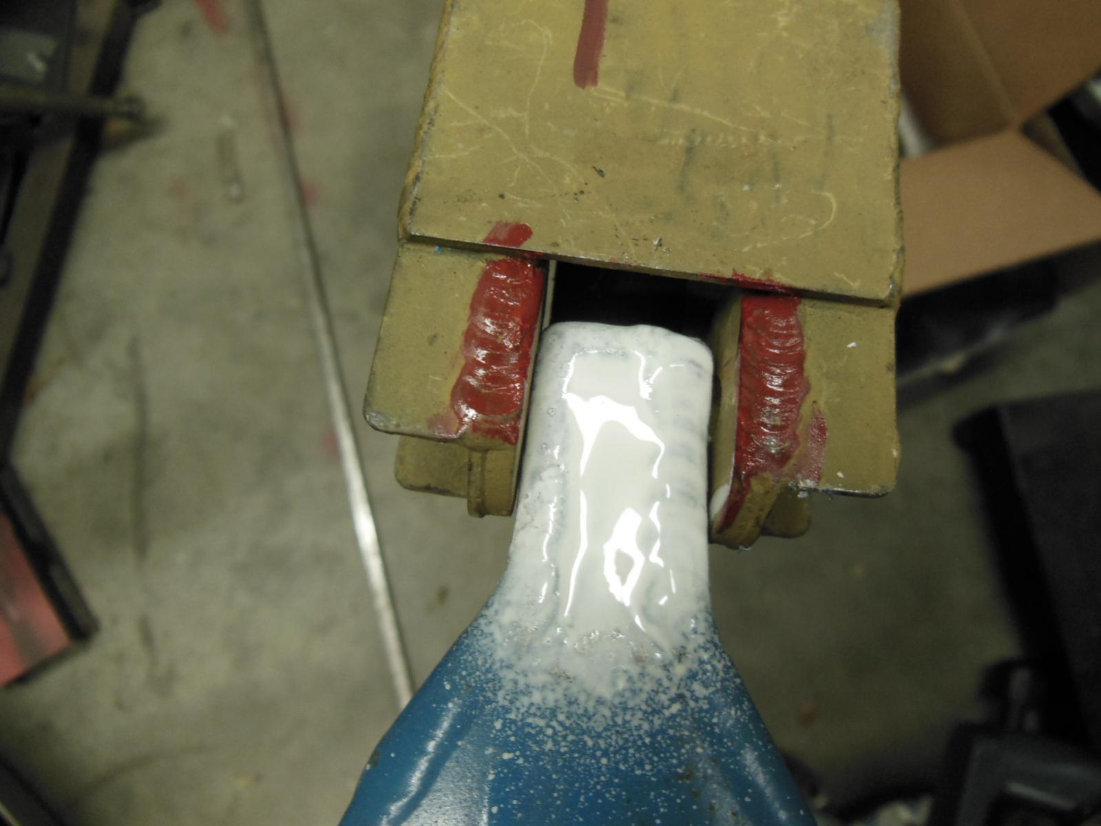

                    I set up crude system to test my item #4 above.
                    #4 does result in a bend in the proper direction but the magnitude of the bend is small in fact the clearances in the fitting would allow for the required angular mis-alignment. It may be because I don't have the inboard end of the strut clamped in position. Will work on that tomorrow.
                    So I think number 4 is a proper scenaro to result in a bend as seen by AA but there is not way it will produce a 6 degree offset in my setup. My setup may be the problem here. I had to move the spar 1" forward to get the small change seen in the pictures.
                    Middle picture is normal situation, rightmost picture is with spar moved 1" forward
