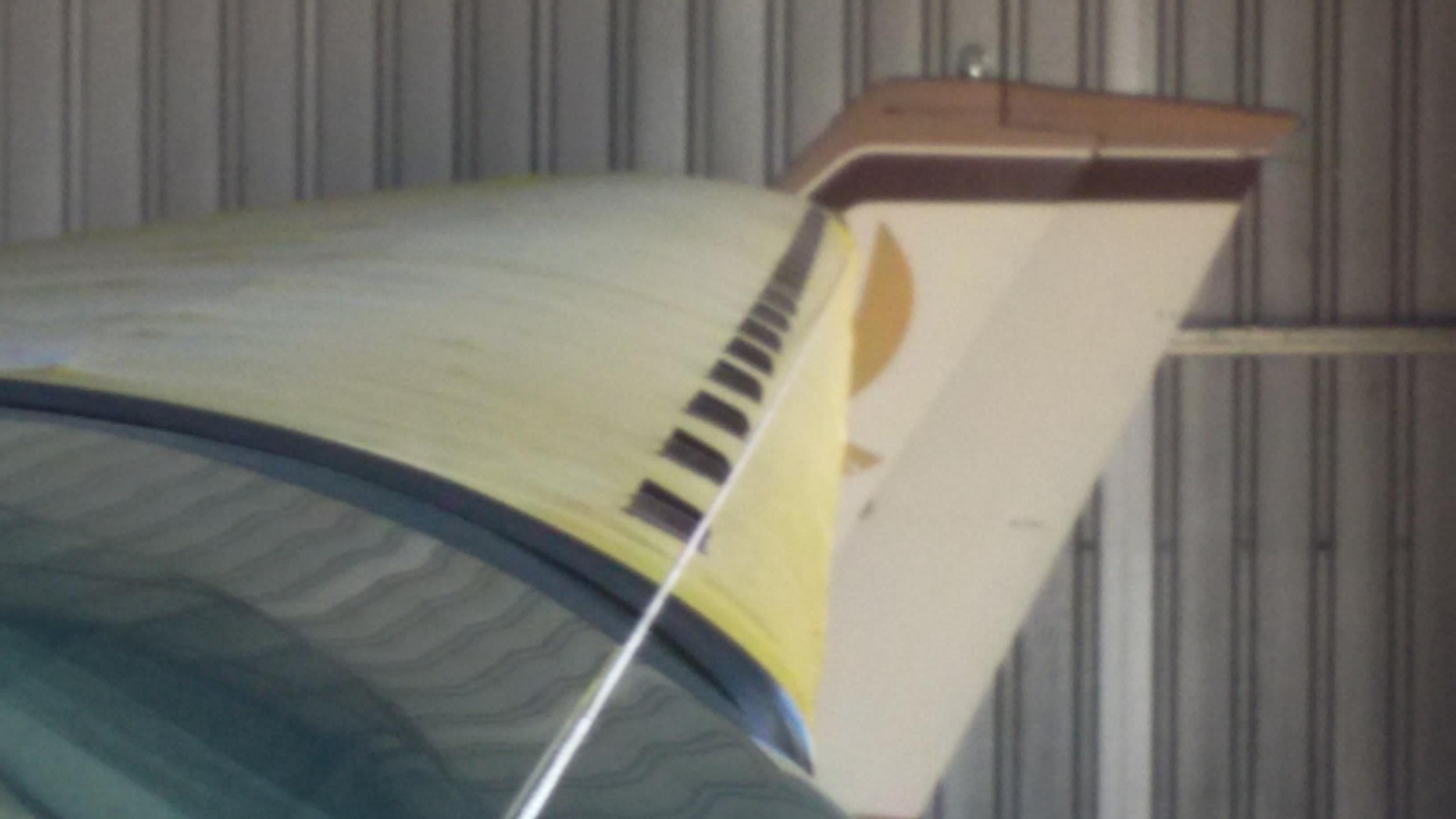

                Tail up and level, my wings are definitely swept back. Somewhere around 1.25 inches. I'd post a picture if I knew how to.

                      I found a different protractor and came up with 8*, the other angle finder I used was too big to try and use on mounted struts.
                      It's a crappy pic but you get the idea. Thanks for the picture tip.

                            3) The string is interesting. I think that before I believed in sweep back I would redo the string measurement and use a technique that only allows the string to make contact at the wing tips. Perhaps tape a block of wood to the last rib at a certain distance aft of the leading edge then see if the string is parallel to the leading edge. It looks like the existing string is touching in many places, that is why I said what I just said.
