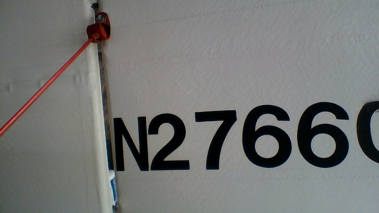

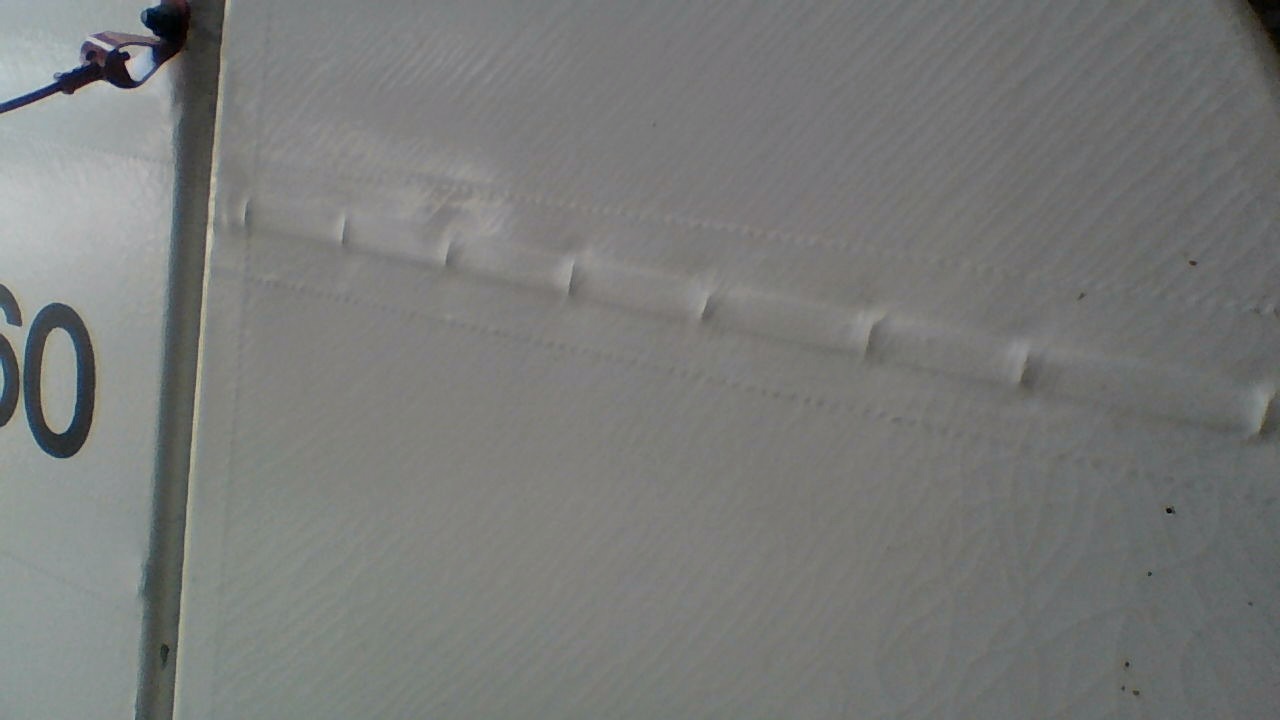

                                I bought my 1940 BC-65 in 2003, after it had been completely rebuilt in 2000, and covered in the Blue River system. It had been hangered constantly from the day it was covered, to the day that I bought it, and every day from then until now. The finish is 16 years old, and has small cracks all over it. My wife's Cessna 140 has a Stits recover that is 10 years OLDER, and it has NEVER been hangered, and the Stits system looks FINE. I'm going to recover my plane this Summer, and I am going to go with what I have experience using since the late seventies, which is the Old School Stits.
