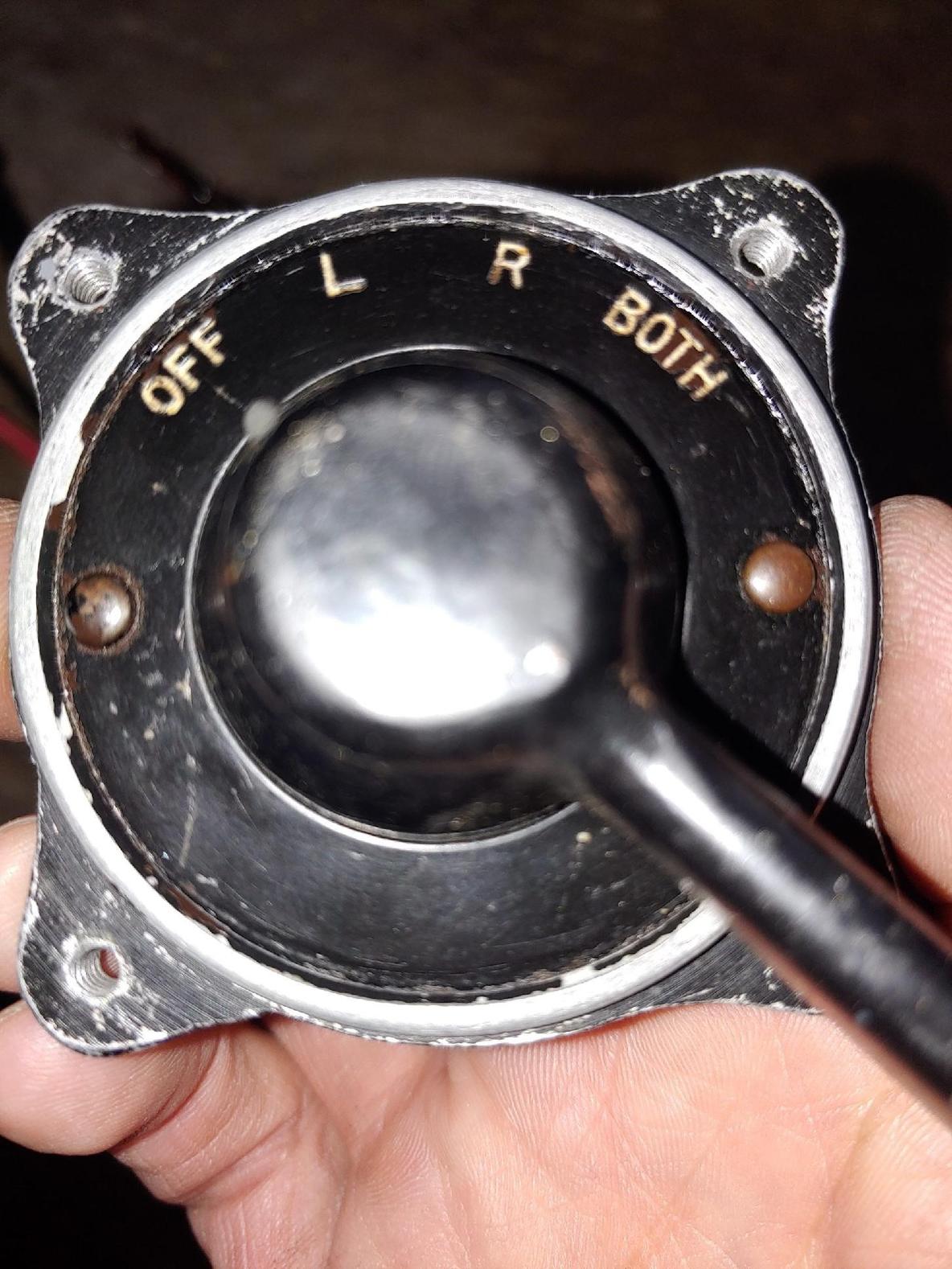

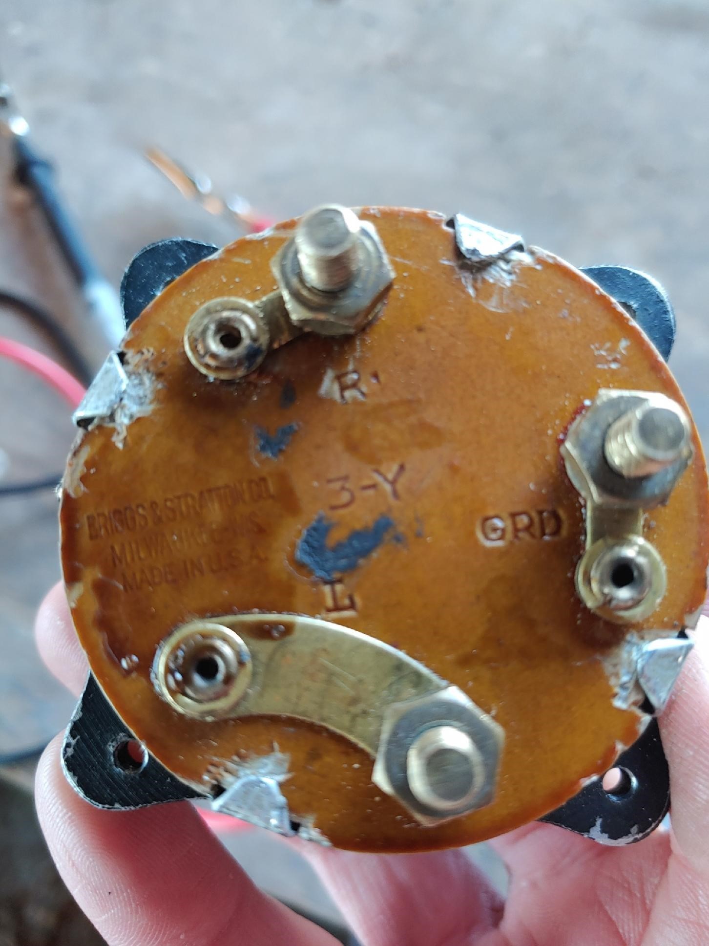

    Hello everyone,
    I have a 1940 BC-65 with a Continental A-65-8 and the original magneto switch is worn out. I also need to replace the bungee cords, which are sagging. Does anyone has the bungee cord specs, model number etc? Does anyone have an original magneto switch that works? please see the pics of the old magneto switch.

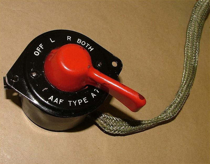

    I am in Virginia Beach and have the bungee tool if you don't find one closer that can be mailed for shipping cost up and back. I have also fixed a number of the A-7 type switches. Problem is most of them are pretty worn out and have a high failure rate. On my 45 I took a beyond repair switch and used the face plate and handle to hide a modern key type mag switch. The key is potted inside the handle and when the handle/key is inserted through the face plate into the modern switch it looks just like original. When you pull the handle/key out all you see is the face plate and a key slot. I would NOT modify a repairable A-7 like that because they are getting kind of rare and hard to find (not to mention EXPENSIVE!) but it is a good solution for a flying plane.
      Pre war bungee is a 9090 IIRC. All of the original switches I have seen only had two mounting lugs.
        Didn't open a larger photo of the switch. That is a RARE one! Like Tom said. An A-7 has two lugs. That one is designed to go into a standard round panel hole! This is the stock A-7
Name:	A-7 Mag Switch 1.jpg
          These switches are repairable. See attachment.
          As Hank says if you have one that is in no way at all repairable you can convert one on to a keyed mag switch. Or just put a new keyed one in.
          But like Hank says do this only as a very very last resort.
          VA-Vol-31-No-10-Oct-2003 Mag Switch article only.pdf
          Scan TOC newsletter #147 A7 mag switch.pdf

              Looks really neat. Appears to be a plastic material that will not be perfect (LOOKS like a plastic copy) but from a few feet away would look great. CERTAINLY better than the alternative of a regular key switch in the hole or an unreliable A-7! Price is right too! I would only want my A&P IA to look at it before I put it in. I can't see why he wold object since it is really just cosmetic.
              Just a bit of sanding and some paint and I am betting it could be a very realistic copy!
                It looks like 3-D printed. But for $28, it looks good.

                  thanks for the replies. Hank, My IA has the tool but thanks for the offer. 3D, thanks for the bungee #. I found an older A7 switch that fits the hole and is working, but i don't think that is the original switch. i have details from the restoration Tom Macarios did in the 80s and he said he retained and used all the original gauges and mag switch. The plane had been in a barn since 1959, where it was placed after being in the civilian pilot training program. I learned to fly in a 1940 BC 65 that was all original as far as we knew and it had the same mag switch as the one that is in mine, the Briggs and Stratton 3Y.. i really want to keep the original switch. For now, the A7 i found is doing the job. If anyone comes across a switch like mine, please let me know. even if it doesn't work, maybe i could combine the two into one good one.
                  Thanks again everyone.
                    One thing a LOT of us have found is Taylorcraft was often known to use what they had when they couldn't get the regular part. It is TOTALLY believable that they didn't have an A-7 when your plane came down the line but did have a 3Y. LOTS of post war planes got pre war aileron hinge fittings (lucky owners!!). My 41 Deluxe was one of a few that came down when there were no Banjo wheels available. A hand full of planes got a welded tube control wheel. They don't look NEARLY as fancy, but are actually extremely comfortable to fly with. MUCH more comfortable than the post was Pretzels or later cast ones!
                    Bottom line, not much on a Taylorcraft is subject to configuration control from the factory. If the part on hand was safe and fit, I think they would have used it!
