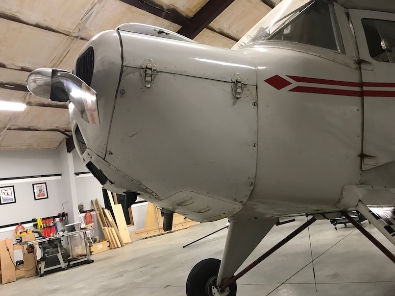

      Hi Hank,
      This is a picture I took a while back. Hopefully it answers your questions.
      If you look carefully at the right latch, you'll see a crack. In the 7 or 8 years I've owned this bird, it hasn't expanded, but it has gone beyond the drill stops. If it turns out to be too big of a pain to replace the cowl, I may just patch it and call it good. Otherwise the cowl is fine.

        [Edit after seeing Anymouse's photo: That's definitely compound curve]
        I don't know the exact alloy, but it's not 2024; it's much softer. All the 1946 Taylorcraft I have seen (and that's many) have a compound-curved lower cowl, as Hank says.

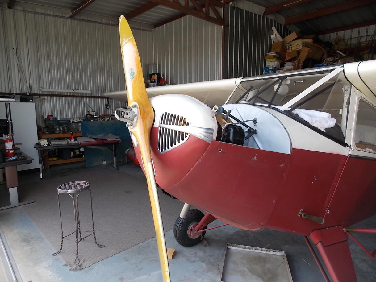

        There is an interesting photo "out there" somewhere in the ether that shows the huge die that the factory used to stamp these out in one piece. The F22 had a "flat" curved lower cowl, but that was much later, and was for the Lycoming 0-235 engine. A very ugly cowl.
        The two photos below give some indication. First one is my '46; second photo is an F22 (white aircraft).
