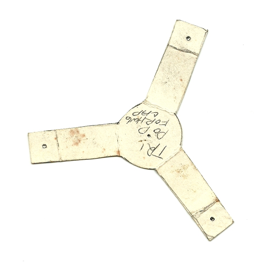

    I just have a paper pattern, but it would be simple to make up. Draw a 4.25" circle, and then a 1.125" inner circle. From the center mark 3 120 degree radials. From the radial lines measure 9/32" on each side to make a 9/16" leg. Trim the legs to the inner circle. On the ends of the legs bend a 1/2" flat and drill a hole in the centers of the flats for the screws. In the center circle I would add a nut plate or riv-nut for the center screw.

          The bracket is held on with three small sheet metal screws.

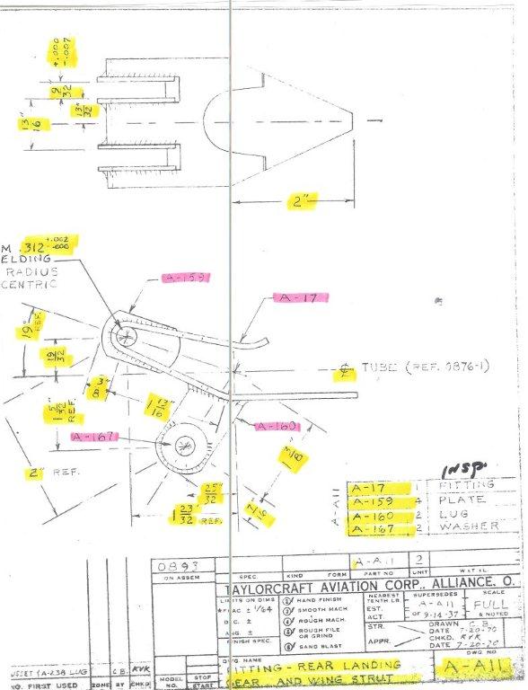

                  Marty may have gotten the rolled ones from me along with a some shock strut items that are still out there some where.
                  I have original tripods, caps and a whole bunch of stuff . I am working with the photo set up and scanning in the back room ; HONEST , i am working.... a couple of examples are attached .
                  How about THEM apples! :tup: Forrest amy learn this computer stuff at last... got to go fly a photo mission .... back sometime.

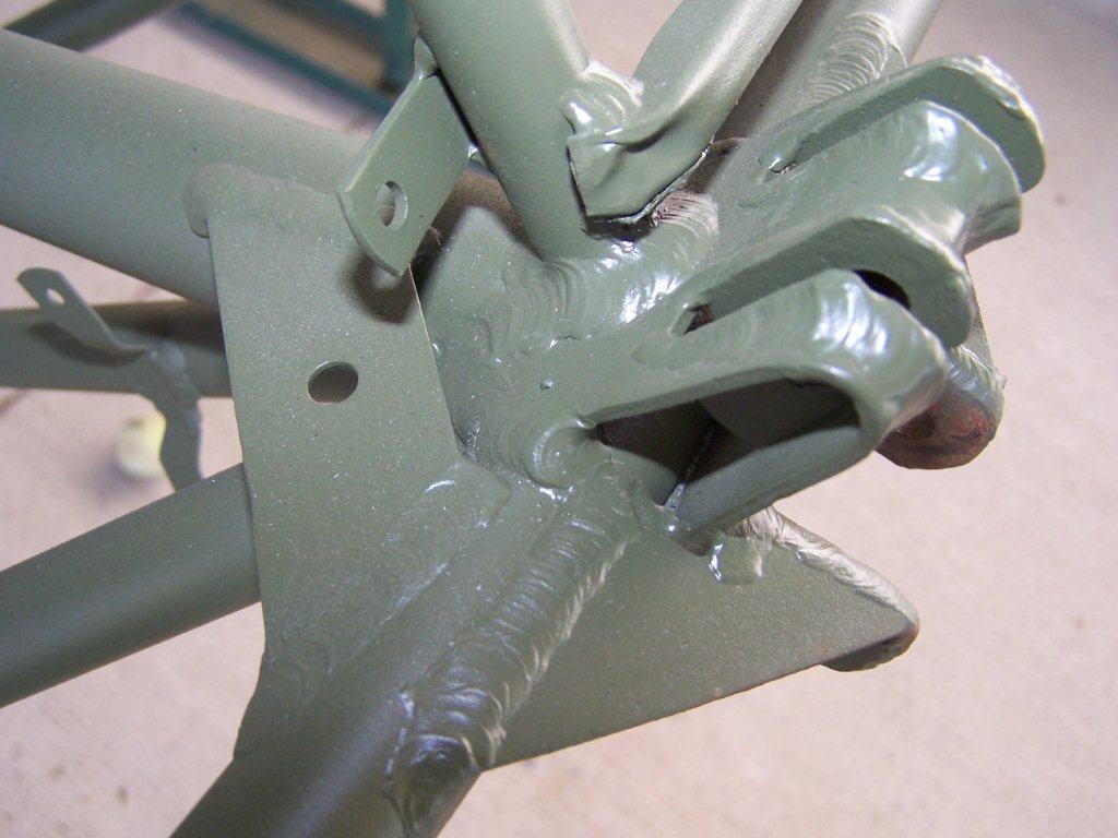

                              hmm...
                              Nice welds!
                              I enjoy just looking at them.
                              Maybe that should worry me.
