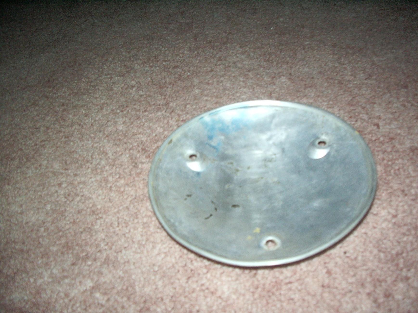

    I will spin hubcaps for the group if no one else is fabricating them! I would need a drawing, sketch or actual hubcap to pattern a mandrel.
    Could someone please post pictures of the hubcaps!

    There are two styles I have had, unfortunately I have niether at this time. The most common style for the BC-12 has three flats on the face for mounting. The other is common to the L-2 with a single mounting hole in the center. Each has a rolled edge. I am not sure if you can, or would be willing, to make the typical three hole mount which is what most folks usually want. No one has successfully reproduced a hubcap for the BC-12 that I have seen in the six years I have been involved in T-Crafts. Hopefully someone chimes in here with one you can actually look at.

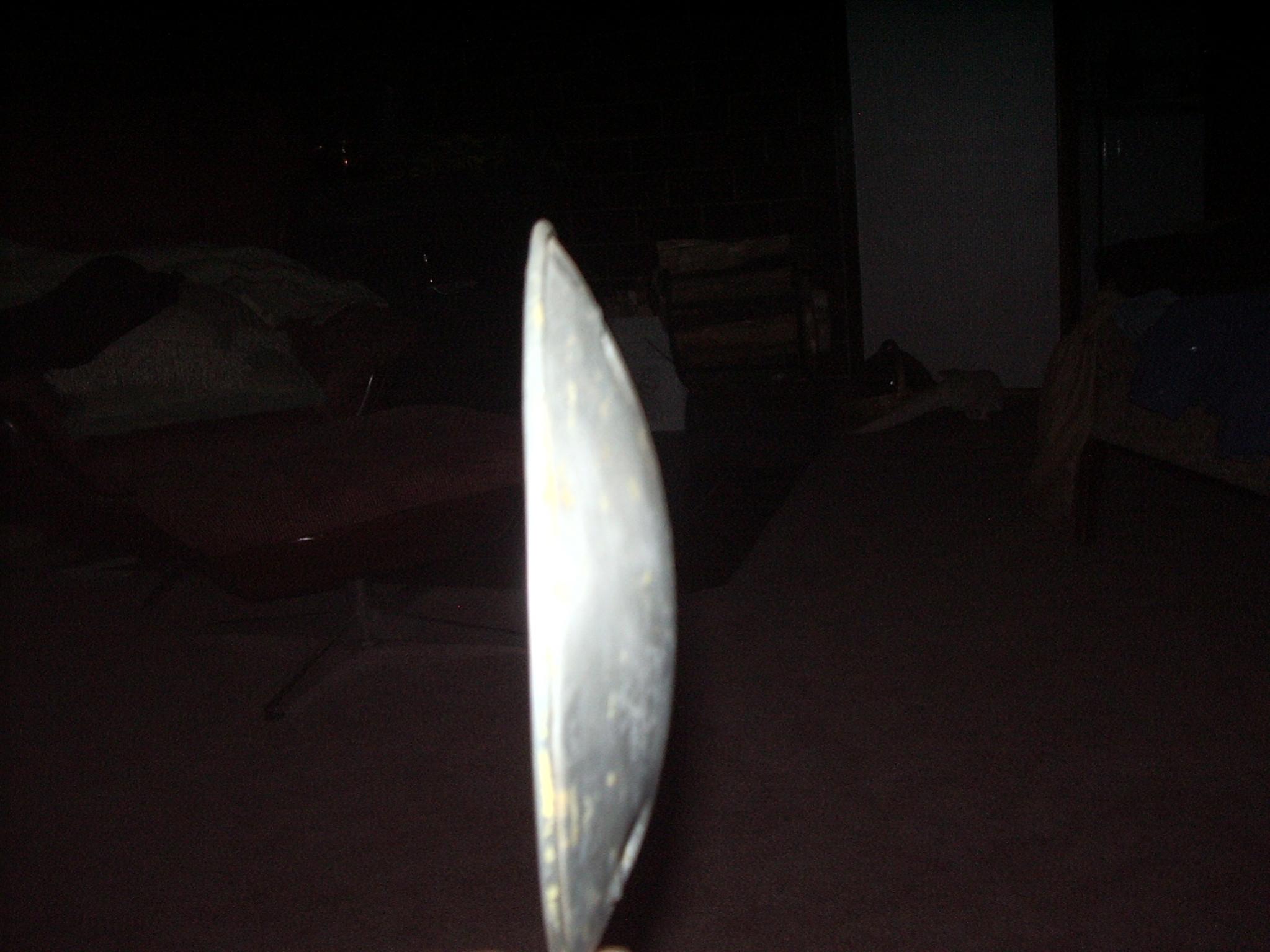

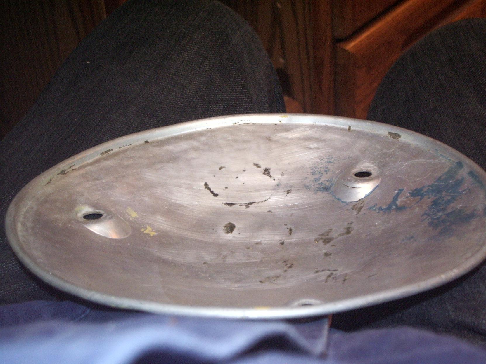

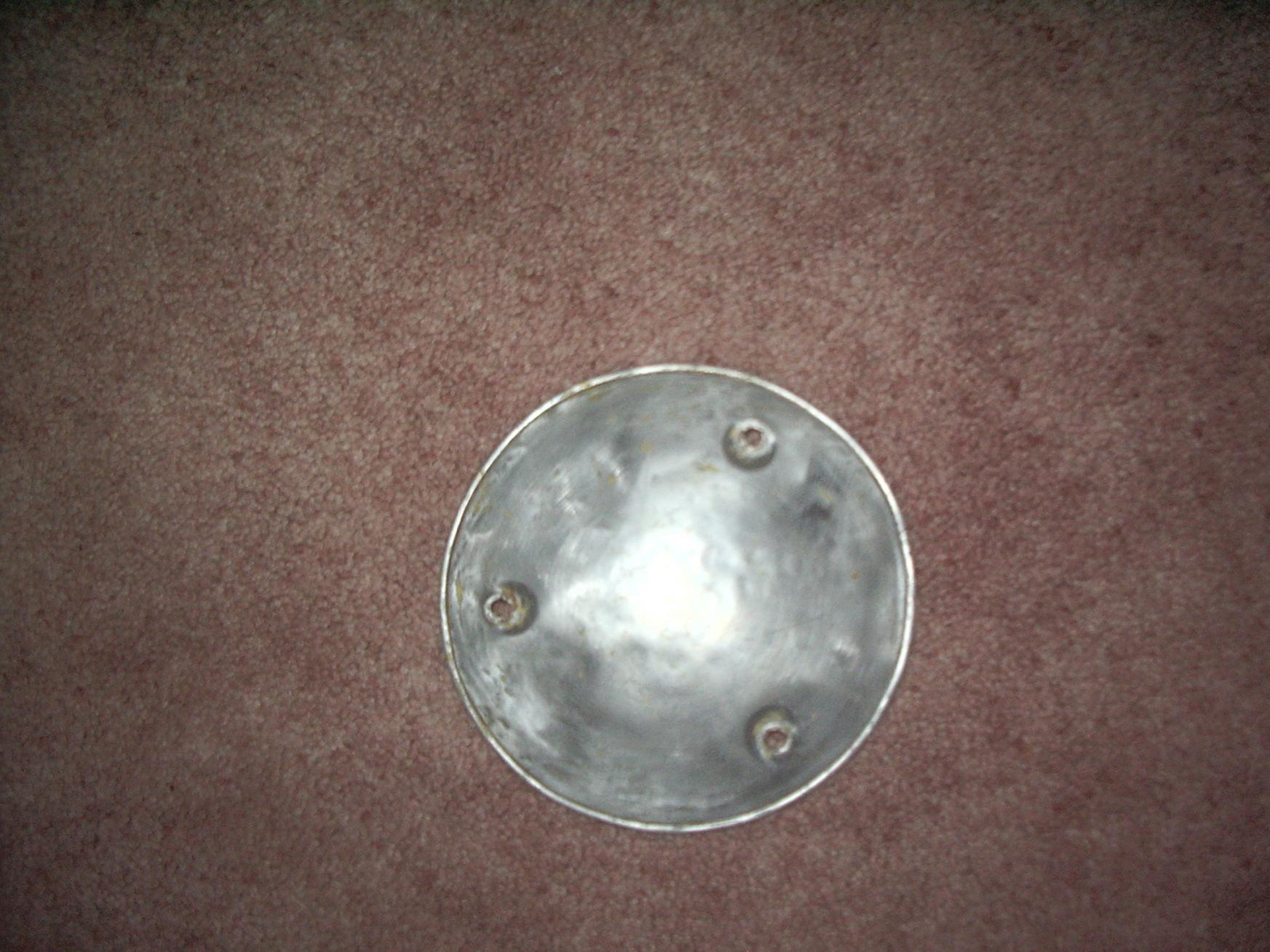

        Outside view, Inside view, side view and inside angle view.

                            There are 2 styles of hub caps the 3 hole type like you have in the picture, and the center hole type for the pre war. If you look closely at your wheel you will see 3 small holes on the ridges near the hub. These were for attachement of a 3 legged bracket for the center screw hub cap. Some place I have a pattern for the bracket. Tom
