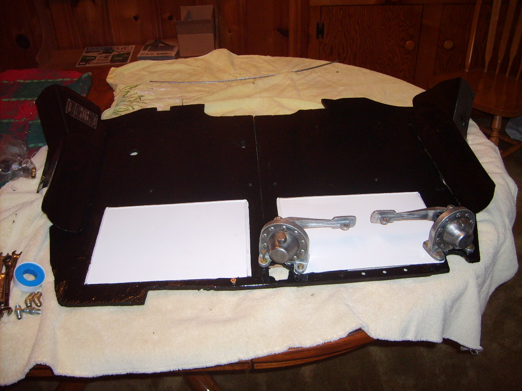

                  • #39
                    Re: Grove disk brake conversion for tapered axls
                    Chuck.

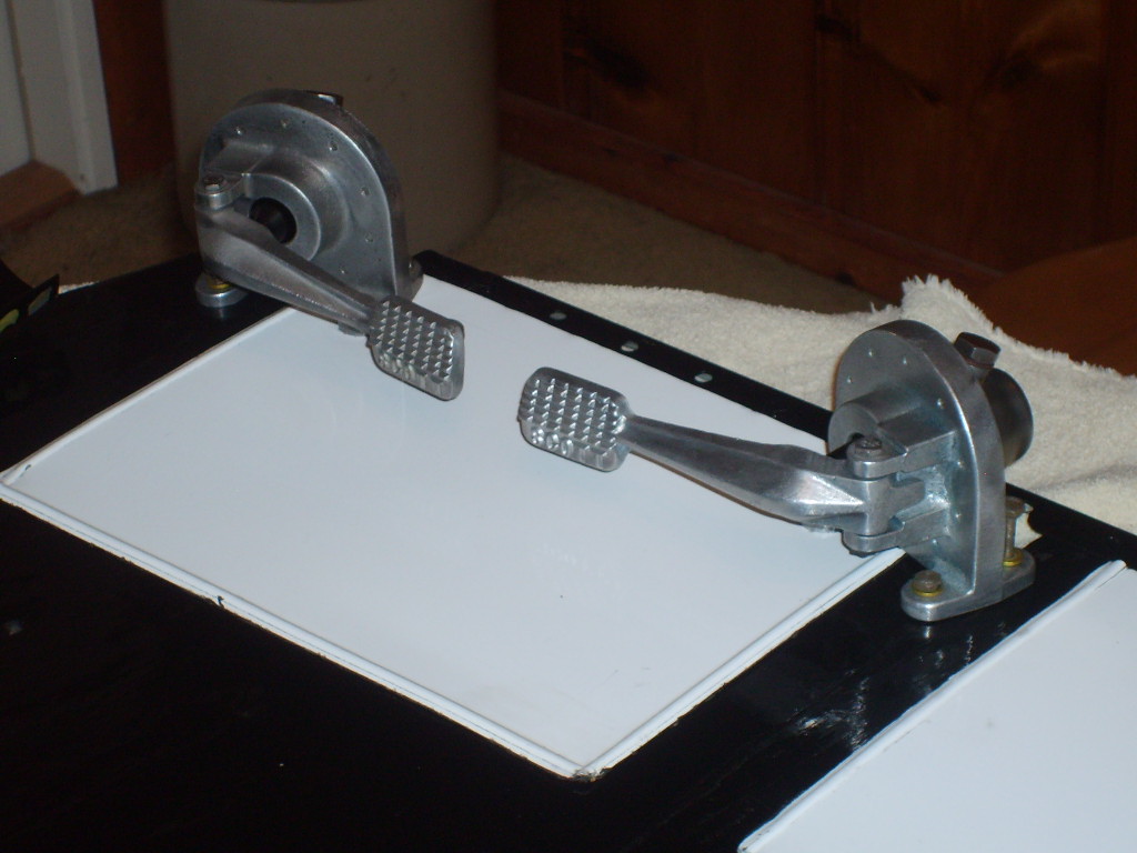

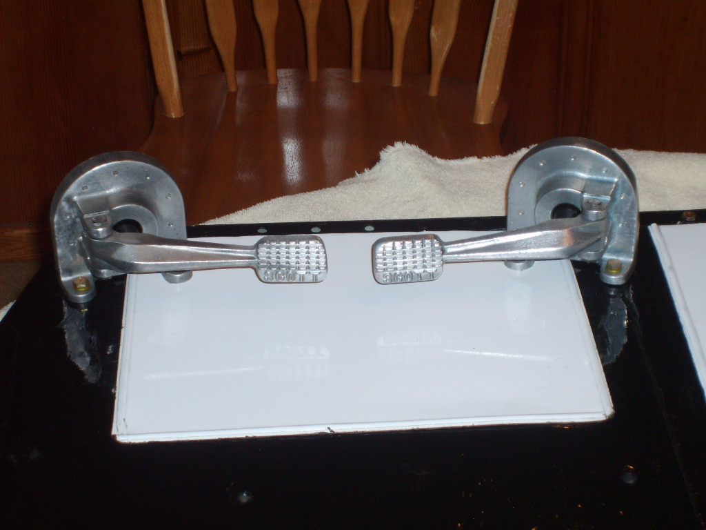

                    Great job. Can you post some pictures please, I would like to see how you positioned the master cylinders. The brakes are my next project.
                    Thanks and Merry Christmas.
                    Peter
                    • #40
                      tribe

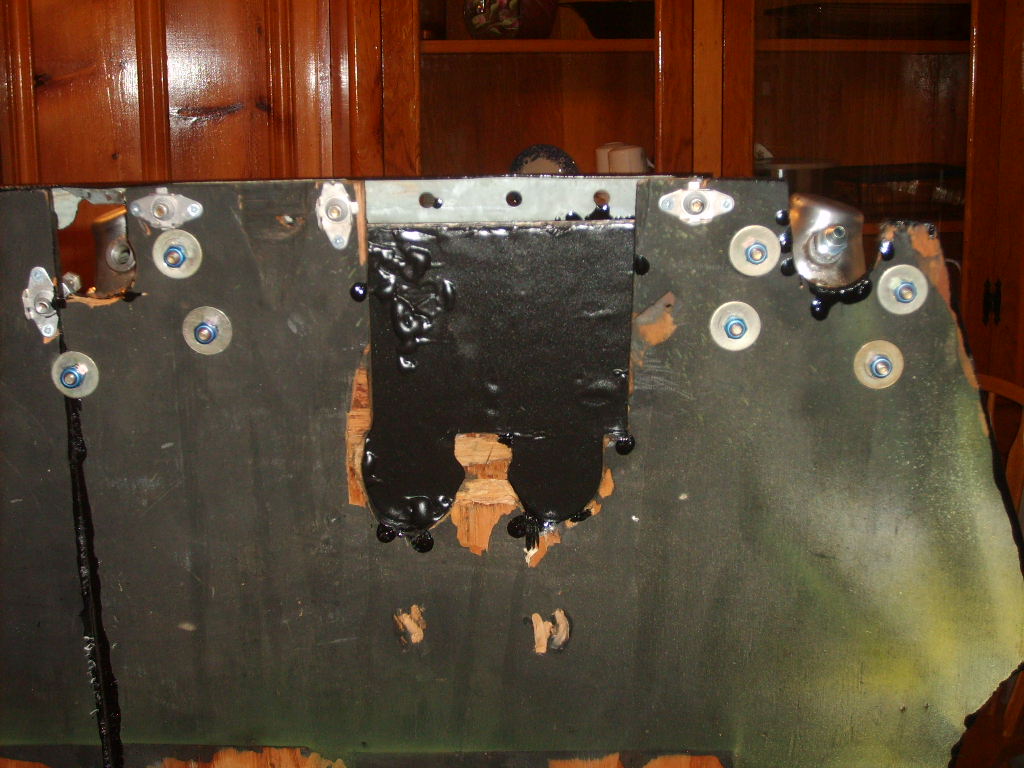

                      hear are some photos of floor boards with master cylinders will get some with them in plane Chuck
                      1940 BLT/BC65 N26658 SER#2000

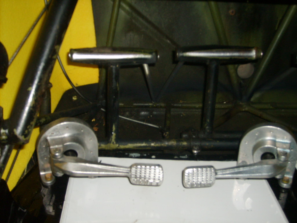

                      • #41

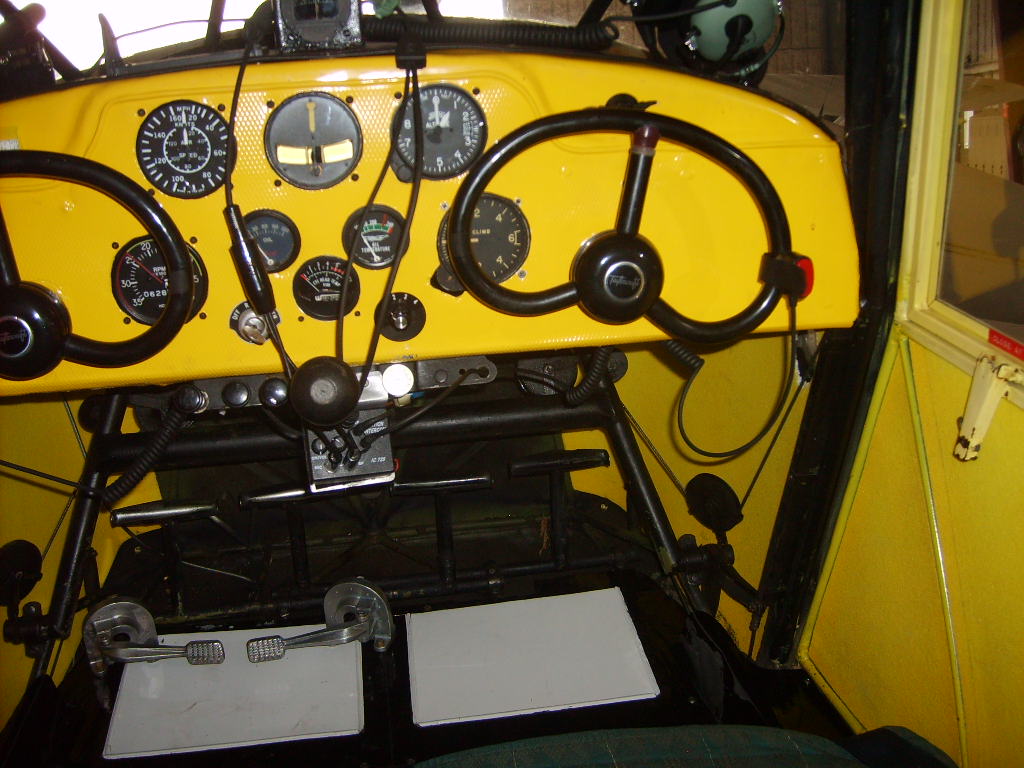

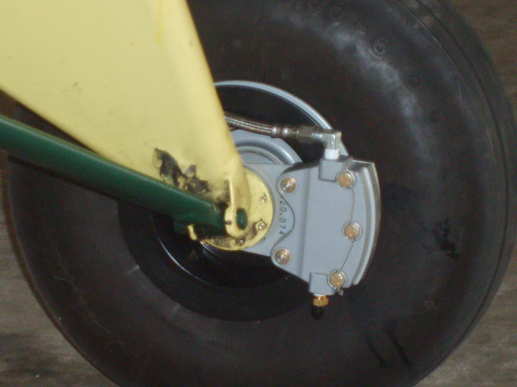

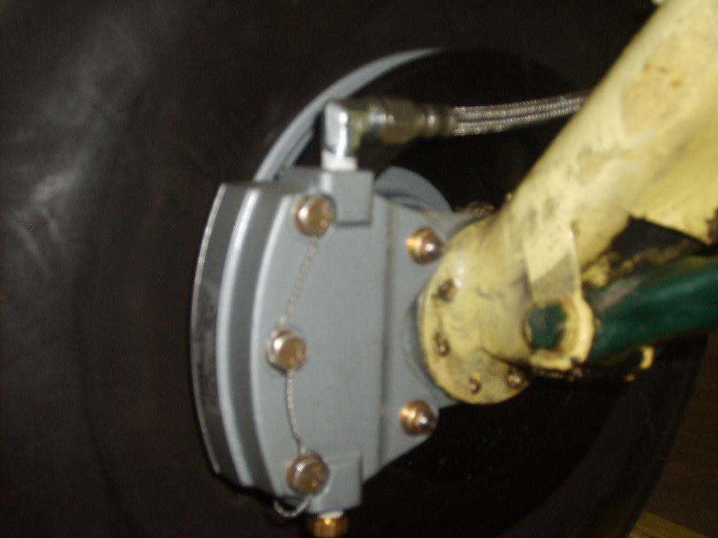

                        Here are the pics of the finished conversion.
                        • #42
                          Thats great. It looks like a set of heel brakes on a Taylorcraft that you can actualy use. Marv

                            What size pistons did they use in those calipers. They look huge! Have you used them yet? How does it feel when you brake? I bet you can make some tight turns with one wheel locked up!

                              the calipers are not as big as they look they are two piston but small diameter have not tried them yet hope to taxi test tomorrow will keep the tribe informed on my tests Chuck

                              • #45
                                Chuck.
                                Thanks for the pictures. I will be using Groves master cylinders installed under the floor. I like your installation looks nice and simple. I already have the Grove master cylinders plus all the hardware to install the brakes so I will stick to my set up.
                                Thanks
