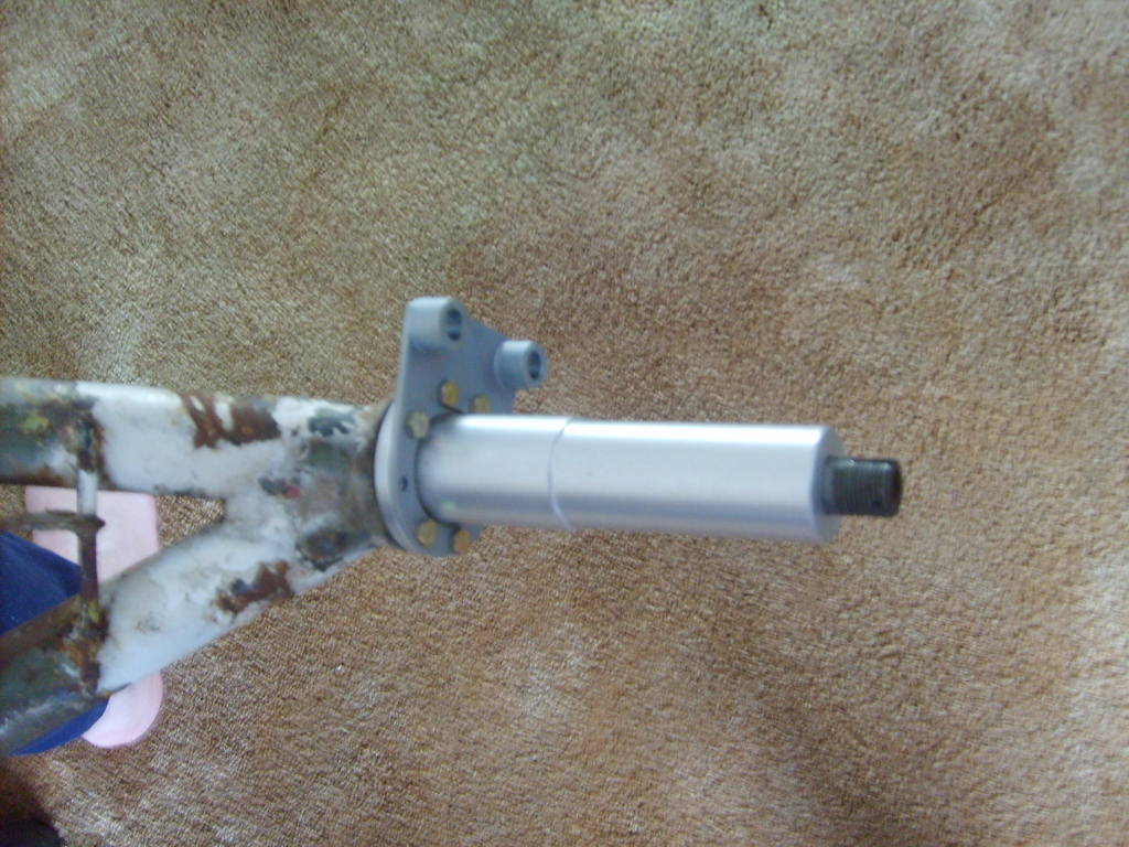

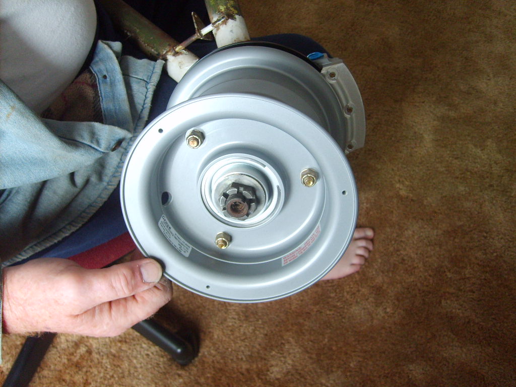

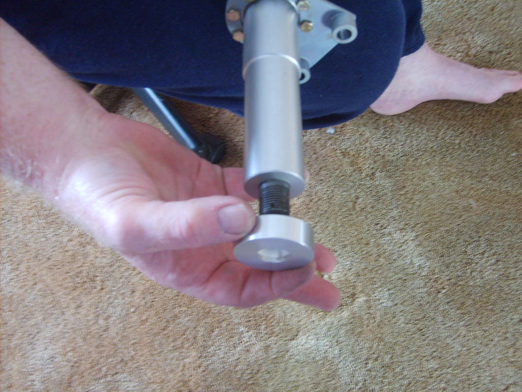

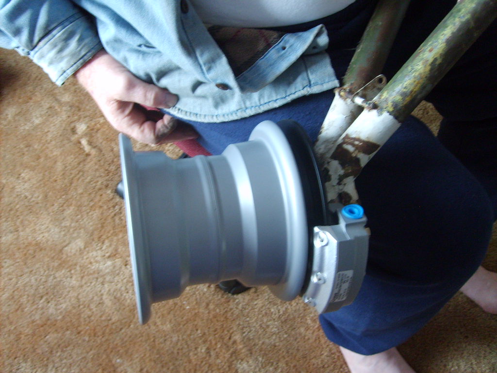

    I jest received the parts from Robbie Grove to use his brakes and 600x6 wheels the axle sleeve he has made is so simple no welding or cutting can install the whole thing in about 2 hr .

      the total price was 1258.00 to my door will be using scott heal brake master cyclenders robby sized the callipers to work with 300 psi that the scotts put out will follow the cable route instead of pullies will use adell clamps to hold the hoses the hose will be 1500 psi teflon braded with an fittings all the parts from grove have specs or certs. will send 337 to FDSO in the next few days for approvel Chuck

        what keeps the aluminum axle spacer from rotating? Just the torque on the nut? If so, I see a failure coming, sleeve needs to be pinned or just the weight of the aircraft or failed bearing could cause the sleeve to spin causing the aluminum sleeve to wear on the tapered axle causing premature pad wear which could leave to caliper failure, and cleaveland calipers are already suseptible to cracking at the pin bosses if not keep cleen so they will move freely. Nice idea, I have already developed a similar kit, but used a 4130 steel sleeve that screwed onto the original threads, was pinned, and new sleeve was threaded and used the correct 1 1/2" nut washers, and spacers. I never marketed it cause the cost to get it approved for sale was not justifiable.

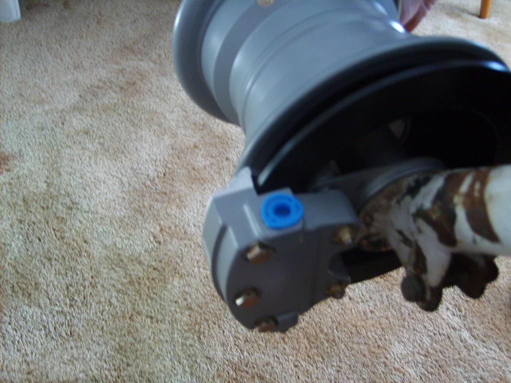

          It appears in your photos that you are using six AN3 bolts to attach the torque plate. Are these some sort of high strength bolts? Have you investigated the torque requirements to see if these bolts are strong enough? I hope you can get it all approved. I would love to put disc brakes on my project plane with the Harer STC.
            It looks in the picture like a one-piece machined spacer with the flange behind the caliper mounting plate. I'm not an engineer, but I'd be willing to bet a Taylorcraft flipped over on its back that the combination of shear strength on six AN3 bolts and the clamping action of that caliper plate/adapter/axle boss would be more than adequate to do the job.

                Well the 2000 lbs gross cubs have 6 AN3 bolts for holding the calipers on, even with 35" bushwheels....so this kit should be strong enough. Tim

                        This is copy of a field approval I got a few years ago and it's basically the same thing as the grove adapter and it works good, it doesn't spin. AtLee Dodge makes the same type of adapter for a cub to go from a 1 1/4" to a 1 1/2" axle. A standard cub uses four AN 4 bolts, I think the number of AN3 bolts in the picture will be plenty, It's not a boeing 737.

                          the axle sleeve has a flange that is drilled with 8 holes that are an3 it is between the flange on the gear and the tork plate with 7 an3-4 bolts the sleeve also has a taper on the inside that is an interference fit with the out side bearing shoulder on old axle. The collar is also for adjusting the bearings using the tcraft axle washer and castle nut and cotter pin

                            I see the solid machined flange now that is part of the spacer. I feel better now. Bolts are plenty big enough to hold it in place.
