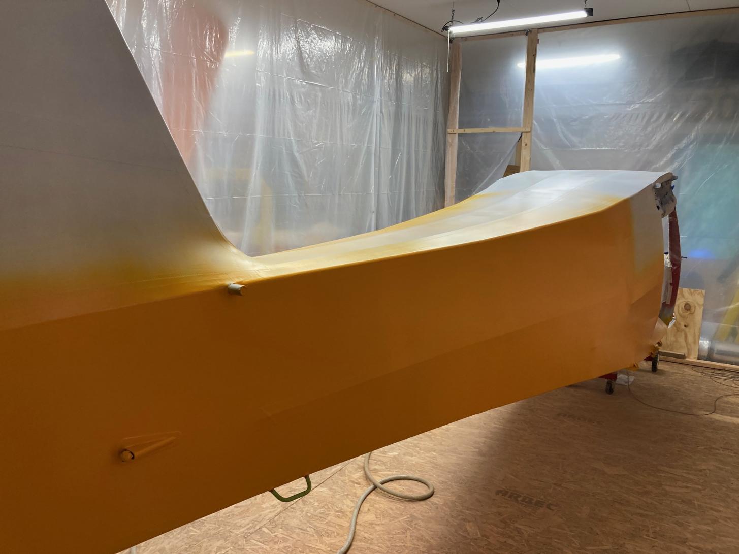

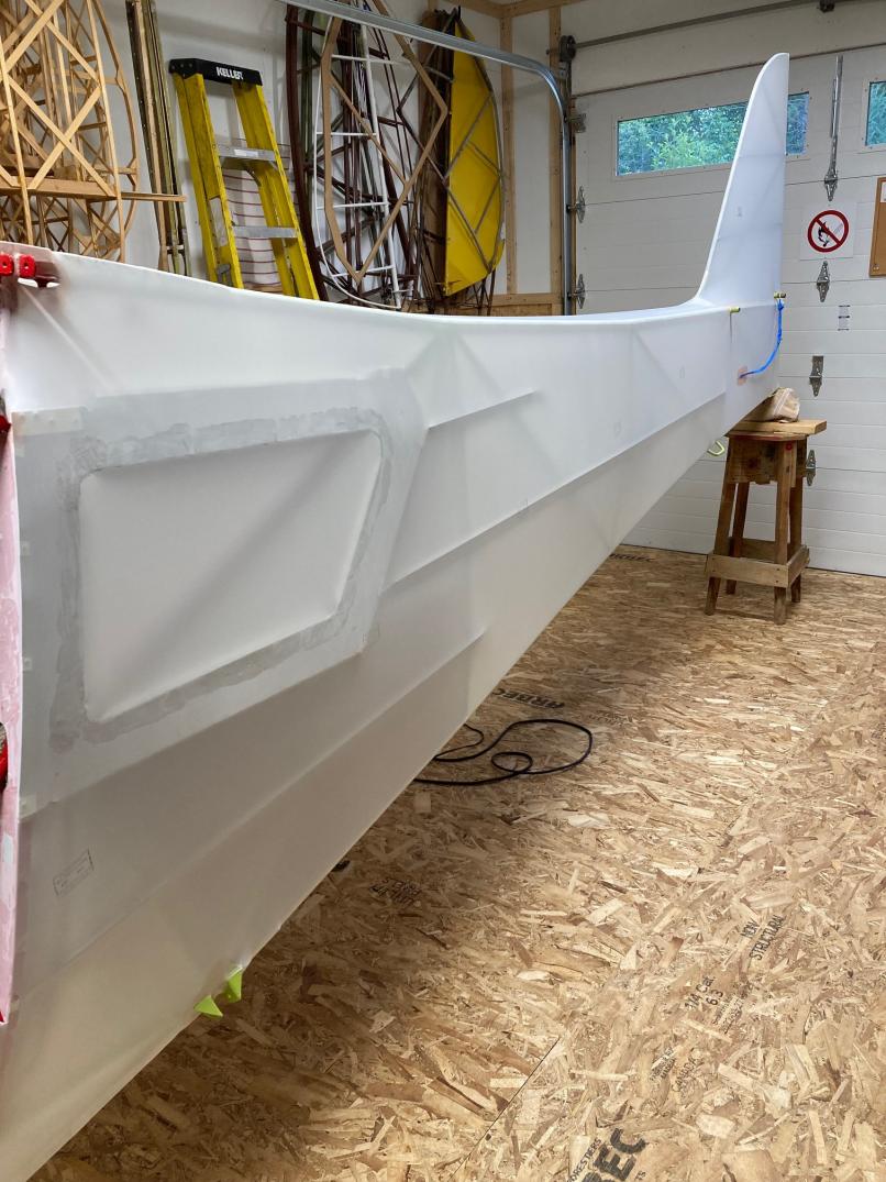

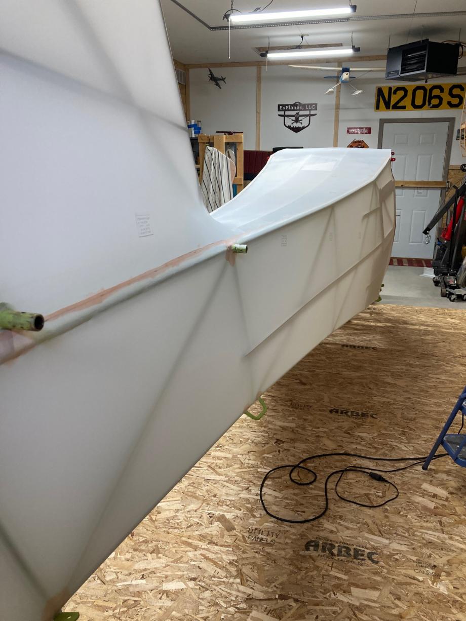

                        Here are a few pics that may be interesting. Up here on Champs and Tcraft we overlap and glue the tail to fuselage transition. No AI rejections that I know of. I agree on the blanket vs the sock approach. Better results. Click image for larger version

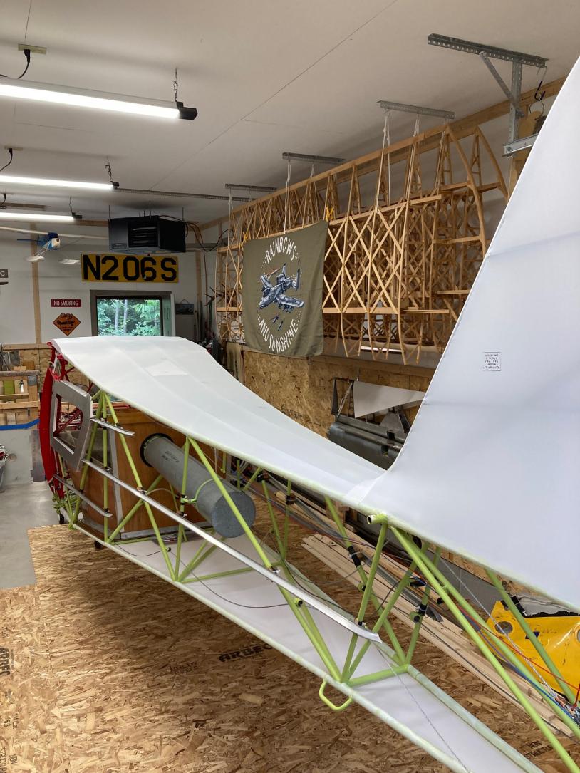

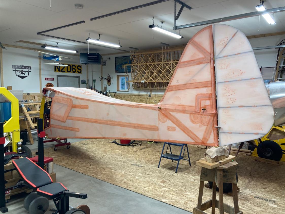

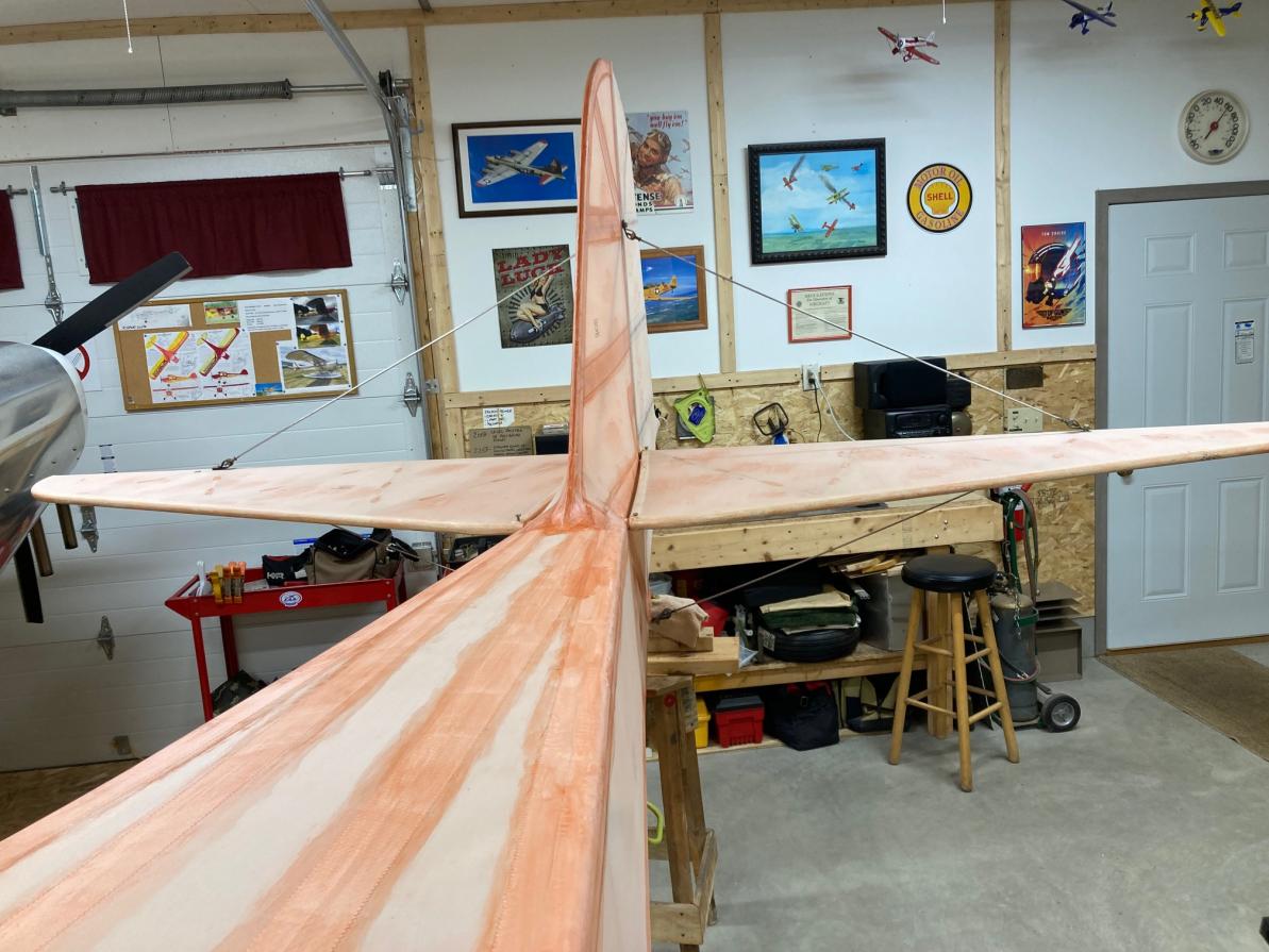

                          Couple more pics. Make sure you pull the fabric slightly tighter by the tail transition so when you final shrink it comes out tighter. If you shrink evenly on both sides of the vertical tail it will come out straight. Click image for larger version
