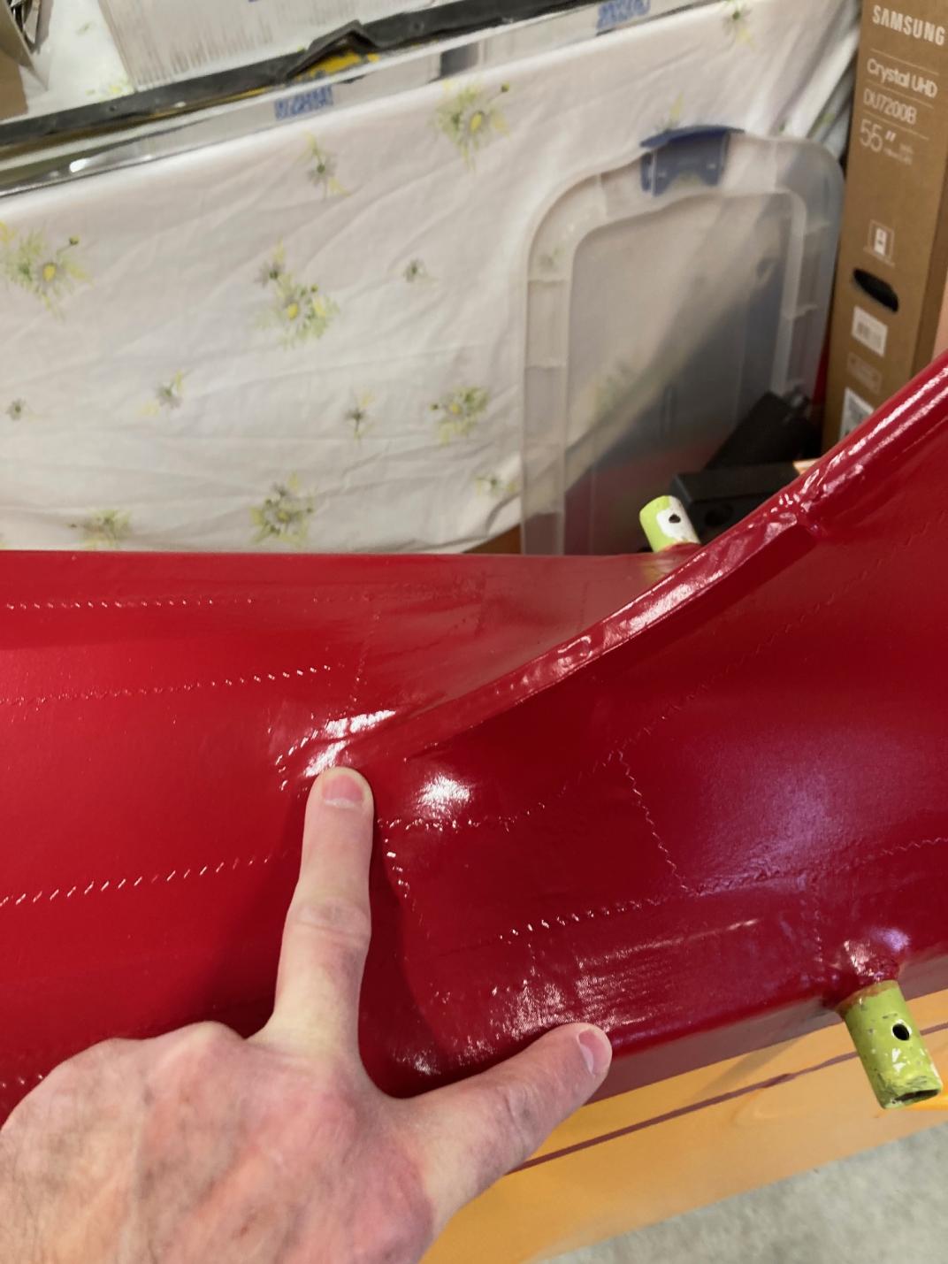

        If done properly the gluing of the fabric at the tail transition works well. The fabric of the vertical tail is glued to the top fuselage tubes and the radius transition between the tail and fuselage. The fuselage top blanket when installed is also glued to the same top tubes and overlapped to the tail fabric. The transition shown between my fingers in the pic sees reduced shear loading along with tension and compression due to the fabric glued around the tubes. Every application is different for this one it works and has been flown successfully for years.
        I would never use this approach or recommend it over any unsupported wing covering or other unsupported fuselage covering. Click image for larger version
