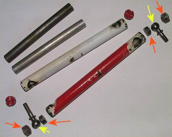

            I know Rob has had them apart before. Here is a photo of the rod assy.
            You might have paint down into the threaded rod end cap threads. Might have to use some carb cleaner to strip the paint. Might help.
            Hope it helps.

              Thank you Mark. I did see this photo as I was researching..I think here. Robert has done an excellent job in his photos and markings on them showing what is what! Gifts we can use. Thanks again!

                        Ok so today after several days of soaking in penetrating oil and tapping on it with some significant persuasions I got the cap loose and off. I would have thought with the oversized hole on the pushrod tube the ball stud would simply pull out...does not appear to want to exit this way. ...any thing I may be missing here?
                          In the picture posted by Mark above you can see the components. The inner spacer and cup need to slide away from the ball to allow enough room for it to come out of the hole in the tube.
                            So with the ball stud still in there ...there is enough room to slide the inner spacer/cup behind the ball stud and once out (or at least behind the ball stud it (the ball stud) will then come out ? Correct? The inner must come out is what you are saying so that must be the only way.....I know duh. I am simply saying what you said another way....
                              Loosen the plug/screw on both ends so the middle spacer and cups can slide. With the spacer slid away from the ball the ball will come out.
