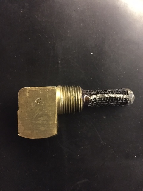

    Mark - It is a finger strainer in the tank (on the 90 degree fitting)

        Thanks, just wanted to see you had one. It didn't look like the replacement ones you can get here in the states.

            65hp was 3/8” npt male to 1/4” npt female, and the need to be drilled out all the way to the bottom, the brass fittings are only drilled part way, I also ream them to clear the screen for more flow at higher aoa, I use a ball end mill to get a good finish…
