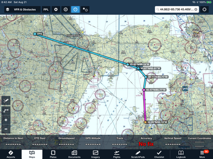

            I flew this route yesterday in 27599 at 7000’.
            About 80 miles of water. I wish I had the time to land at North Fox Island(6Y3),
            but didn’t.

              While the exact glide ratio for your airplane might be interesting, it is by no means the total answer to how far you can travel with an inop engine. As a matter of fact, flight planning with just the still-air glide ratio can lead to some big trouble.
              Other factors heavily affect how far you can glide without power. For instance, will you need to change heading to get to your emergency site ? If the emergency field is dead ahead, that's optimum and will not reduce your gliding distance. But what if your emergency site is behind you ? You'll probably give up a mile or so of your theoretical gliding range just changing heading. Then there's the question of a heading change in the landing pattern. Is the runway heading in line with your glide path, or will you need to make another turn to line up with your runway ? Then there's the wind. Do you have a headwind or a tailwind ? What is the height of your emergency landing site ? Just because your altimeter says 5000 feet, that isn't necessarily an AGL number. And then there's the need to arrive over your landing spot with a bit of excess altitude for final maneuvering.
              So here we are, sudden engine failure, a bit of confusion and excitement. Scant minutes to get your act together for landing. To take advantage of that famous best glide ratio, you'll need to assume a best glide speed, troubleshoot the failure, pick out a spot, determine exactly how far away your landing spot is, and then do the math. Can you do all that under pressure ? I can't. The best answer for me is to make a best guess while sitting at the kitchen table the night before. Then in flight you will have a calmer, better informed plan to work with. Once actually heading toward my landing spot, I will point my nose toward the objective, establish a best speed, and then watch the spot to see whether it's going UP on the windscreen, or DOWN. If the landing spot is going down, you have it made. If it's going up, you'd better find a closer spot.
              So, is the glide ratio totally useless ? No, it does have some value, mostly in the flight planning stage of your trip. If you are contemplating an over water segment to your flight, you can more or less predict how far you need to glide by looking at potential landing sites in a worst case. After you have identified your landing sites, the glide ratio will help to determine how far out you dare go. Start with your planned altitude AGL and your intended cruising altitude. Then reduce your working height by 300 feet for each 90 degree heading change that you will need to make. Then take away another 500 feet for the "startle factor". Then reduce your glide ratio by 20% for each 10 knots headwind that your weather report predicts. News is not so good ? The unfortunate truth is that a 100 MPH light plane flying a low altitude doesn't give you many options if the noise stops.
