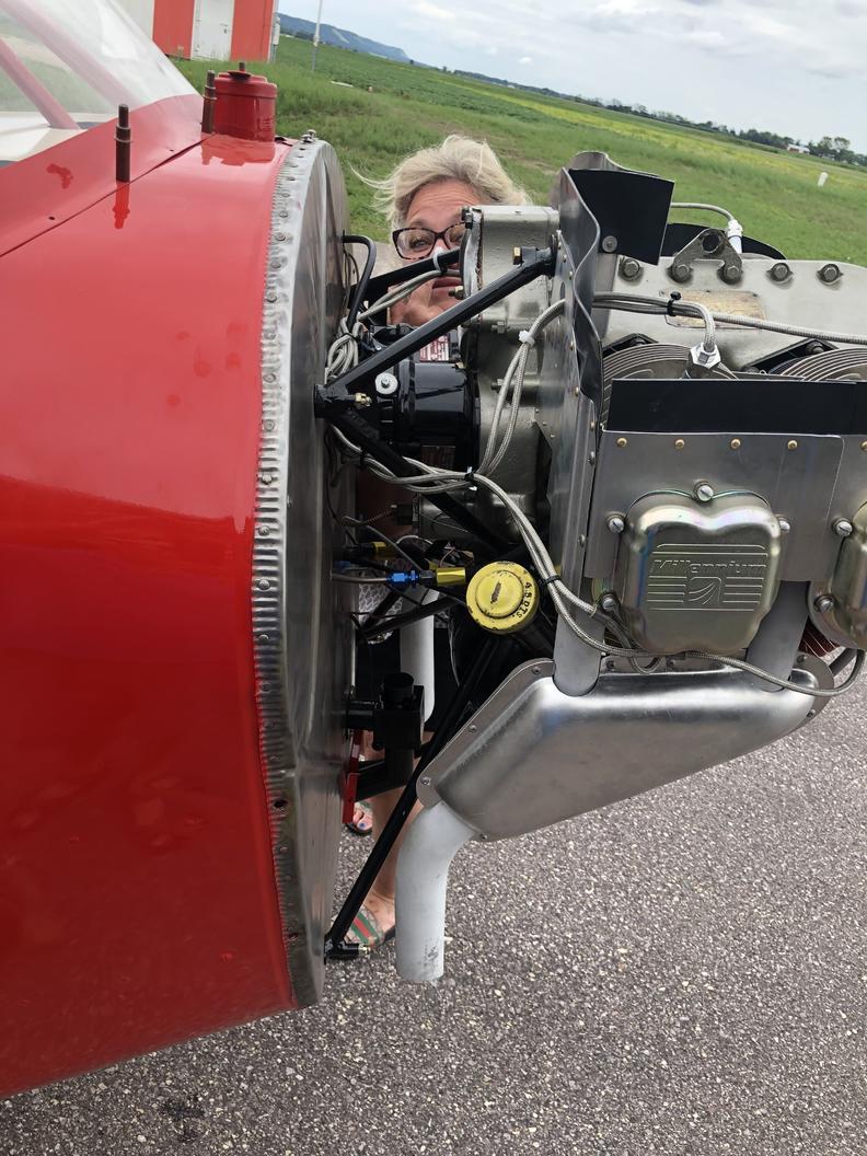

                  You had pictured in this post what appears to be a BC12 or BC12 D with an 85 and what looks to be Champ Exhaust. I see the original gasculator stil on the mount. Besides for the extra hole did you otherwise modify the lower coweling? I notice only one heat muff and the perhaps is where the problem arises

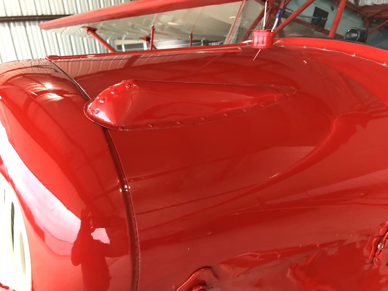

                          That's what I did on a friend's T to get home from Nevada. It works fine! I still have the top cowl here somewhere. The nicest ones I ever saw were just hammer and dolly'd into the top cowl. Very graceful and not much of a bump. Wish I'd had a way to get pictures!

                            I am thinking my metal man can do a simple bump . I am really striving for clean and and orginal to an extent look with as much of today's technology where safety comes to play. I am on to a firm game plan finally with use of an 0200.with Luscombe 8e exhaust just ordered.
                            and yes shielded ignition Getting rid of the trunk latche cowl which was installed after a 1961 nose over. It should never have had that cowling as an early 46 build. Clean look IS also a key...to a point of practicality. So not as orginal perhaps but hopefully a safer better performing ship.
                              I used the Luscombe exhaust with a slight modification to the cabin heat outlet. The tear drop bumps made somewhere back in the 60s.
