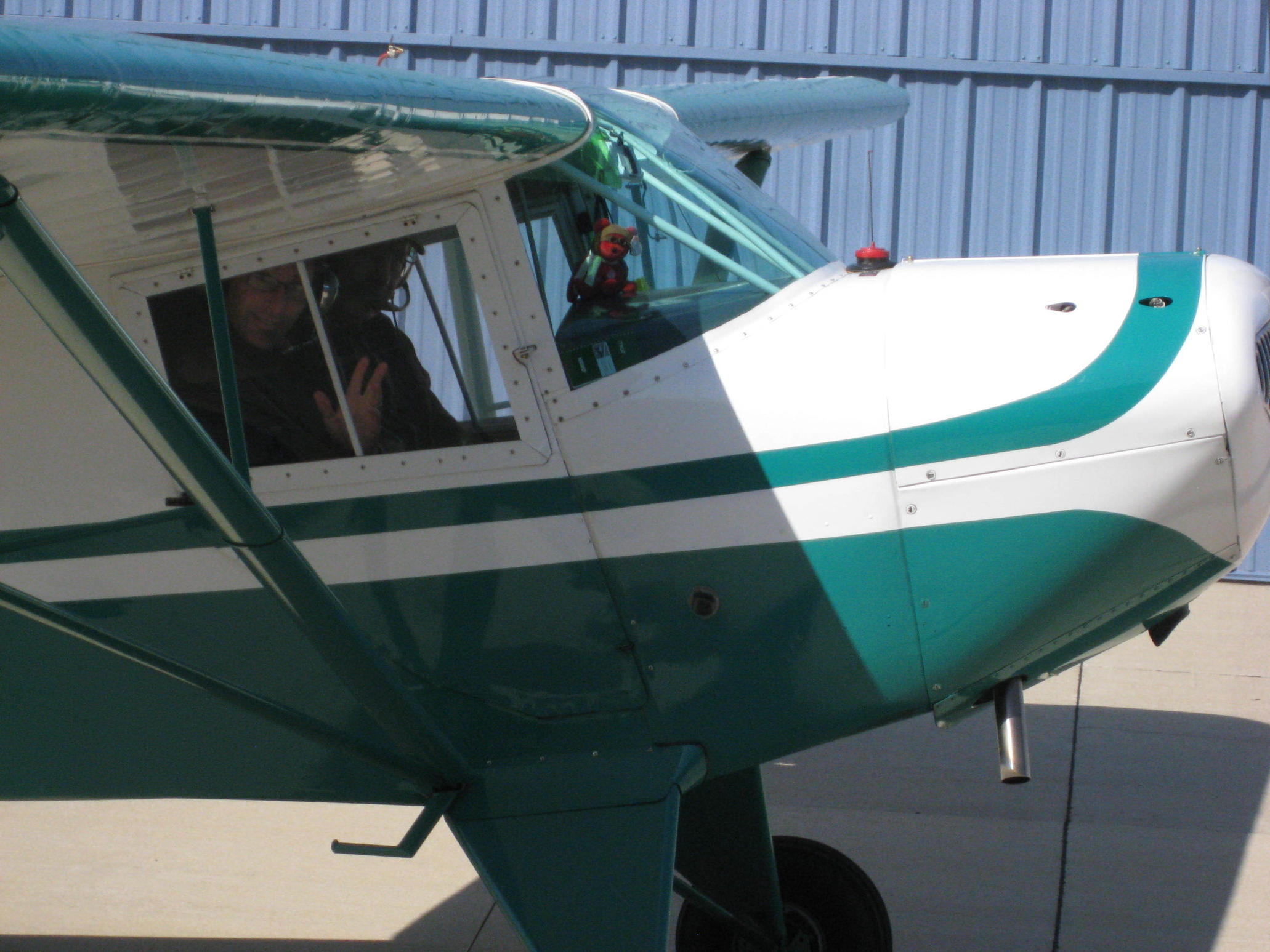

NO COWL BUMPS with C-85
  • #31
    Jim I forgot to add that no other modification was made to the lower cowling.

        Jim, found a close up of the cut out option.
        If you zoom the rear cutout is just for the bend in the harness lead. So if you had a shorter plug you could probable eliminate that rear one. Maybe put an Ercoupe cup on the front plug and no cut out or bump is needed.

          Thanks, yes we are going to check out a no bump option. As well. The 0200 may fill it up a bit more but any way will check to see if we can go without the bumps.
