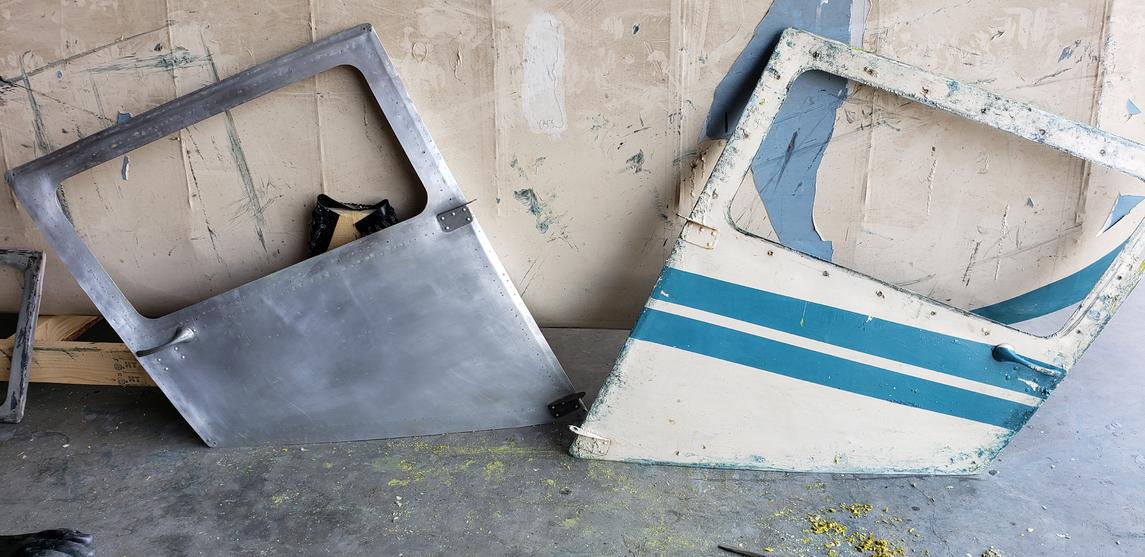

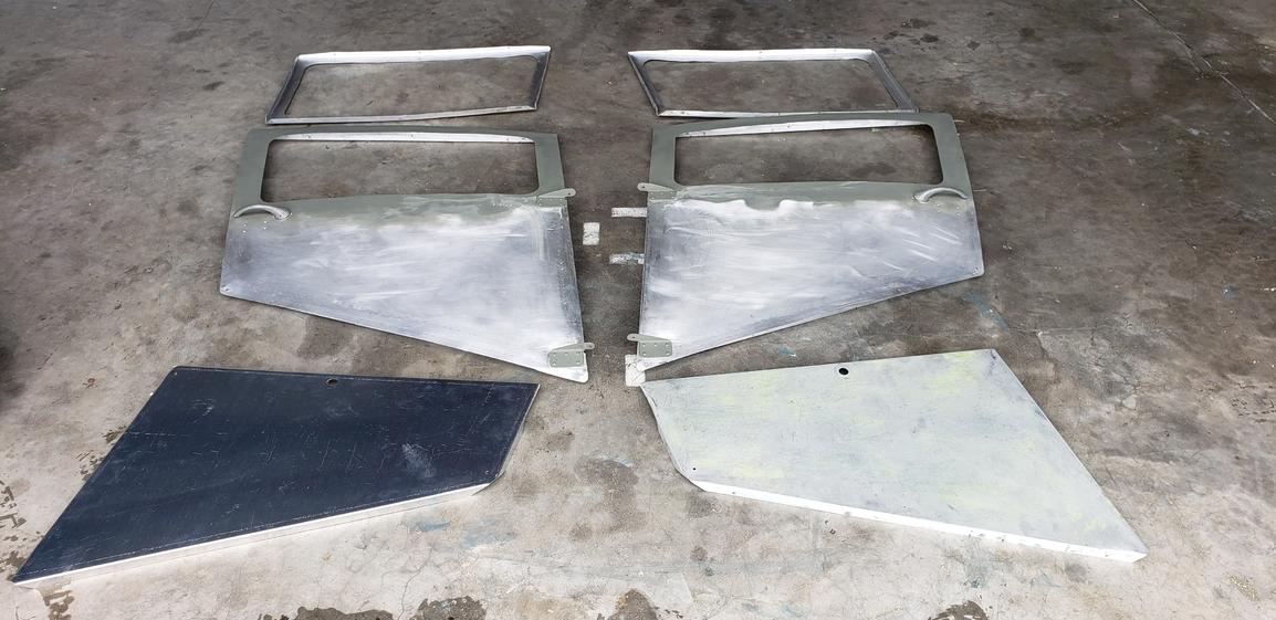

    Ok doors have been completely stripped inside and out. Had a new interior door panel made(old one had stress cracked in a corner) door handles for inside found(Mike Redpath thanks) and stripped . For interior door handles someone had fabricated a female collar to slip over orginal male mounting sleeve to enlarge it for some sort of early car door handles) . Then for more raping some ideot had drilled holes in the door panels THROUGH the doors to hold solid windows (thank God they did not drill through the interior frames). I decided not to reskin the doors as they were otherwise very straight and nice. Instead I used flush rivets in the holes and smoothed over with a dab of micro balloons. Before and after pictures attached.
    Now onto making new sliding windows. I do have patterns for the metal edges that will mount to the new Plexiglas as wellI have patterns of old windows (Thanks Hank Jarrett)

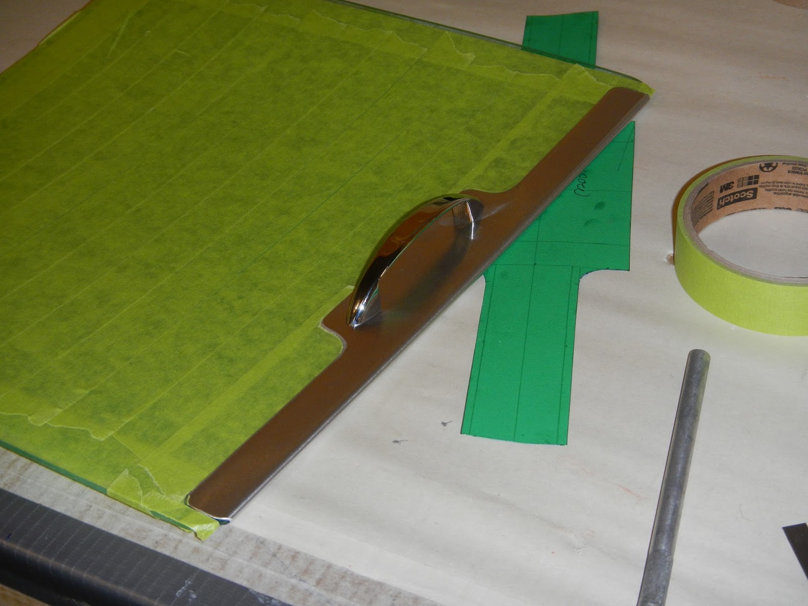

        This is where I ended up
        Home depot.
        I don't think I ever found a photo or drawing to nail down originality.
          Scott,
          That was my next step. I have seen similar over and over again BUT never nailed a verifiable original. Plain and simple is what we have.... about what they were working with back in the day as well I suppose.

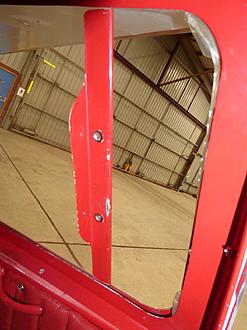

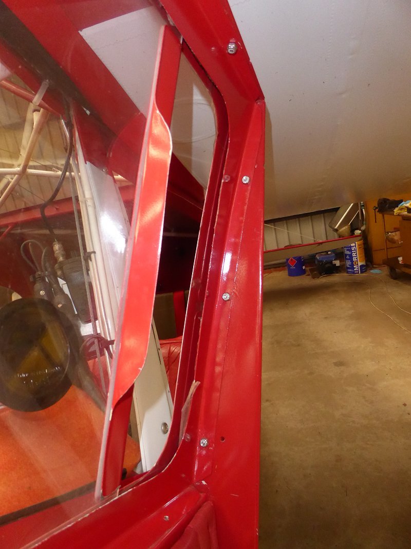

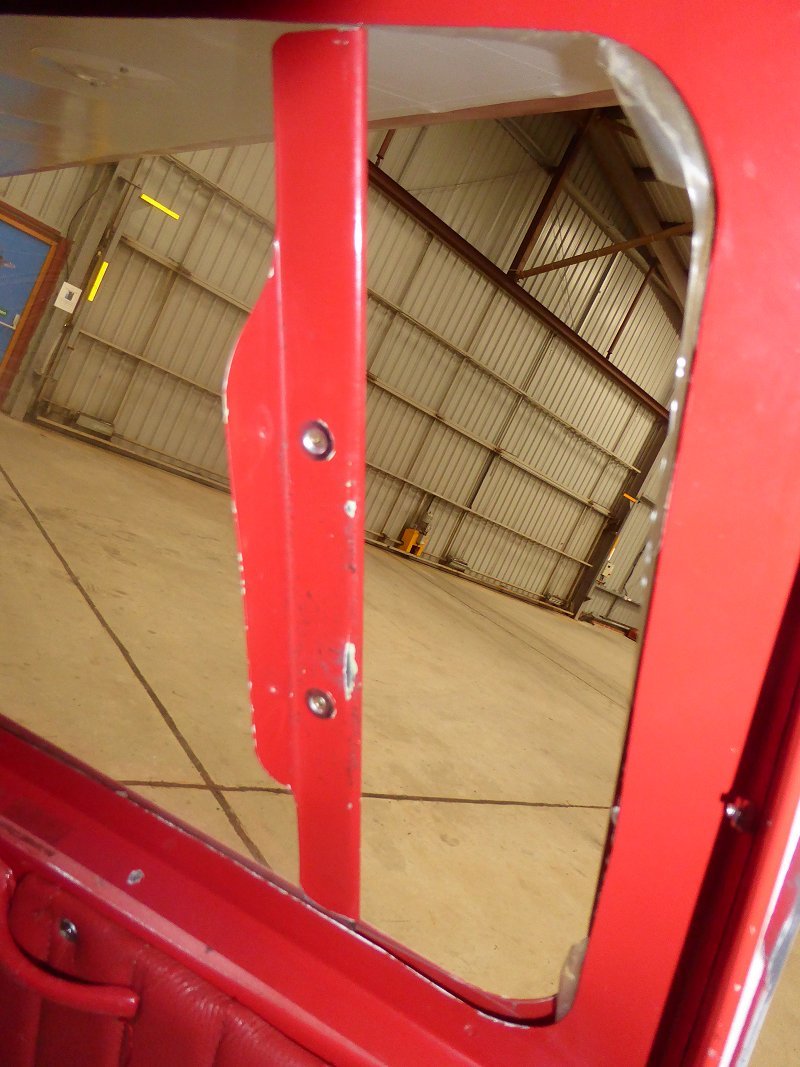

            Mine is similar to Scott's, but without the hardware store handle:

              Rob,
              Interesting. Looks like the broader part of the frame was simply bent out 90 degrees to make a pull.

                That is what I have seen on most the ones I have had
