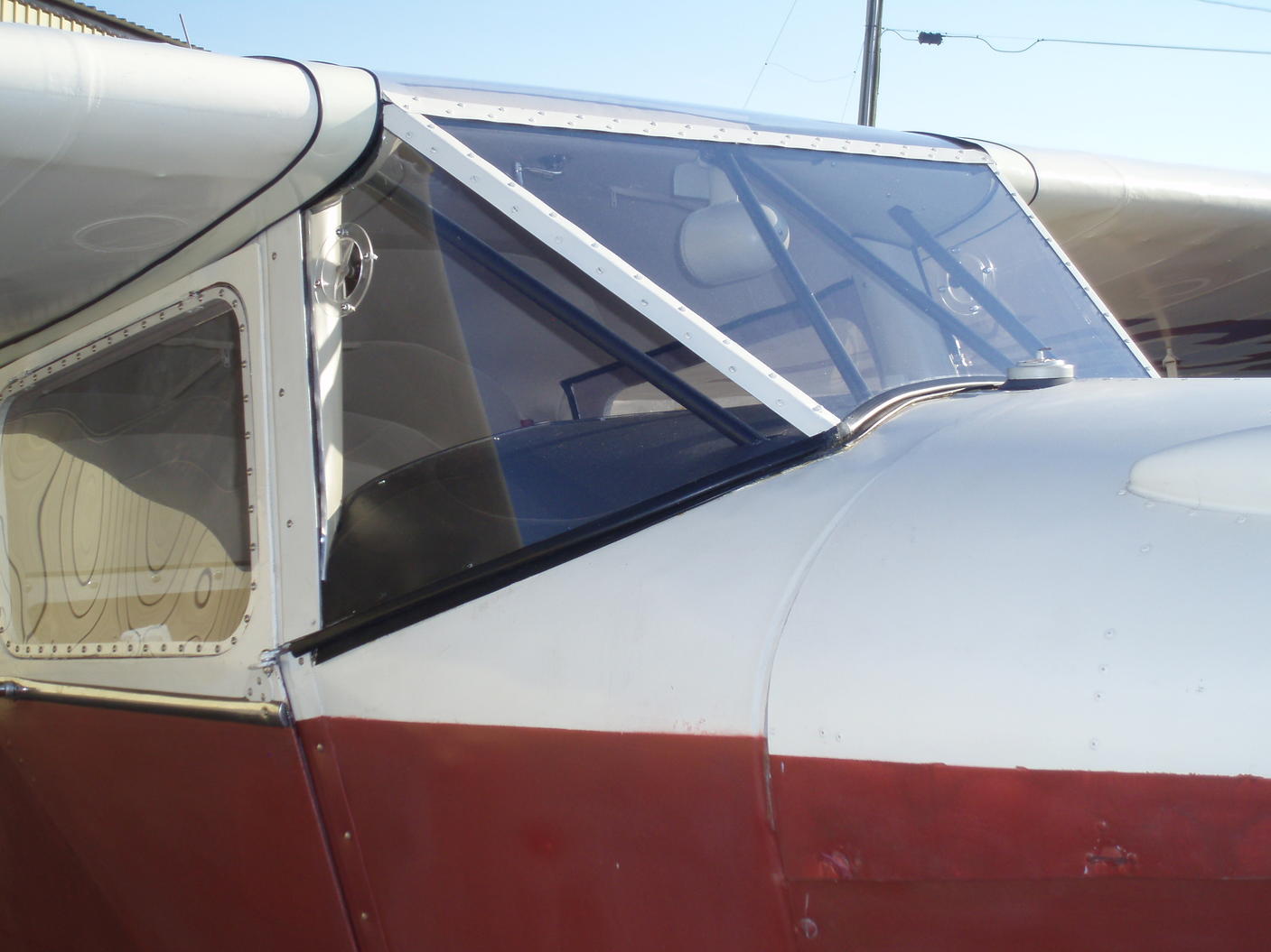

            Get LOTS of practice putting vents in cheap Lowe's aviation plexi before even THINKING about cutting your windshield. The factory put them in the aft top corner of the windshields, but they cut holes in HUNDREDS of windshields. You have ONE SHOT! You wouldn't believe how many times i cracked a piece of plexi putting mine in. My only advantage is I have a 41 and they had 4 flat panels, not a single blown windshield. I bought a LOT of plexi before I got a good piece (must have been plexi defects, COULDN'T have been MY skill!) ;-)
            Last edited by Hank Jarrett; 06-25-2021, 07:21. Reason: Added photo of 4 piece windshield.
