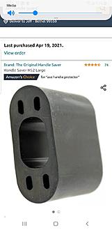

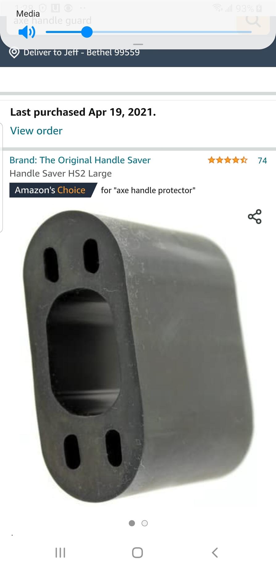

              I ordered some from Amazon not too long ago Click image for larger version

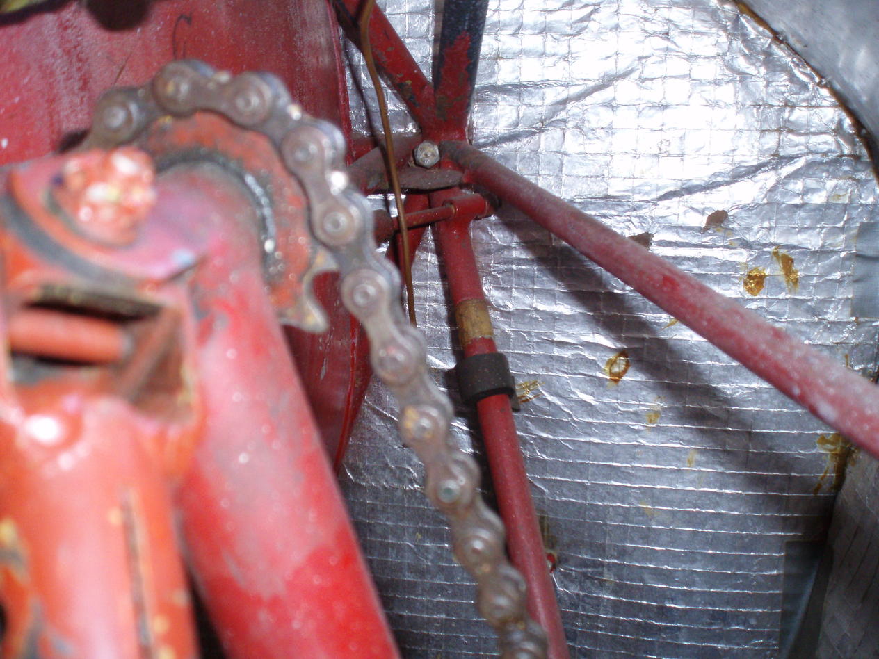

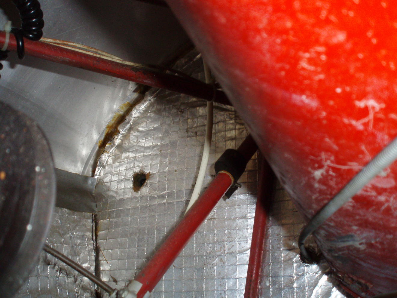

                  Anybody have any pics of the column bumpers installed?
                  Thanks,
                  Bruce
                  • #84
                    Little rubber thing on the tube in the center of the first photo and to the right of the chain in the second. May not help much, it is kind of hard to photograph in place.

                      As an aside (and continuing the slight thread drift), there is a lubrication hole on top of the control column where each shaft passes through the "H" frame. Hank's pictures above show the general location; between the sprocket and the universal joint, I think. There is a "screw" channel machined into the bronze bushing to allow lubrication oil/grease to lubricate the approx. 1-inch length of the bushing.
                      This should be part of everyone's annual lubrication schedule. Unfortunately, it's very difficult to access without removing the coaming between the instrument panel and the windscreen, unless you are a contortionist.

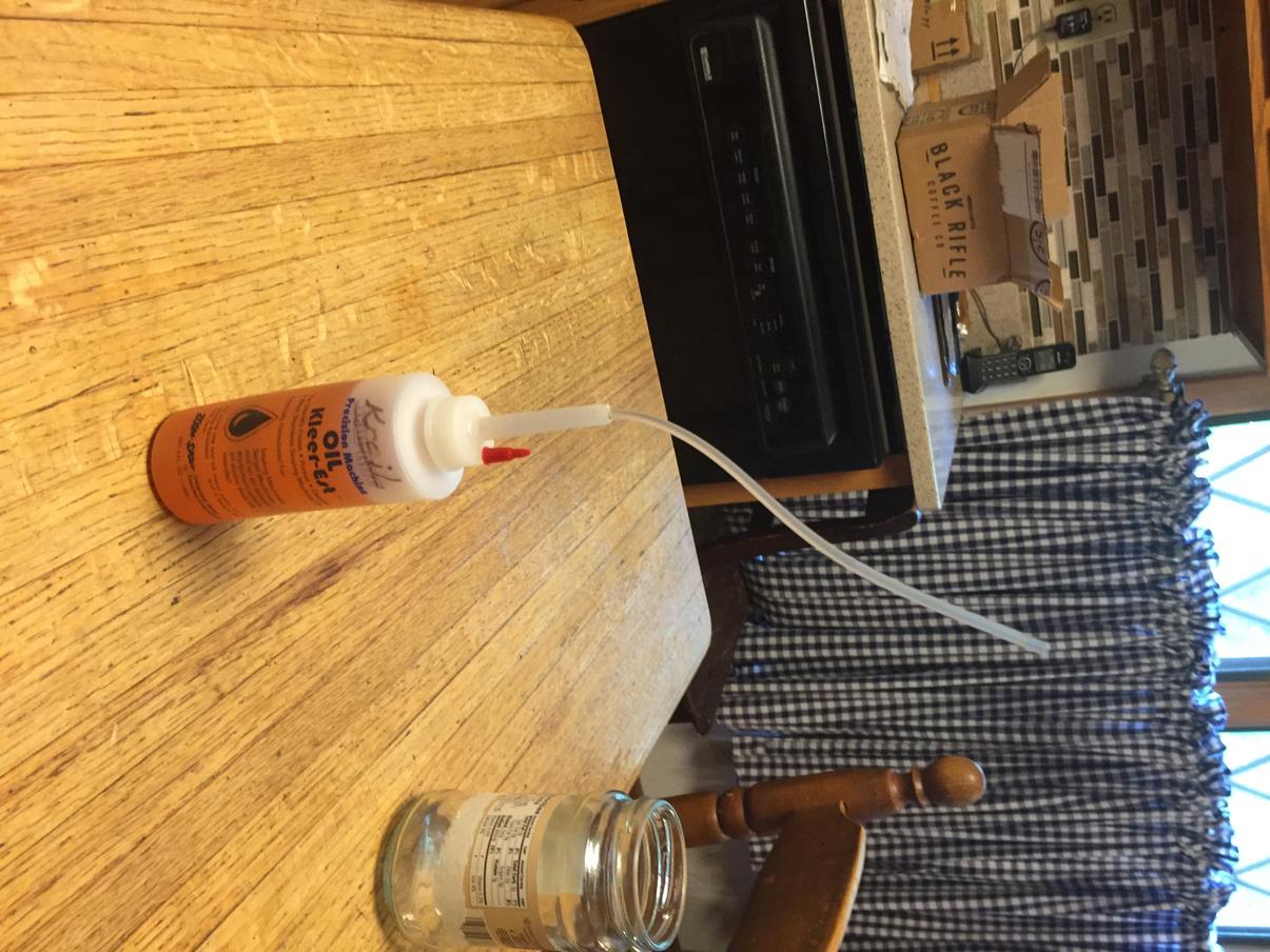

                        It is almost impossible to "see" the hole but if you check at a sewing machine repair shop you can get one of these. It has a tube that can be pulled out and put in the oil holes to put a few drops in. Put something down below to catch the oil when you think the oiler is in and it isn't. Can make kind of a mess. I have this one filled with KROIL which is why I have the jar. That oil seems to be able to climb walls and spread out over everything. I keep the oiler in the jar to contain the oil. Best oil ever for anything you need penetrating oil for. At $100 a gallon it SHOULD be! Click image for larger version

                        Not sure why my PC randomly rotates some photos! Every time I turn it the PC turns it back. The little red cap is placed over teh tube and does a pretty good job of keeping the oil IN the oiler.

                          Those are not the same as the ones I bought...
