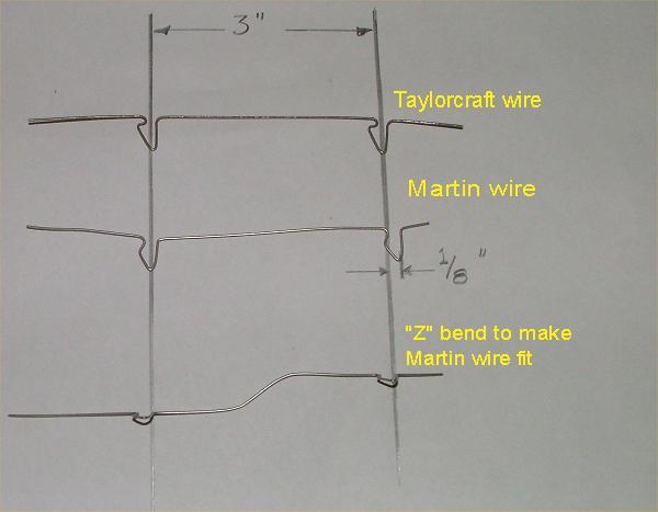

      Can you give them a call on Monday and see if they could make it? This is a drawing of the Taylorcraft wire (I didn't take it, but it is the best one I have) WITH a piece of Martin wire showing how they are different. I can get a sample to you (or them) if they think they can make it. The Martin wire is PITA to use!
        I will do that. !
          Could someone please edit a second picture from the one Hank sent ? Would like to remove the aircraft referance names and simply state right as in the Taylorcraft wire and wrong in place of the Martin wire.. folks do not like making aircraft stuff.... This is indeed an owner supplied part. !! Will see how much needs to be purchased.
            I think Skip made that drawing/picture. Skip, you around?

                        Mark, So the lower drawing is of the Taylorcraft Wire? Looks about like it is. Just want to verify. Thanks

                          That's my photo, if that's what you mean, and I'm very happy for it to be used.
                          I'd be very nervous using a drawing (as Mark posted); it would be better to reverse-engineer the correct Taylorcraft wire profile.

                            I may be wrong however I believe that the PDF Mark sent is an engineer drawing taken from an actual Taylorcraft wire. That is what I am asking Mark for clarification. It sure looks like the drawing needed to make the Taylorcraft wire. If it is I am sending it to the MFG company for further discussion. They have agreed to take a look.
                            Jim
                              Hank , Have not heard anything from Mark. Please look at the engineering drawing Mark contributed . It looks to be spot on. I have been in touch with the Mfg wire guys and want to move this along asap if possible
                                That is why I offered to send a section of original wire to whoever can make it as well as a section of rib to test fit it on. NOT a great idea to buy a bunch of wire that is the wrong spacing!!!
