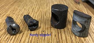

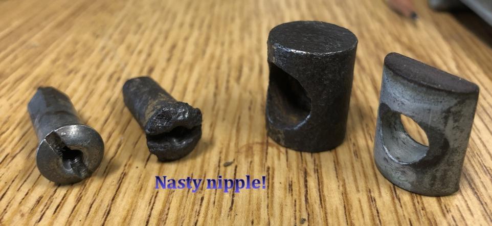

    It's been a struggle to get the tailwire nipples (A986) and inserts (A4002) apart on Terri's project. Soaking in WD40 for a day, then several hours in lacquor thinner and finally, with much effort, one pair was separated only to find the nipples looked nasty with rust. This plane must have been sitting outside in the coastal Maryland conditions for years, if not decades.......Light surface rust is one thing, but this is to the point that the shoulder on the nipple is diminished severely. So, I shuffle through my spare parts bins and come up with a suitable replacement for the first couple of the sets. Then I check out the parts catalog and see the note "when replacing nipples, inserts must be replaced due to the different size (from original)......"
    I have yet to see any different size nipples, or inserts. So when were they changed? That parts catalog note is in both the Alliance catalog and the Lock Haven one. Anyone know what's happening here?
    Speaking of inserts, when did the factory go to the "full barrel" style inserts as Terri came with? was this a Conway, PA thing or did Dorothy continue with that style when the F19 came out?

      The originals are rolled threads, the aftermarket stainless versions are cut threads and the two are not interchangeable.
      I believe there is a company in the UK that can supply the original thread and there is a post about it on here somewhere.
        I think Scott is right, but I was told i didn't know what I was talking about years ago when this discussion came up. When I looked at my old tail wires they ALL looked like rolled threads to me. It is all that I will use, but I gave up trying to convince those who were making their own from cut thread stock. You DO NOT want to chase rolled threads with a die! It creates stress risers in the base of the threads that start cracks.
        Those who "know better" will do as they please, but I won't use cut threads in place of rolled. Kind of like rib stitching stamped ribs. The discussions seem to always turn into arguments. If your mind is already made up, just scroll on.
          Yep, the ones from Scotland are about $200 each, Burls aircraft can supply stainless ones if you send him the nipples and the lengths you want.
            OK, I haven't been through this discussion............ how are they incompatable? My new stainless wires from Wag Aero do fit the old nipples beautifully after cleaning them up with the 8-36 tap............ Are Wag's nipples made differently? I get the cut (V shaped bottoms of the threads) vs rolled (U shaped bottoms) thread thing on the wires, but is there a difference in the tap operation too necessitating a special tap to make the nipples match the rolled threads??

                            I bought a set of stainless nipples from aircraft spruce. My original wires were fine, but nipples were suffering from surface corrosion.
                            I actually had the tail feathers in place for final assembly but the stainless nipples jambed a couple of turns in on the stock wires. I did a quick media blast of the original nipples and installed them without problem.
                            This year I dismantled the wires to try again. Threads are simply not compatible. I ended up cleaning up the original nipples again and electroless nickle plated them. Happy with the result.
