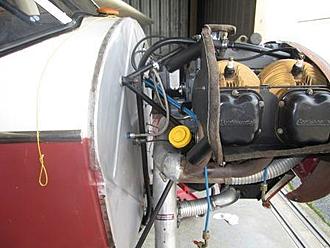

          Looking for he drawing of the elbow mod now. You also want to run the breather tube OVER the cylinders, not under. It allows the droplets of oil to drain back into the case. Note in the photo there is a piece of high temp hose from teh elbow to the piece of black painted aluminum tube. That tube goes from the elbow to the hose and clamps in front of the aft engine baffle. THE next piece of aluminum tube runs from the bottom of the cowl/firewall up and curving forward and through the aft baffle. Easy to take off and service and angles DOWN to the elbow even in a three point attitude. Nice use for one of those extra holes in the baffle! Click image for larger version

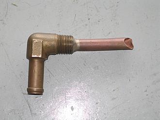

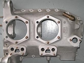

            Found this photo in Harry's book on Continentals. Not the orientation of the end of the tube and the bend in the long edge. This Click image for larger version
Name:	Crankcase breather elbow mod.jpg
ID:	184824 is important as well as you need to BRAZE the parts, NOT SOLDER!!!! The second photo is of the angle on the case. Again,from Harry Fentons book. If you do this mod you have to be SURE the extension doesn't interfere with Click image for larger version
ID:	184825 the engine internals.

                        This is not a good modification for cold weather...it freezes the line
                            Yes, but the freezing can be minimized. Cover the exposed elbow and hose (no metal) with common water pipe insulation, or better yet aviation approved insulated firesleeve material (https://ph.parker.com/us/en/high-tem...eve-firesleeve). Keep the hose close to the crankcase for warmth (glue with high temp RTV). The hose can also be run back then down between the front and rear cylinder bases close to the case. I've had both - full run like Hank's with breather mod and between cylinders. The latter was done last on my PA-11 after the full run was tried before overhaul.
