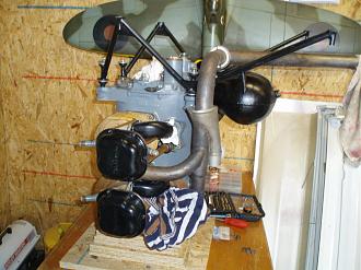

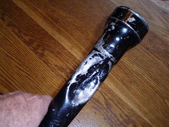

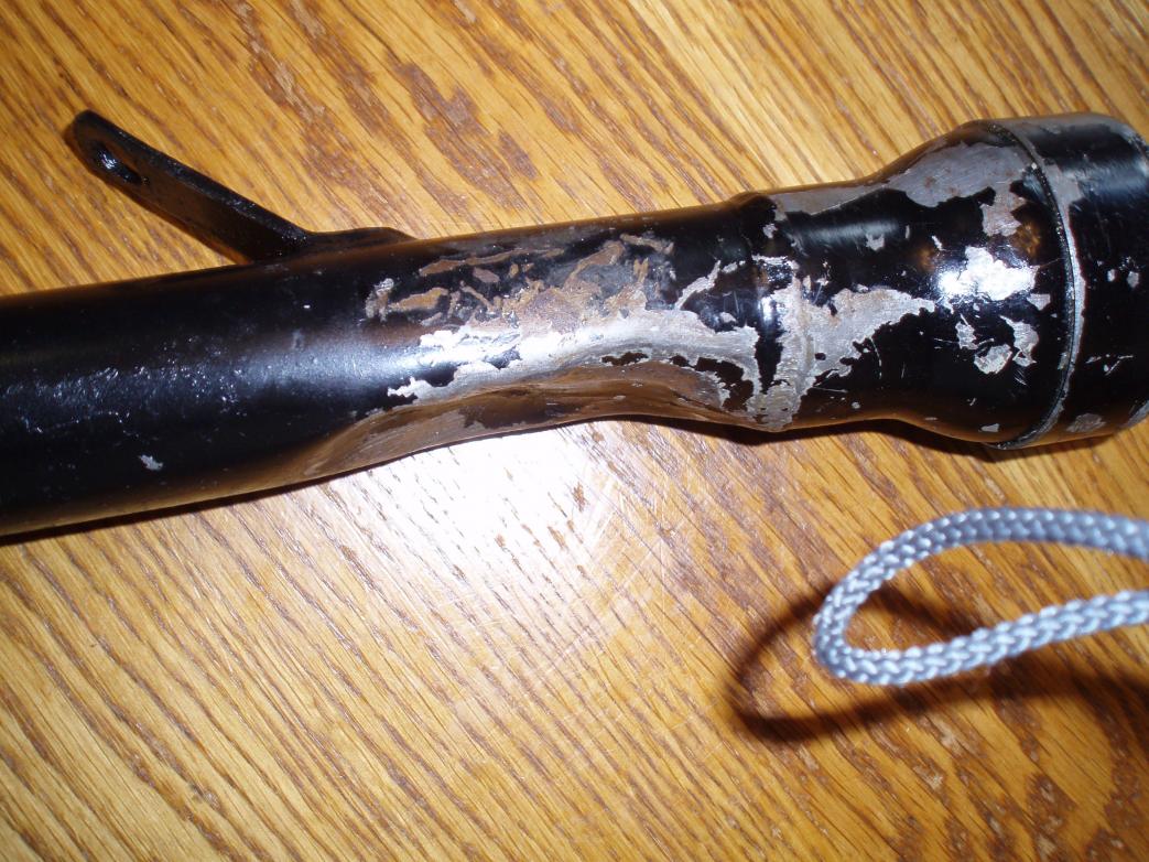

                  I smoothed out one that looked like it had been used to break up concrete. Lots of dents and flat spots. Work it slow and easy and DON"T WORK HARDEN IT. You will need to make a couple of bucking blocks to go inside to bump the dents out. First one is straight to get the ones you can see through the neck. Then put a little bend in the rod so you can rotate the tank around and get the ones just outside of view through the neck. You just keep working your way around tapping each dent out till it is smooth again. You will want to make a flat steel plate for he flange with a hole for the tool first so you don't distort the flange where it hooks up to the bottom of the engine. Takes time and patience but not much skill. Be prepared for a few tears or holes to weld up and don't warp the flange. Probably would have been FINITELY easier if I cut the neck off and just welded it back on after smoothing the dents, but some things you learn by doing it the dumb way the first time. The neck on mine was also crushed when I started and that would have been a lot easier to fix OFF the tank! Looked through my photos and can't BELIEVE I didn't take a photo of the tank prior to starting! Only found two of the neck as bought. First photo is of Click image for larger version
Name:	3 side with mount, exhaust.JPG
ID:	184430 the tank AFTER repair. Click image for larger version
ID:	184428Click image for larger version
