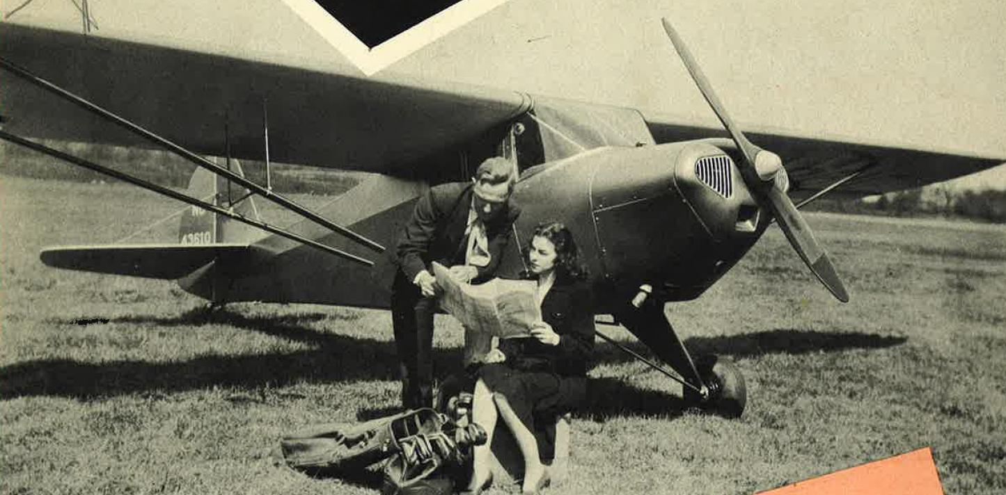

                  Here's a pic (second image) from a Spring 1946 BC12D ad that shows both the sliding side windows, and air vents in the upper aft corners of the windshield. We need to assume that they used a current aircraft in the photo shoot!

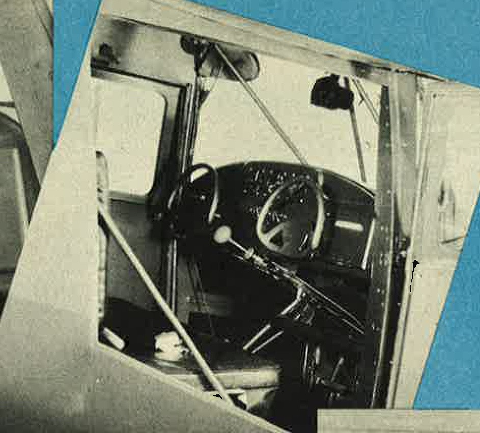

                  The first photo, from the same ad, shows the "larger" doors, metal door frames and some other points of interest, like absence of interior trim, exposed aileron pully, left aux tank, and some kind of contraption under the panel extending below the seat.

                    So the plot thickens. Note the picture indicates NC 43610. It has metal door frames ,or so it appears.(frames on the fuselage for those confused) Our family Bird (a little bit later in the 4300 series) does not. Also shows fuel valves for the wing tanks as the same over the doors. ALSO and very interesting to me anyway it still has the 1945 style cowling attach...meaning no trunk latches HOWEVER yes the larger aluminum doors. Yikes.
                      I have one just a little earlier than this NC43328 with big doors Dzus cowling fasteners. To be fair though, I don't think the cowling is original..
                        Trunk latches came after May of 1946 when stringers, door frames etc... were completely converted to aluminum. I have seen the copy of a factory directive to employees at Forrest's that stated the change. Dzus fastners for the cowl on a March BC12D would in fact be correct. My door frame has an aluminum fairing that covers the front post were the front of the door presses against it creating a flat surface. I am NC43754 by the way, March 29th. And there are those golf clubs again!
