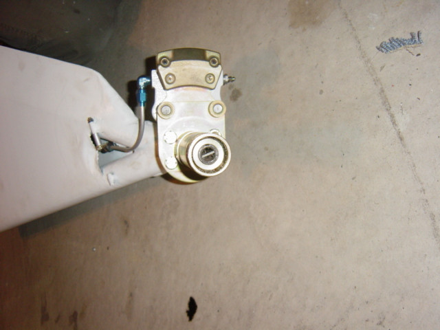

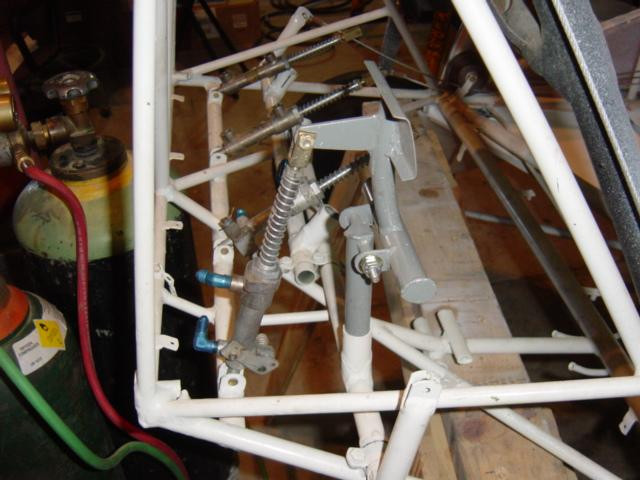

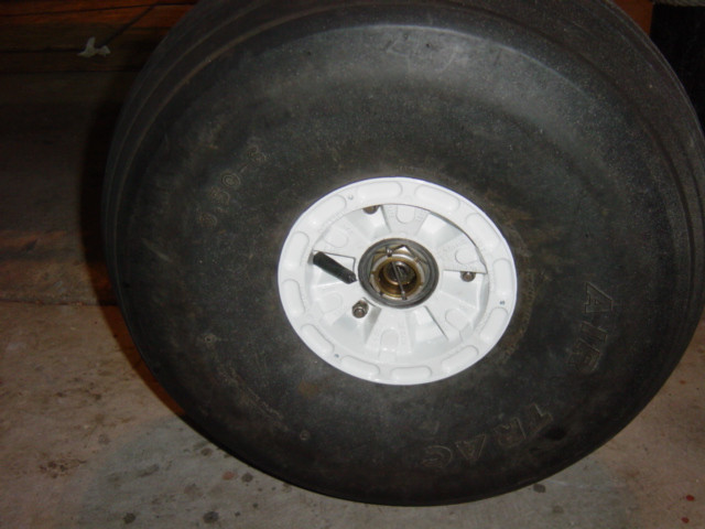

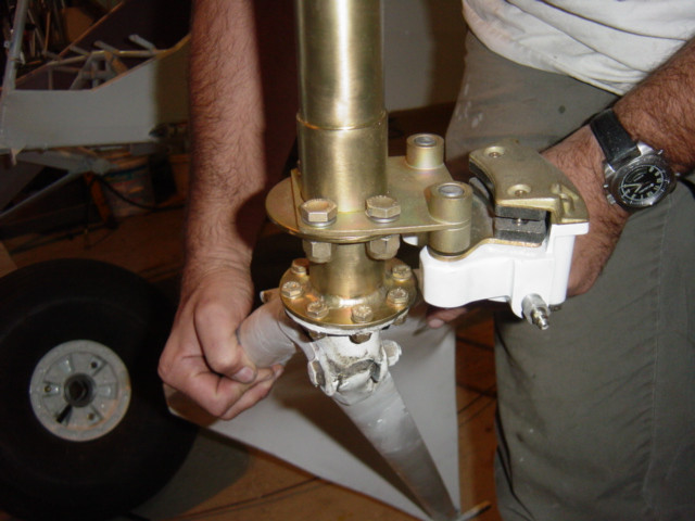

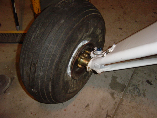

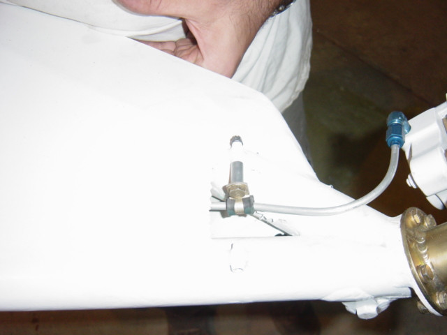

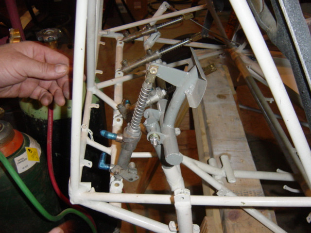

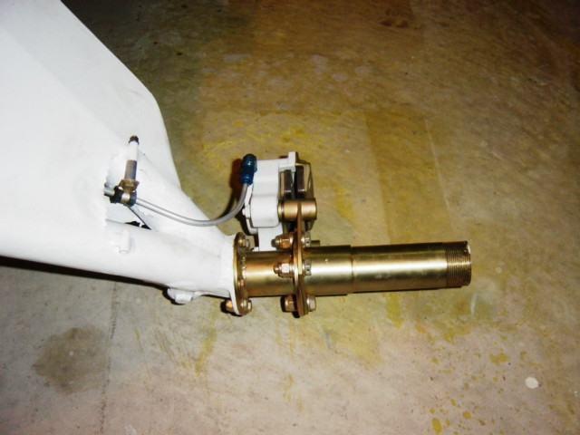

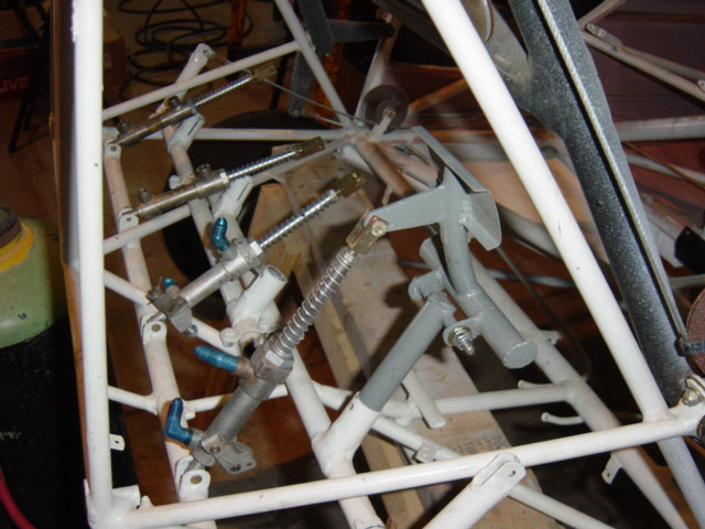

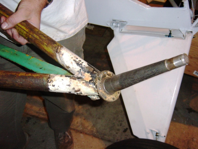

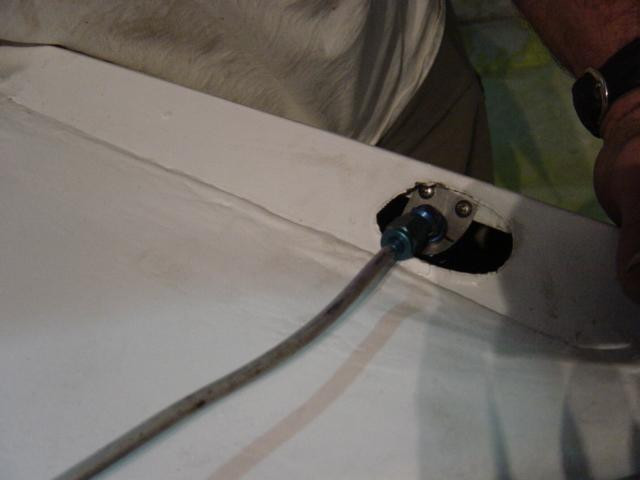

      I sent you pics of mine via email...and it is an excellent modification. Click image for larger version

ID:	180824 One here scroll down: http://dc65stc.blogspot.com/2015/10/...fications.html

              Because that's what I like. I have always liked the feel of the Cessna toe brakes.
                Don't "feel" them too hard! They look like they would be a LOT better than the cable brakes that were original. You might be able to accidentally do an outside loop landing and put her on her back (or at least blow out the tires when you stop the wheels and slide)! Your new brakes look solid enough to easily overcome the elevator on landing roll out and put you on your nose.
                I like them, but would use them VERY lightly! Then again, mine barely hold for a run up. ;-)
                  Our F-21 had Cleveland's and factory toe brakes. Loved it, and got me out of some trouble a couple times. Like everything you have to respect the airplane and know its limits.
                    The sensitivity of the toe brakes may be adjustable. Adding a spring over the master cylinder plunger would increase resistance (see Tim's pics above). Altering the toe piece to cylinder plunger geometry may do something similar. I'd make sure when landing there was no potential pre-loading when the rudder portion of the pedals were pressed. Setting the upper pedal angle versus toe position can correct for that somewhat in my experience.
