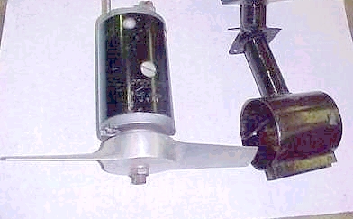

                              This is the original wind generator as used on the 41 to 46 (could be longer, but my 41 and 45 have this listed as original equipment). If you check out teh part number it is the same as an Evinrude outboard motor generator. The aluminum cast props were known to throw blades if damaged and I know the same generator is on a Fairchild that was at the Va, Aviation Museum in Richmond for years. When you throw the field generator switch to turn them on they make a LOT of drag!

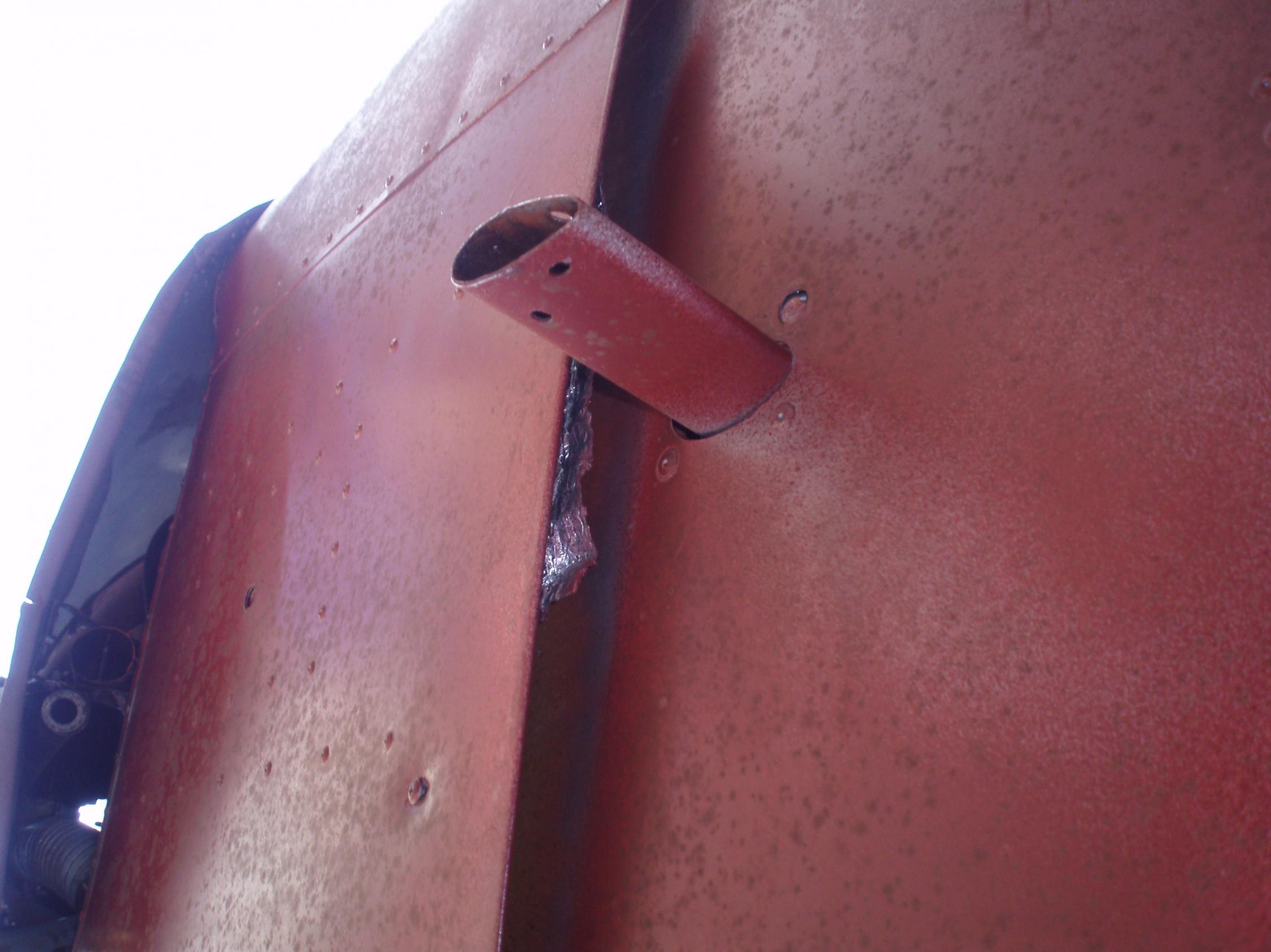

                              The second photo is the factory pylon on the belly the generator attaches to. I have a copy of the wiring diagram in the "files" somewhere.
                              The pylon is a real head buster when you crawl under the plane!
