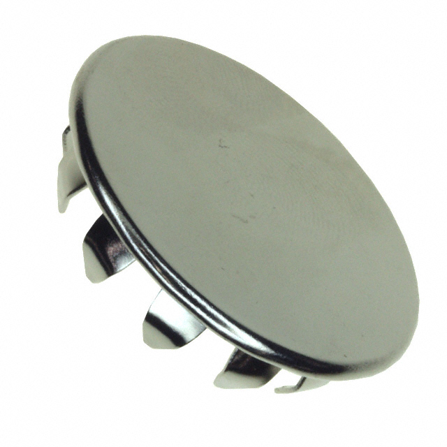

                  These can work but some like a screwed on metal patch: https://apexfasteners.com/fasteners/...s-plug-buttons Commonly found in the hardware section of most stores that sell things for home and cars.

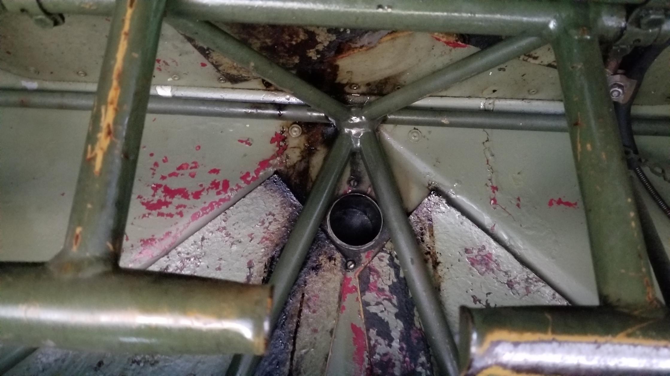

                    Ran out to the hanger this morning to take a look and see what I could do. Well I feel like a dumb-dumb because the hole I was referencing is indeed where the cabin heat comes in. Upon further inspection, I'm not positive that is where the oil is coming through. I did notice that some of the gaskets around the various cables passing through the firewall are pretty shot so I could be getting some there. I didn't have much time to tinker with it so I dig into it more this weekend.
                    Here's a picture just for reference. It looks like it's coming more from the right side, but that is the grommet that was in the worst shape.

                      Re: Oil in Cabin
                      Sorry, Not sure why the picture came through upside down.

                        Re: Oil in Cabin
                        The picture came in up side down because that is how most of us have seen it! Standing on our heads under the panel and tank. ;-)
                        I think I would start by plugging up the heater outlet since I doubt you will need it much this time of year and see if the problem goes away. I would NOT delay fixing all the other firewall penetrations regardless and I would NOT put off fixing the the heater leak if that is what is doing it. If the oil IS coming from the heater muff that could mean a leak in the exhaust system which would be bad in two ways. First you would have exhaust coming into the cabin and second your valves would be blowing oil! Both are BAD!!! Problem is getting he heat muff off without taking he engine loose from the mount is almost impossible and you don't want to do it if you don't have to, but if you do suspect an exhaust leak, YOU HAVE TO!
                        Be safe and first step is to clean up the firewall and look for the source of the leak. When I started to get oil on my shoes it turned out to be a tiny leak at the oil pressure gauge that was running along different things under the cowl and finally dripping on my foot. The oil may NOT be coming from someplace obvious.

                            Just an observation. The insulation/sound damping material on the firewall and floor board has been there a while, looks like linoleum (maybe cork). It also looks saturated with oil from a leak that has been there quite a while.
                            It is flowing down from the top of the picture. You might start with the oil pressure line as it penetrates the firewall, then up hill. Looks as though it is running down both on top of and behind the dampening.
                            It needs to be taken out of your cabin, take it out before you start chasing the leak. Other than the weight, smell and hazard, it can mask the leak source.
