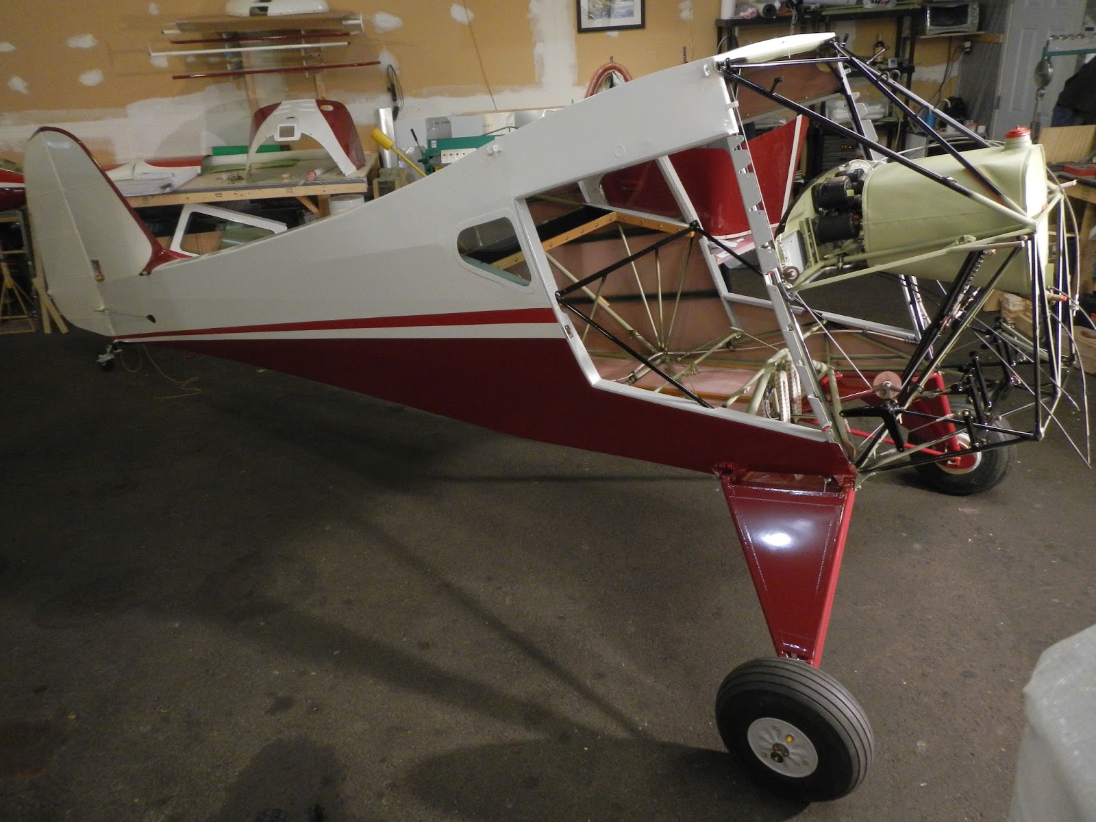

                          Here's a photo without the boot cowl. You can see the shape of the tank is such that there is no unusable fuel from the main tank in the air or on ground.
                          Wing tanks however need to be in flight attitude for all the fuel to be usable (hence the placard).
