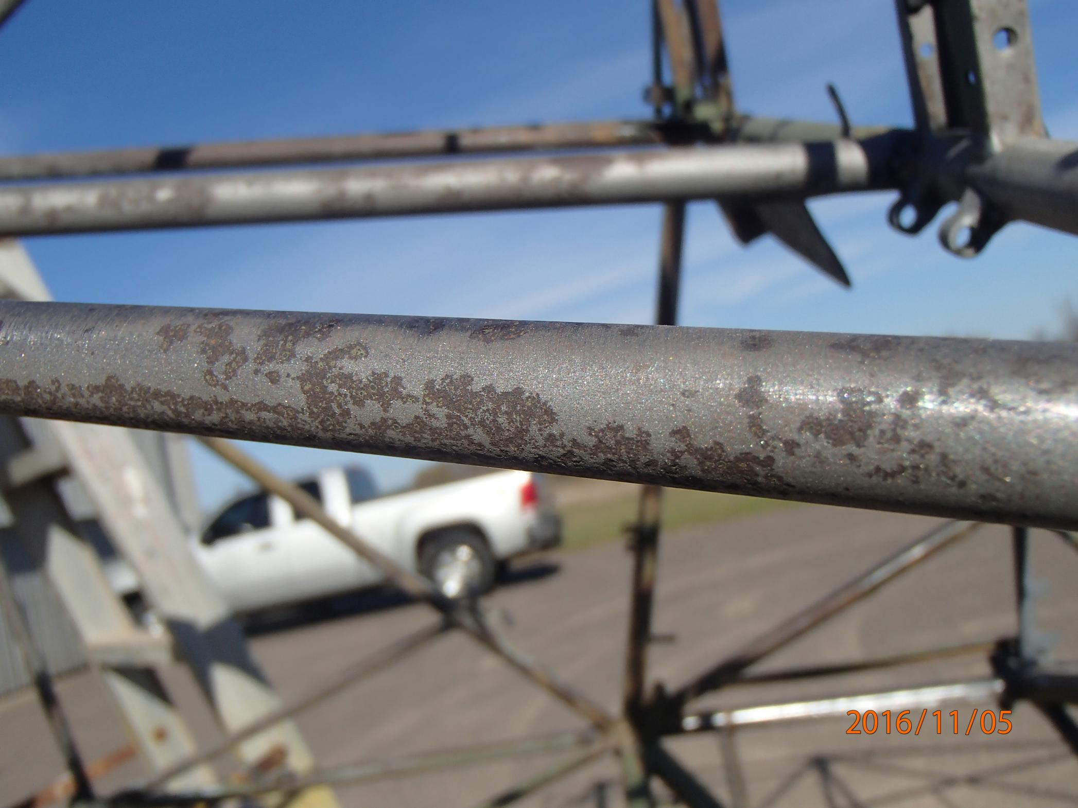

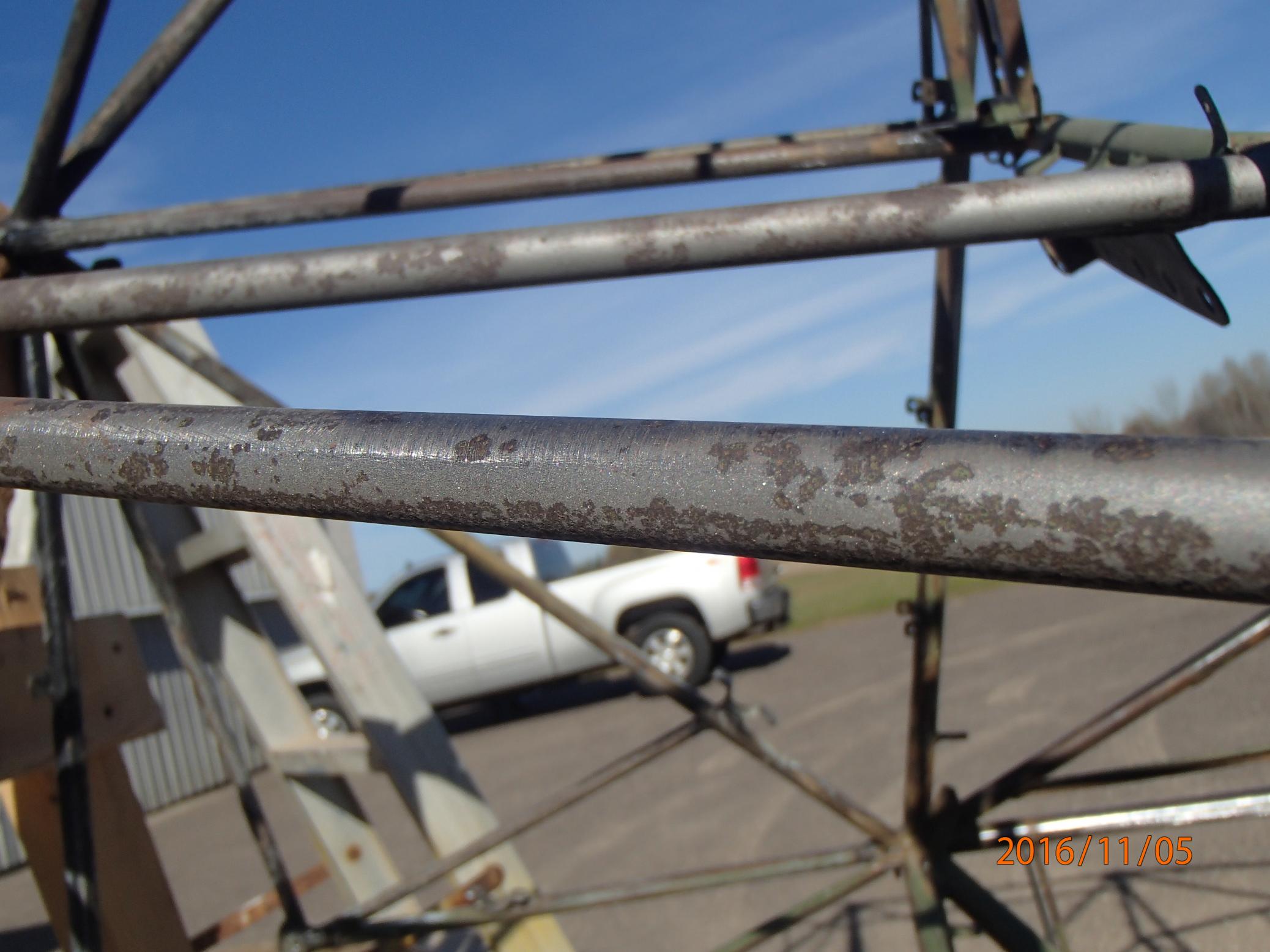

              We tried blasting the fuselage to remove old primer and paint (possibly original).
              Process took a lot longer than we thought and we did not finish. Got a lot of front of the fuselage bare, but ran out of time, so applied a temp coat of spray can primer. The back half was done by hand before and covered with a temp coat of spray can primer at that time, it is still that way. I have read concerns about blasting being too aggressive, our system may not have been aggressive enough. The old primer (green zinc cromate??) and paint was slow to come off and underneath there were spots of black, which we assume is corrossion that needs to be removed. See pics. The black spots took a lot to remove, and we just worked on removing the primer/paint leaving most of the black spots.

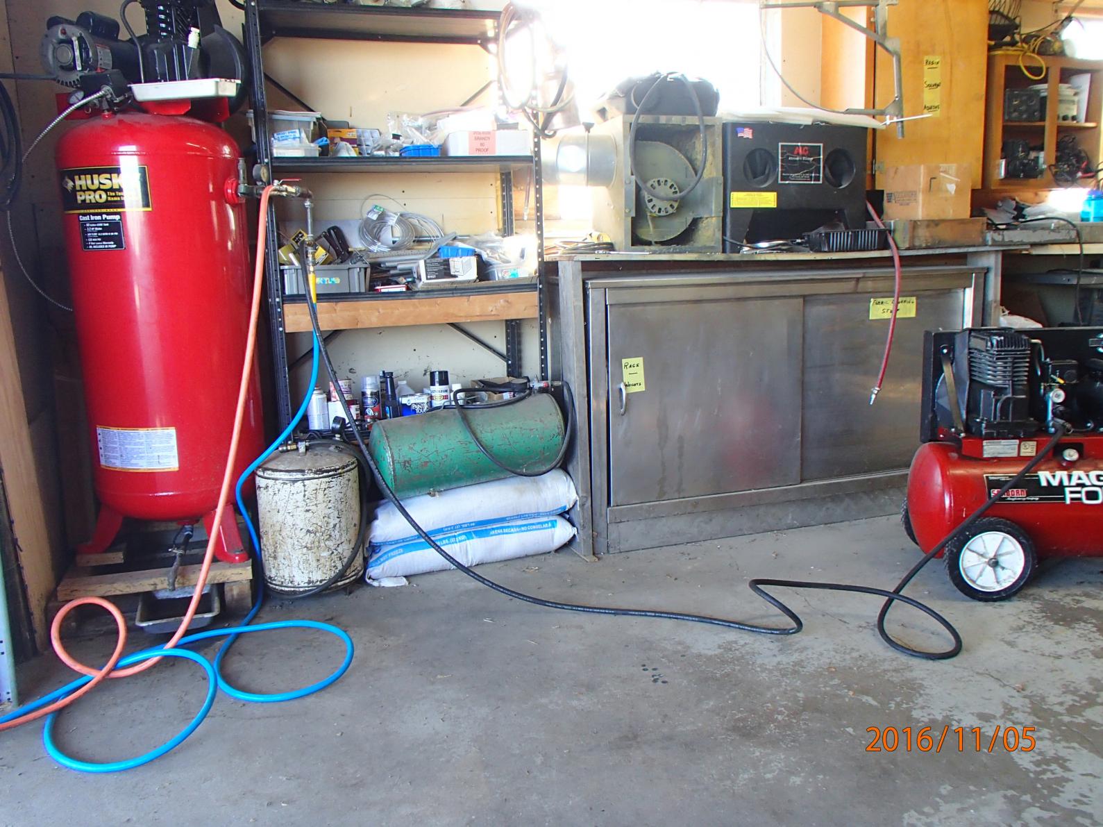

              - We did not have a problem with air supply, see attached pic for our air compressor setup. I do not know the size of the larger compressor.

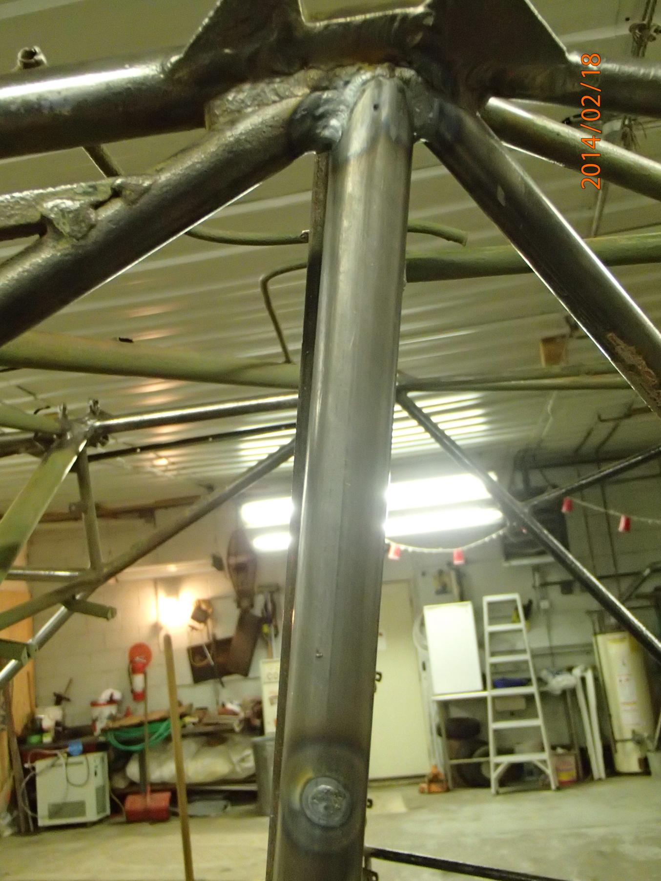

                  Good quality pictures! Black spots certainly look like corrosion. Your blasting media looks adequate, because it has turned the good metal grey, and it may be rough enough to pick lint off a cotton cloth.
                  It is possible that you are not spending enough time on eash tube (and I know...it took me four weekends of both days = 8 days) to do mine.
                  I blasted a section, then sprayed with two-pack etch primer. Next weekend I blasted the next section and sprayed that.
                  At the end, I went over the WHOLE fuselage again, but very lightly, to remove the previous weekends worth of etch primer (it is hygroscopic) and then re-etched and epoxied all in one day.
                  4 hours is the recommended max time for bare metal, but it depends how humid your location is.
                  Next time, I'd pay someone else to do it!

                    there is no easy path, but you can save time by using a good paint stripper first. Clean Strip is usually available at hardware stores. I have not had success with the water-based products but others may have.
                    Looking at the photos makes me ask what size media you're using. I recommend 80 grit aluminum oxide. I understand that many people use silica/sand based media but the residual sand promotes corrosion.
                    Yes the black is corrosion. 80 grit should clean it off, but again you can let chemicals do some of the work for you. Stripper, scraper, corrosion remover and then media blast. Remember the media blast works on about 1/2 square inch at a time whereas stripper will slowly work on a relatively big area all at once. After stripper you'll see the blasting goes much faster.
                    Make sure you air hoses and fittings are adequate inside diameter. Also long hoses cause problems... drag increases at the square of distance in a tube. Install a gauge at the gun, you may be surprised to see less than half the pressure you have at the compressor.

                      I don't see a water separator on your air compressor rig setup. Water in the line can cause the dark spots also.
                      Really need a great water separator for blasting and painting.
