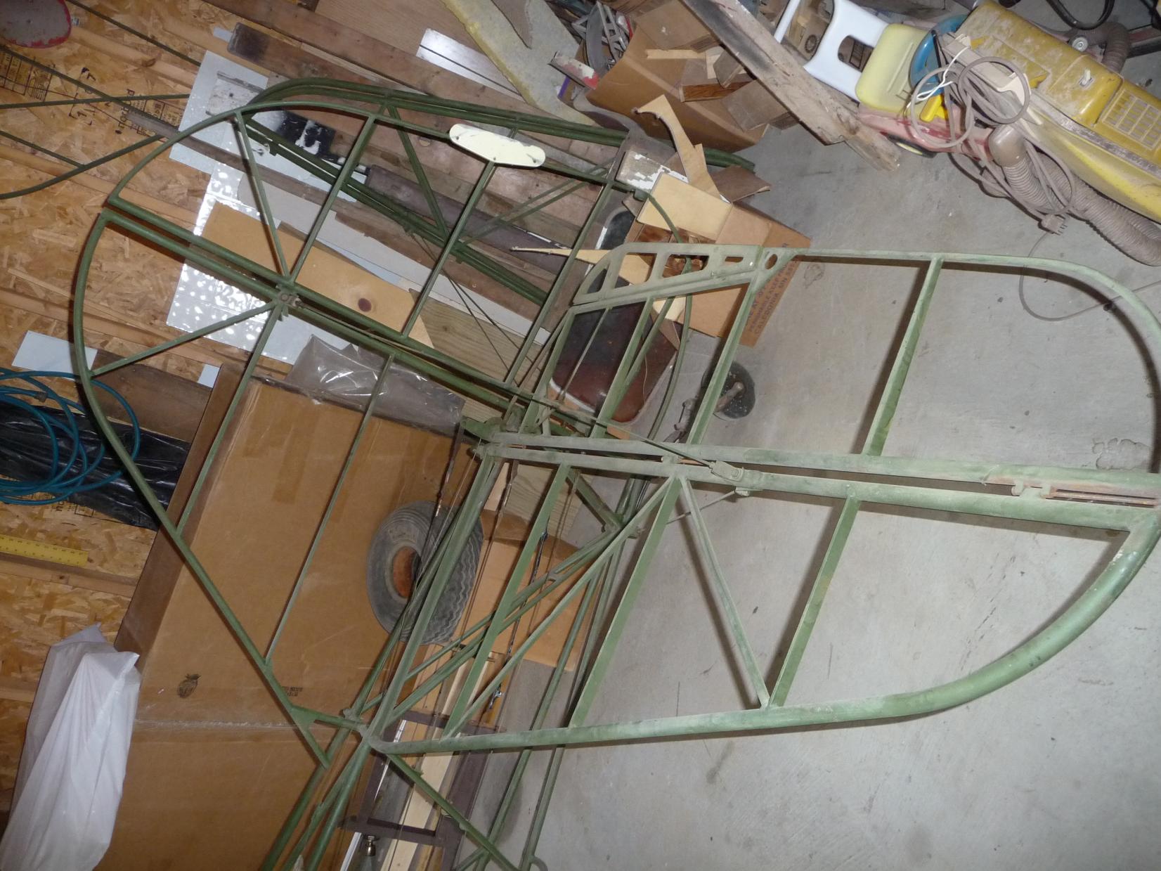

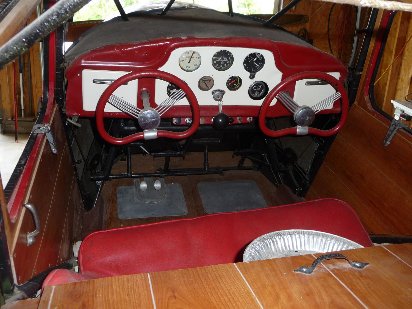

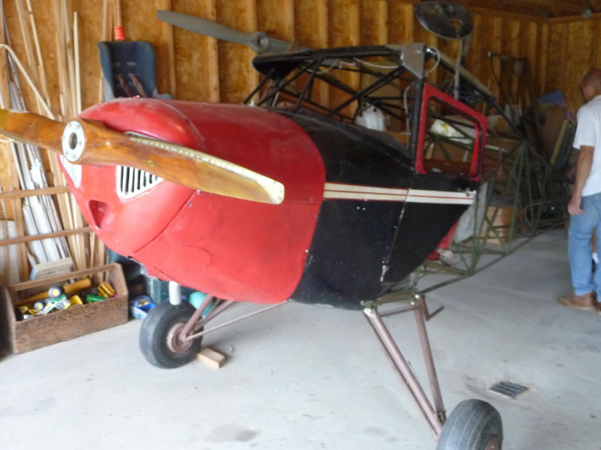

                    Hi Kim,

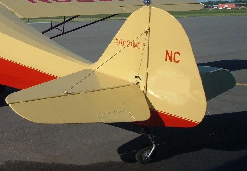

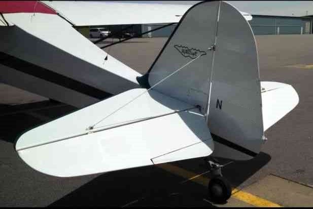

                    Congratulations on having a '41 Deluxe! These are fairly uncommon and desirable, especially if it retains all of the Deluxe features. Looks like your panel, yokes, wooden doors are correct. Do you have the cast nose bowl grills and stainless cowl trim pieces? Check your wings for 15 ribs for the 1200lb gw. Earlier airplanes under 1200 had 13 rib wings, I've seen them get mixed up before. Also, your tail feathers have been changed to "D" model tandem (and post-war BC-12D, hence the "D" in the model designation) two-hinge type. It would have originally had three-hinge feathers. The horizontal stabs and elevators are the same shape, but I think the attach holes are 90* different between the types, and trim tab is different. The big difference is the vertical fin and rudder is shorter with a wider chord on the pre-war three-hinge, and taller, narrower chord on the "D" two-hinge type. I also think the bracing wire fittings are different, and you can't mix two- and three- hinge parts due to the wire lengths being different. I have seen pre-war B airplanes with "D" tails and post-war BC-12Ds with pre-war tails. 98% of people, including A&P/AI will never know the difference, but its technically not correct. If you want a fly in your ointment, I'd suggest looking to trade your "D" tail for a three-hinge pre-war set before you start fabric, especially being you've got a Deluxe. I think the early tail is much nicer and more graceful than the "D", just my $.02. Good luck, more pics as you progress! And ask any other questions you come up with.
                    NC39244 '45 BC12-D S/N 6498
                      Re: Fuselage tubing - what brand expoxy primer after blasting?
                      Yes, I agree with almost all of what Dave has said. My 45 Deluxe does have the wood doors, cast cowl trim and side SS trim as well as the 15 rib wings with the old “stick “T” ribs. They also had the MUCH BETTER welded aileron hinge and bellcrank fitttings (the cast ones are JUNK). My trim tab is also the 41 elevator tab that does not go all the way to the root end. From what I could find the 41 Deluxe (the correct spelling from Taylorcraft for the Deluxe by the way) planes were also some of the early planes they experimented with for other subtle changes. I have some really old photos somewhere showing both 2 and 3 hinge elevators. From what I could find out they had some early problems keeping the 3 hinges ones aligned and some would bind so you could find either 3 or 2 hinges on a 41 Deluxe (can’t find the pictures so that is my best memory). The real way to tell is the length of the tail wires. A 41 will always have the pre-war lengths no matter what the hinge numbers are (I can measure mine if you need the differences. I have a 40 with LOTS of 46 parts, an original 41 and an original 45). My 41 Deluxe is one with three hinges on both sides with the 41 fin and rudder. The pre-war planes also had more AREA to the rudder which slightly changes the handling. In a small rudder plane (a 46 or later) in a hard slip you can hold full rudder and you won’t quite use all of the aileron throw. In an early plane you run out of aileron throw first and can adjust with the rudder. I have uncovered pre and post war rudders (only my 41 is flying) and get you any dimensions you need). It would not be all that hard to MAKE pre-war tails from a post war but you will need a good hunk of steel to line bore the hinge fixture to make sure the hinges don’t bind. I also have side trim pieces and hope to make new ones from composite since they have been known to get blown off!
                      Another major feature of the 41 Deluxe is the control wheel and wheel pants. There were two different wheels available on the 41 Deluxe but the Banjo was the most common and looked the best. REALLY classy but hard to find now. Late in production they ran out of them and used the open tube wheel. I have both if you need to make a set (not NEARLY as easy as making pre war tails!). On the pants, I have them but don’t actually fly with them. The fittings were originally cast aluminum and cracked. When I bought my plane it had welded fittings that were UGLY and I got tired of getting all the grass and mud out of the pants. I have a set of aluminum and glass copies if anyone wants to make molds. I also designed steel fittings with glass overlays that look like the cast ones but won’t crack…..just never got around to making them. Like the cast aileron fittings, I don’t fly with cast flight or gear parts. Castings are for parts you don’t mind falling off your plane.
                      Just my opinions, ;-)

                          Thanks to Dave and Hank on info on this particular model.
                          What you see in the pics is pretty much what we got. We have acquired (for free) a set of dissasembled wings, though no attempt has been made to id what year they are from.
                            Post a photo of the parts and we will be able to ID many of the parts and what year they are (OK, what series maybe, but actual YEAR will be harder).
