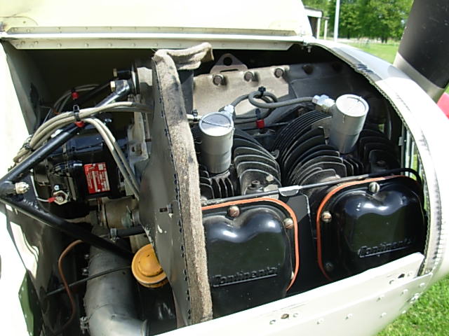

        I made my own recently out of aluminum. It was my first attempt to form aluminum. I kind of chronicled my attempts on my registry page in this forum. See link below.
        Registry of Members Taylorcraft Airplanes. please post only about yours, Replys and comments will be deleted.
        I'm totally happy with the results. I prefer the Aluminum ones much more than the plastic ones that I had previously.

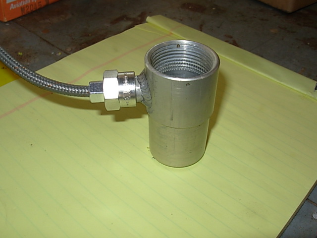

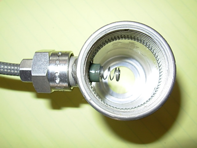

                      Here are some Erocoupe Cup photos. The Cotter Key is easier to do than the safety wire and works just as well.
